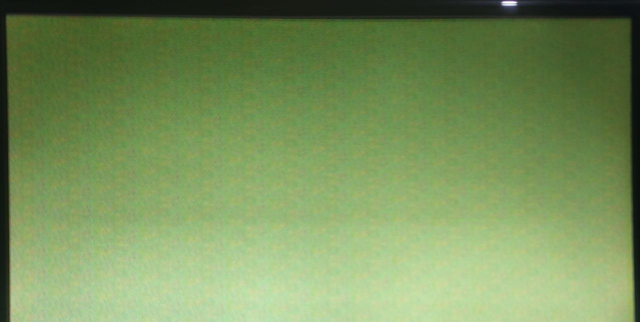

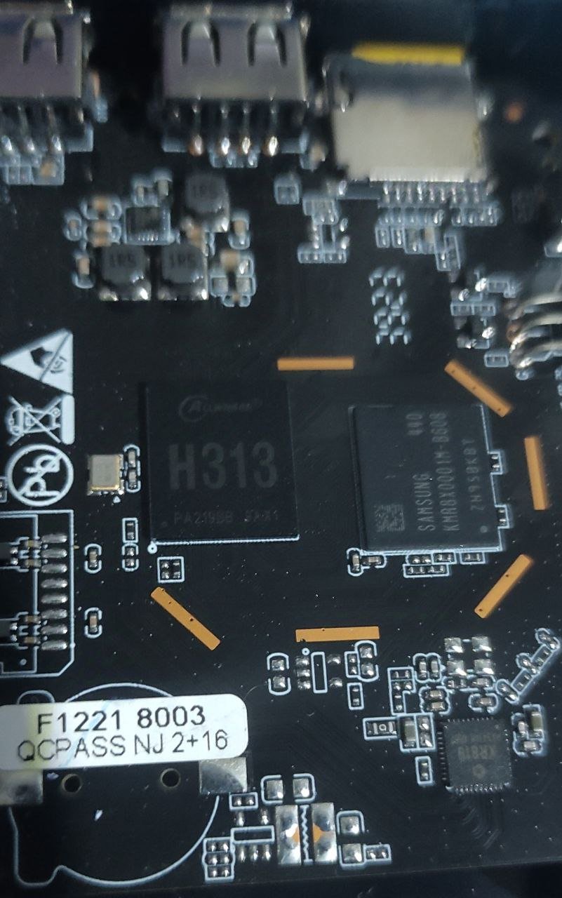

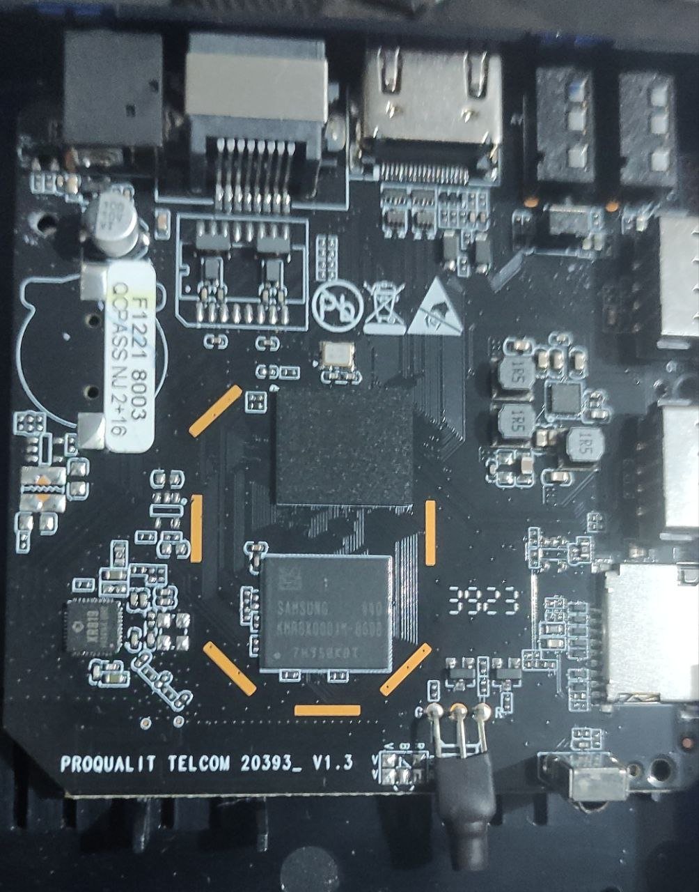

  4. Hi! Firstly thanks put work in this box! I've a X96Q Brazilian clone named PROSB-3000, it's almost same from comment #200190 It boots D:\MiniArch-20240715-6.10.10-board-h313.x96_q_lpddr3-SD-Image.img... Compiled all links from this topic, always write only "root" partition, without boot partition(in all tests only work with boot and root partitions). In one compiling trying gets "Check MD5 sum of installed packages failed" message, like #203154 comment. So I've tried #202501 method, burned MiniArch, changed files in boot, removed root, restore armbi_root and got screen, but... Glitched splash screen, waited some minutes, nothing happen... Any advice? Images attached.
