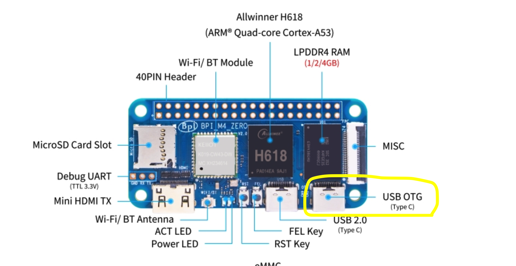

Maybe I am not expressing myself clearly, sorry for that.
(edit -> i just saw you're new overlay -> trying it right now)
I am trying to use the designated PWR / OTG port as a HOST port exactly; this option is called usb0-host with an Orange Pi overlay. I am doing that because I am powering the device from underneath with GPIO. So I want to be able to free both ports to be HOST. The one already designated works fine as intended, but yeah, I want to use the PWR port USB0 as a HOST. I will share u-boot log quite soon.

Sorry for the late follow-up. Initially I thought everything was fine since the overlay compiled successfully, but once I freed the USB0 port (now using an ups hat for power), I ran into an issue.
I created and applied a custom device tree overlay to force USB into host mode (the one you gave me):-----------------------------------------
/dts-v1/;
/plugin/;/ {
fragment@0 {
target = <&usbotg>;
__overlay__ {
dr_mode = "host";
The overlay was compiled and added using armbian-add-overlay, then referenced in /boot/armbianEnv.txt. After rebooting, I confirmed the following:
- /proc/device-tree/soc/.../dr_mode -> shows host for all USB nodes
- Power is delivered to the USB ports (LED indicators on devices turn on)
However, no USB devices are recognized. I also tried to target directly all known USB controller nodes manually with an overlay (usb@5100000, usb@5101000, usb@5200000, etc.) and forced dr_mode = "host" on each of them. All report host under /proc/device-tree, but:
- lsusb lists only the root hubs
- No new logs appear in dmesg when plugging in keyboards or mice (usb0)
- Devices are never recognized or enumerated
So the overlay seems to apply correctly (the peripheral mode is gone), but the USB controller is still non-functional in host mode.
Any ideas or suggestions for further debugging ? I am new with all this stuff an I appreciate the help a lot.
Thanks !

Hi,
Board: BPI‑M4 Zero
OS: Armbian (Bookworm), kernel 6.12.35 (current)This board has two USB‑C ports: one fixed HOST and one OTG. I’d like the OTG port (USB0) to operate as a host as well. I can’t find any Armbian overlay in armbian-config or on the forums that flips USB0 to host.
If anyone has this working, it would be cool to let me know
Thanks!

@c0rnelius
You're the goat !
It works ! I guess that by activating the two physical USB host controllers with status = "okay", the kernel properly loads the drivers and allows USB devices to function as expected.
Learned something new.
