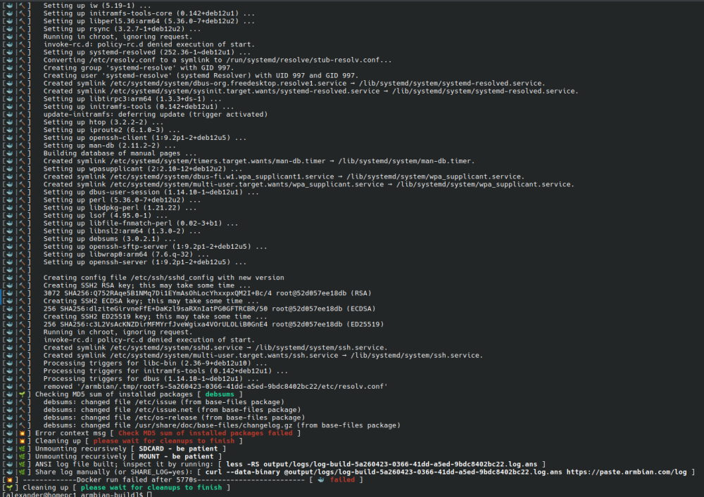

Alexander Zavaruev Posted April 21, 2025 Posted April 21, 2025 It is not compiling, even server minimal( 0 Quote
Alexander Zavaruev Posted April 21, 2025 Posted April 21, 2025 The logs, not helpful for me( Archive.tar.gz 0 Quote
Nick A Posted April 22, 2025 Posted April 22, 2025 https://github.com/NickAlilovic/build/commit/330b0609efe49a8cf339a0a8aff9be65b910641e 0 Quote
Alexander Zavaruev Posted April 22, 2025 Posted April 22, 2025 The build is working, thank you so much! 0 Quote
