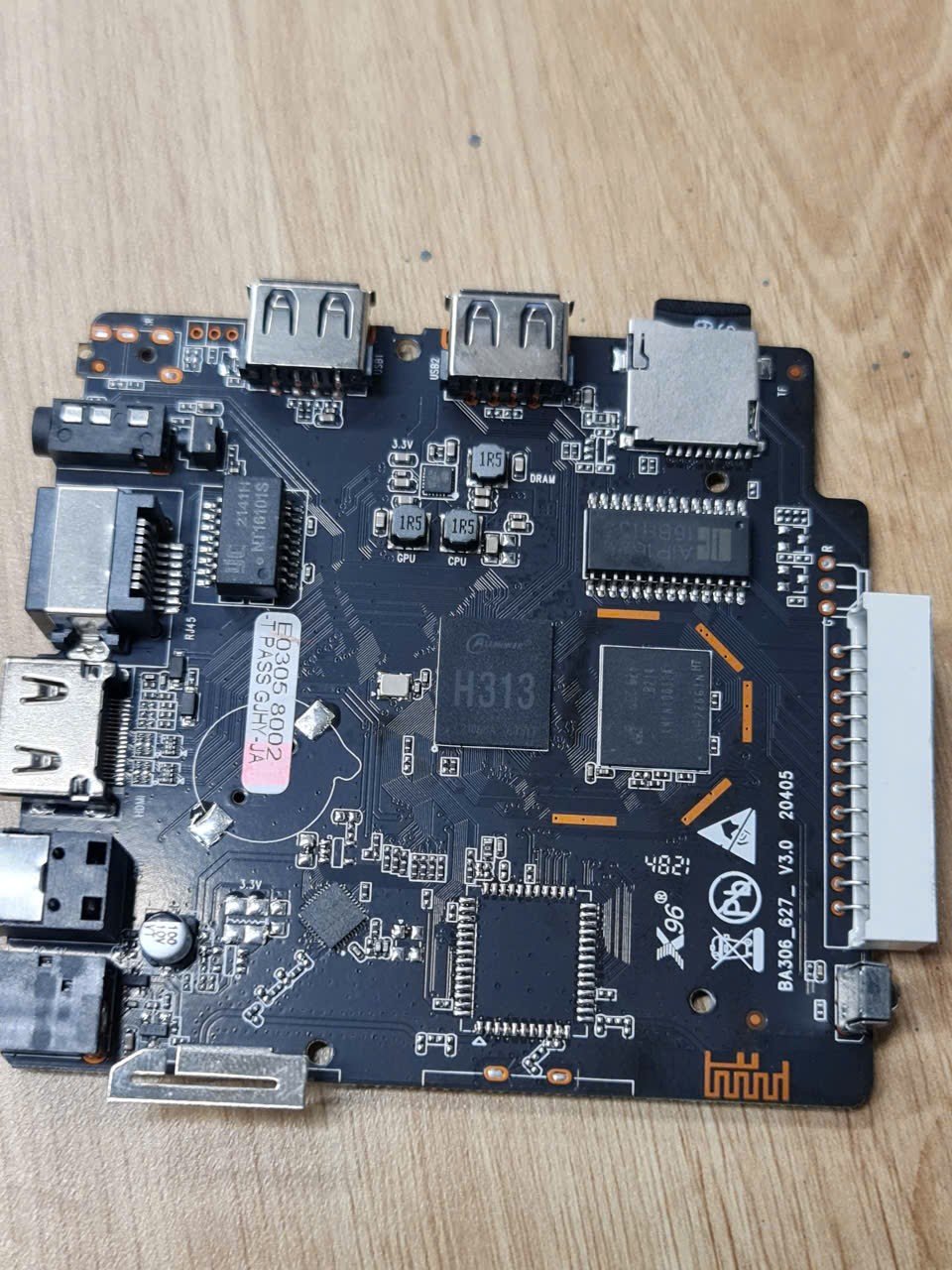

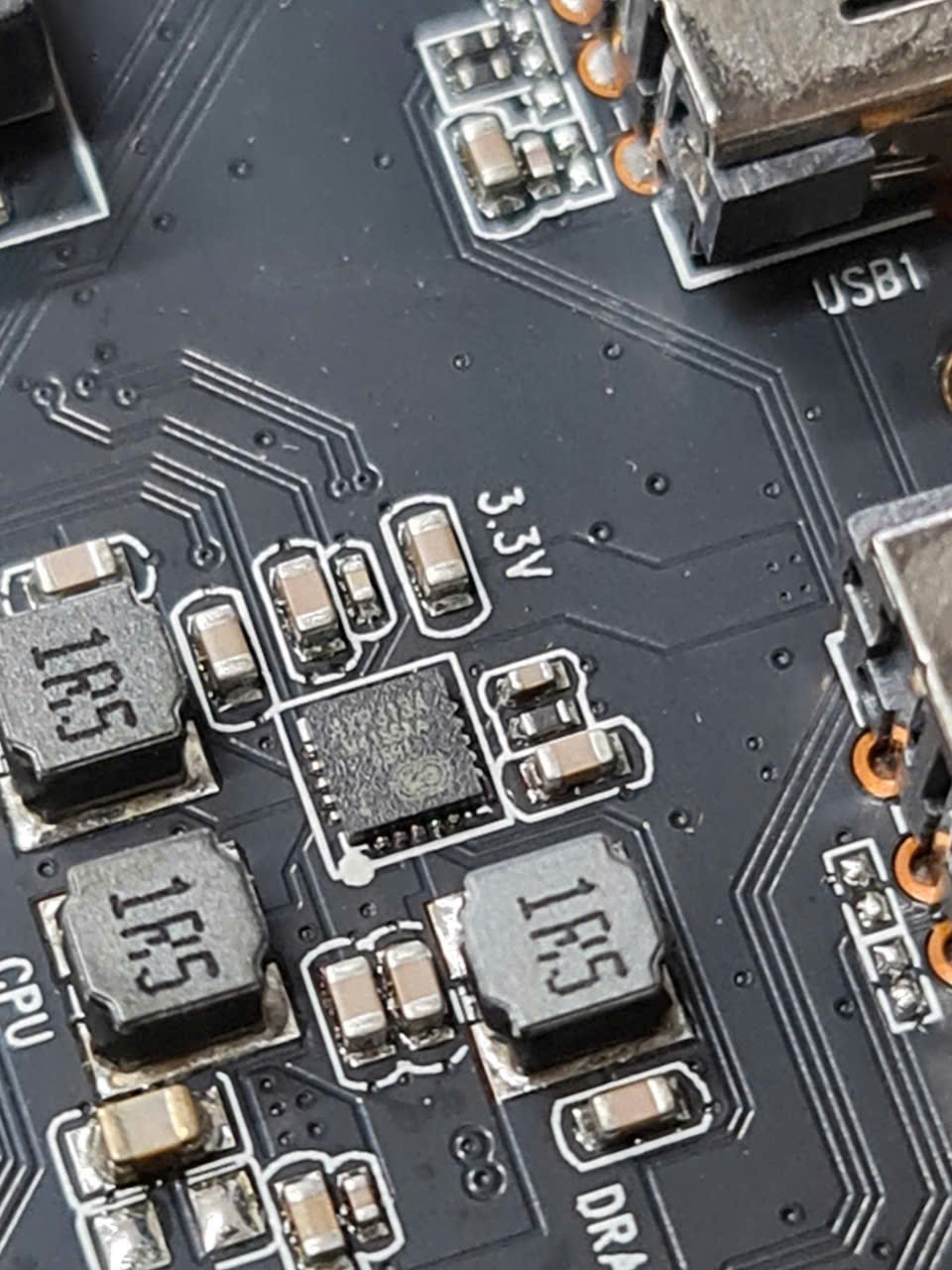

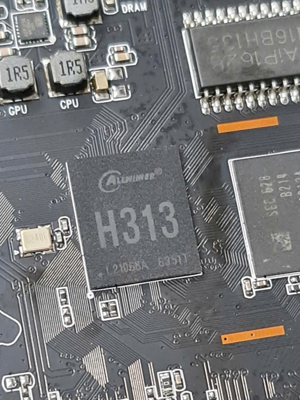

Hiến Dương Posted August 9, 2025 Posted August 9, 2025 Hi everyone. This is my X96-Q mainboard running H313 and AXP313A. I'm new, I want to install Armbian light server version to run embedded linux (Just need network port, wifi, usb) which version can I use? And how to install on emmc? Thanks everyone! 0 Quote
