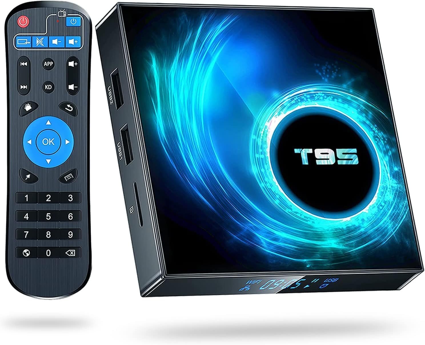

zcrself Posted November 23, 2024 Author Posted November 23, 2024 (edited) @rafman I flash the firmware of T95 into my h616 tvbox. It does be successful. but my tvbos can't boot, I am confused about this。 The successful flashing log is attached t95-rom-to-h616.txt Edited November 23, 2024 by zcrself 0 Quote
rafman Posted November 24, 2024 Posted November 24, 2024 On 11/23/2024 at 9:41 AM, zcrself said: I flash the firmware of T95 into my h616 tvbox. It does be successful. but my tvbos can't boot, I am confused about this。 The successful flashing log is attached Flashing may succeeds but if you don't have serial output at all, this means that the image you flashing is not compatible with your device. FYI: There is a version of TRANSPEED 6k (with H616) you can test 3 different firmware. you can find it here : https://repairalltv.com/transpeed-6k-tv-box-android-10-0-firmware-download-allwinner-h616/ Always Check if you have serial output. 0 Quote
