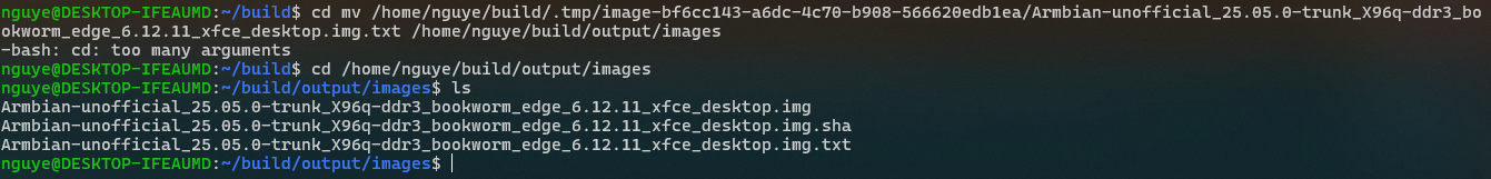

Ducdanh Nguyen Posted August 30, 2025 Author Posted August 30, 2025 (edited) @Nick A full log (failed): [💲|🌱] Starting main configuration [💲|🌱] Using REVISION from [ main VERSION file: '25.05.0-trunk' ] [💲|🌿] Enabling extension [ armbian-config ] [💲|🌱] Sourcing family configuration [ /home/nguye/build/config/sources/families/sun50iw9.conf ] [💲|🌿] Enabling extension [ sunxi-tools ] [💲|✅] change-tracking: after sourcing family config [ KERNEL_MAJOR_MINOR='6.12' ] [💲|✅] change-tracking: after sourcing family config [ KERNELBRANCH='tag:v6.12.11' ] [💲|✅] change-tracking: after sourcing family config [ LINUXFAMILY='sunxi64' # (was: 'sun50iw9') ] [💲|✅] change-tracking: after sourcing family config [ KERNELPATCHDIR='archive/warpme-6.12' ] [💲|✅] change-tracking: after sourcing family config [ BOOTBRANCH='tag:v2025.01' ] [💲|✅] change-tracking: after sourcing family config [ BOOTPATCHDIR='u-boot-h616' ] [💲|✅] change-tracking: after sourcing family config [ ATFBRANCH='tag:lts-v2.10.14' ] [💲|✅] change-tracking: after sourcing family config [ NETWORKING_STACK='network-manager' ] [💲|🌱] Sourcing arch configuration [ arm64.conf ] [💲|✅] change-tracking: after sourcing arm64 arch [ ATFDIR='arm-trusted-firmware' ] [💲|🌱] Using NETWORKING_STACK [ NETWORKING_STACK: network-manager ] [💲|🌱] Adding networking extensions [ net-network-manager, net-chrony ] [💲|🌿] Enabling extension [ net-network-manager ] [💲|🌿] Enabling extension [ net-chrony ] [💲|🌱] Extension manager [ processed 17 Extension Methods calls and 27 Extension Method implementations ] [💲|🌱] x96q-lpddr3 [ Using allwinner/sun50i-h313-x96-q-lpddr3.dtb for edge ] [💲|💥] Error 1 occurred in SUBSHELL [ SUBSHELL at /home/nguye/build/lib/functions/configuration/config-desktop.sh:48 ] [💲|💥] Cleaning up [ please wait for cleanups to finish ] [💲|🌿] ANSI log file built; inspect it by running: [ less -RS output/logs/log-build-5e1956f5-4bb3-4cdf-b026-7bcfa7d1794e.log.ans ] [💲|🌱] Share log manually: [ use one of the commands below (or add SHARE_LOG=yes next time!) ] [💲|🌿] Share log manually: [ curl --data-binary @output/logs/log-build-5e1956f5-4bb3-4cdf-b026-7bcfa7d1794e.log.ans https://paste.armbian.com/log ] [💲|🌿] Share log manually: [ curl --data-binary @output/logs/log-build-5e1956f5-4bb3-4cdf-b026-7bcfa7d1794e.log.ans https://paste.armbian.de/log ] [💲|🌿] Share log manually: [ curl --data-binary @output/logs/log-build-5e1956f5-4bb3-4cdf-b026-7bcfa7d1794e.log.ans https://paste.next.armbian.com/log ] [💲|🌿] Share log manually: [ curl --data-binary @output/logs/log-build-5e1956f5-4bb3-4cdf-b026-7bcfa7d1794e.log.ans https://paste.armbian.eu/log ] nguye@DESKTOP-IFEAUMD:~/build$ EDIT: it continued while i tried Debian 12 Next i choosed xfce config_base (onlyone) internet Edited August 30, 2025 by Ducdanh Nguyen 0 Quote
Ducdanh Nguyen Posted August 30, 2025 Author Posted August 30, 2025 (edited) @Nick A success build log : https://paste.armbian.eu/simirepihe Edited August 30, 2025 by Ducdanh Nguyen 0 Quote
Ducdanh Nguyen Posted August 30, 2025 Author Posted August 30, 2025 @Nick A i flashed it to my card and it's not booting to armbian... 0 Quote
