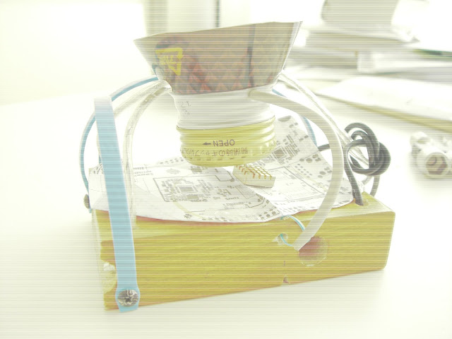

of course
in japan , 10 yen coin ( about $0.1) is made by copper and is the cheapest material.
the best is silver coin .
are there coins made by copper in USA ?
and acryl plate is easily holed out with metal drill .
alminium cap presses coins against heat sink and so fixes coins and heat sink .
i use
i am suprising your vast knowlege .
i only follow 'Install Cross Compiler' of
http://wiki.friendlyarm.com/wiki/index.php/NanoPi_M3#Boot_NanoPi_M3_from_SD_Cardi use 64bit CPU and 64bit debiandog .
i finally underastand that nano pi M3 is 64bit hardware but the present OS is 32 bit .
surely nano pi M3 becomes hot and hot and suddenly reboot .
so i made the device which misses heat .
now there is no rebooting .Because it doesn't work easily, it's fascinating.
