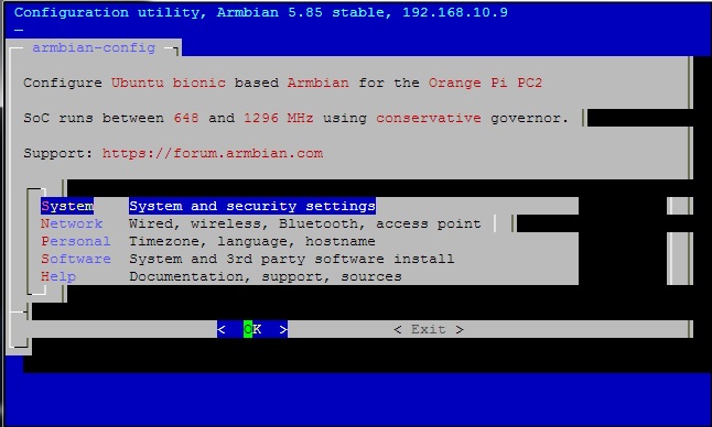

Hi,
have anybody idea what can cause this garbage layout in armbian-config ? It works fine but seems after install some things (I cannot tell what exact, I not use armbian-config often) I get this:
(similar garbage menus I have in config tool used in oscam source)
Thanks for any help
/Tomi
UPDATE: I connect monitor via HDMI and on monitor it looks perfectly, then seems this is problem of ssh/putty...but where?
Found a reason, maybe it help to someone:
in Putty config : 'Connection > Data > 'Terminal-type string' write 'putty' instead of 'xterm'
I not have idea how this was changed in my case but if fix that.
/Tomi
