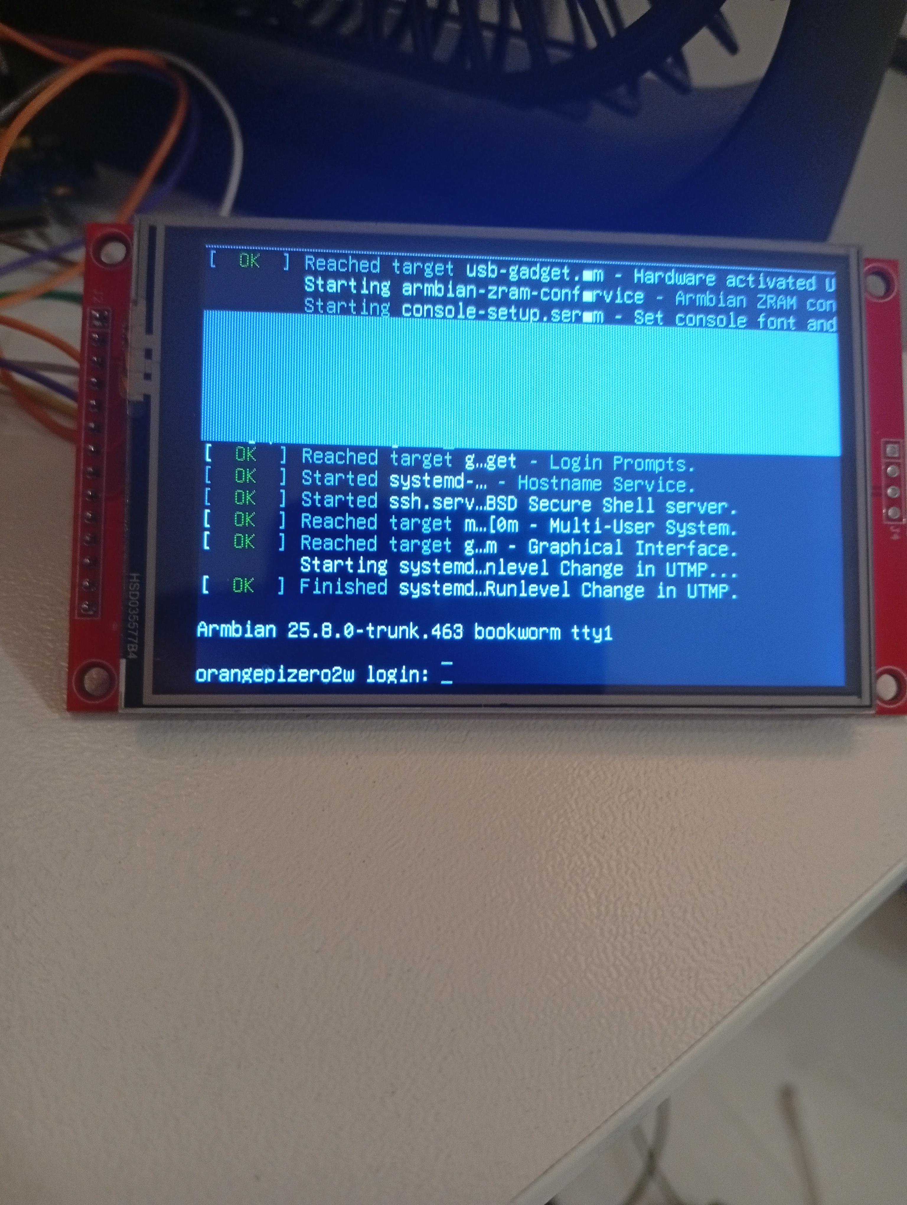

its an ili9488 3.5" cheap red SPI display, pretty much right after posting the comment i got it to output a garbled image, i did change the pins to match my pin connections. i was running orange pi branded debian, doing stuff on armbian doesn't work for some reason, im going to try to compile it myself. i completely removed touch from the DTS because i dont really need it. i am on orange pi zero 2w btw. for some reason i cant upload an image
Posted
hello again, i searched around and pretty much everything links back to this thread. this is the best result i could get on latest armbian, does anyone know what i can change? i think the problem is that the image is kinda shifted down and then goes back up? im pretty sure i need to change some kind of offset, but other than that im stumped
Posted (edited)
Try a lower SPI frequency and use direct wires from the orange pi zero 2w to the LCD
There might be something in the panel-mipi-dbi-spi.bin firmware to improve the display of the received bytes, but first do these two improvements (first try the direct wires)

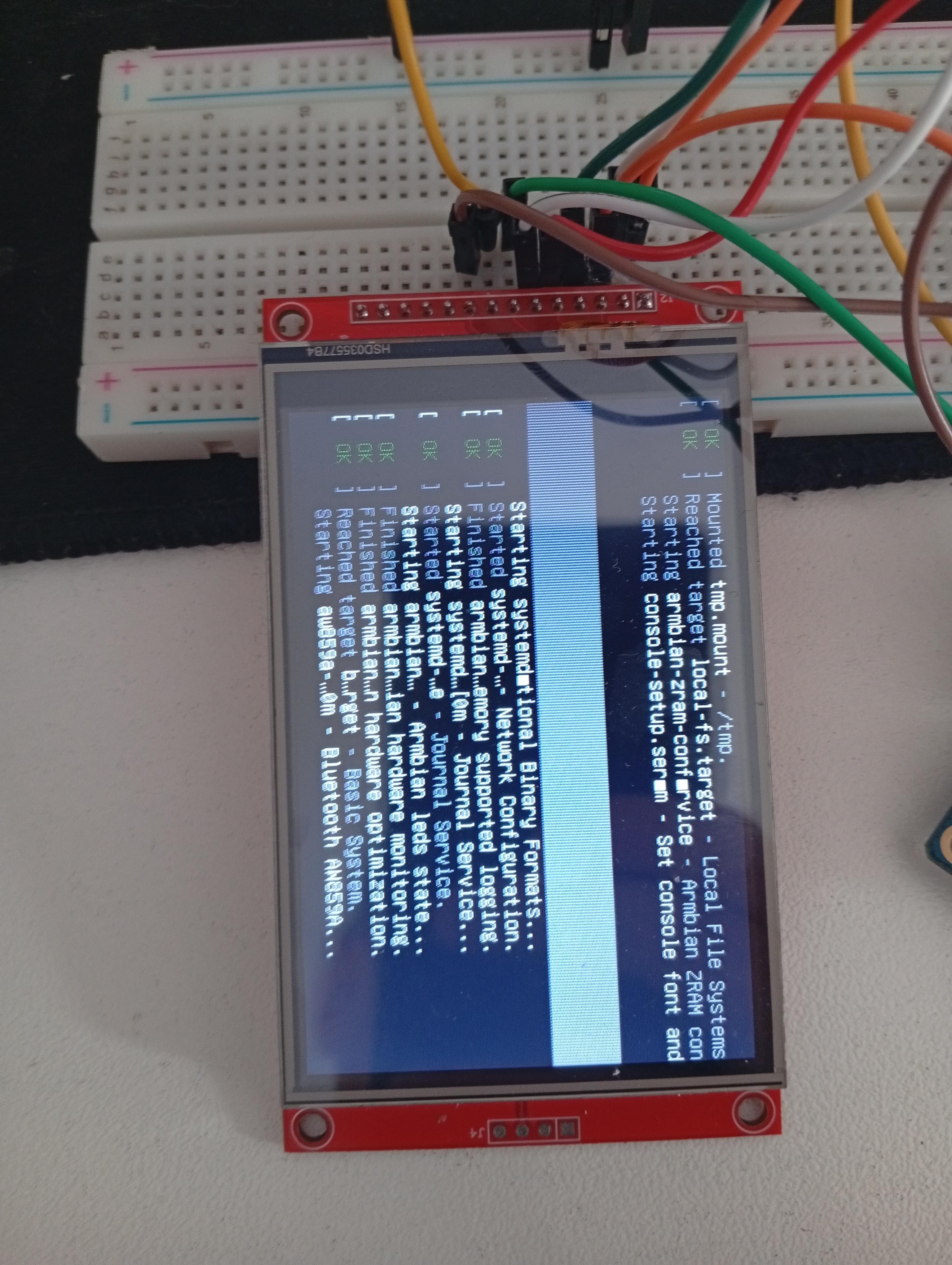

Posted (edited)
thanks! direct wiring has definitely changed something, i guess ill keep changing stuff and update if i get something
upd: the direct wiring has definitely made an improvement, but it still looks offset, i have no idea how to fix this, changing stuff in panel-timing just.. does stuff randomly, and i have no idea how to pick the right one. does anyone know the solution to this kind of weirdness?
this is the best i could get it:

Posted (edited)
post the link of the online store where you bought your LCD.
Why do you describe your problem as "offset", if your problem is a big rectangle that covers 25% of your screen?

Posted
now that i think of it, i think you're right; the data being displayed is not offset its just straight up not displayed in some regions and wraps around for some reason. i bought the display here. its very likely resold from aliexpress.

I am glad that you have the first 15% done: get your kernel module in the OS, and the uboot accepting the DTBO
Now you are stuck in correcting the DTS, so that it configures the SPI pins correctly.
My last advice for you (through this stage) is: make sure you don't have anything else using SPI pins. Deactivate "spi_dev" in armbian-config.
Since I only had experience with H3 and H618 CPUs, I can't help with confidence. Post your question in the appropriate Rockchip forum section for up-to-date reliable advice.
I can say that Radxa/Waveshare DTS is very out of date: it uses the fb_ili9486, which is "framebuffer" (poor fps), instead of the modern "DRM" display driver (high fps, will allow wayland).
You should stay with that DTS with fb_ili9486, because it is still the closest starting point for you, and when you have it working, claiming all the GPIO pins needed, I can help again to use the DRM driver panel-mipi-dbi.
Regarding MISO and MOSI, I only meant to change that nomenclature in the graphic that you show in the forum.
I did't mean to change it in the DTS, if that's how other people make it work.
Maybe you need to have the full linux source, so you can decompile the DTBO correctly, showing the gpio pin addresses or symbols. Is it possible that you get the Radxa/Waveshare original DTS?
Edited by robertoj

I went out and bought a waveshare clone 3.5 inch display, to try and confirm I haven't spent the last few weeks trying to do the impossible with broken GPIO pins or something - and got a partial success eventually, using fbtft, displaying basic console and plymouth boot logs. It has poor fps like you said - which I expected, its the reason I tried to use the tiny DRM driver from the beginning, but now I know the rockpi and DTS is functional. The same DTS also shows a broken, purple / blue output of bars on my red ili9488 display only if I adjust the bus width to 16 instead of 8 (0x10, instead of 0x08), otherwise it remains a blank white screen. A bus width of 18 and 24 also only gave me a white screen, so 16 might be correct.
I've been unable to confirm touch works, since I only have a basic console and I can't figure out how to start LXDE on a framebuffer device, but I do see messages insinuating it initializes under dmesg | grep spi. I could probably just query the GPIO interrupt to find out if touch is working. Not that important right now.
Spoiler
/dts-v1/;
	fragment@0 {
		target = <0xffffffff>; /* spi1 */
		__overlay__ {
			status = "okay";
			#address-cells = <0x01>;
			#size-cells = <0x00>;
			ili9486@0 {
				compatible = "fb_ili9486";
				reg = <0x00>; /* CS0 */
				spi-max-frequency = <0xf42400>; /* 16 MHz, try raising */
				txbuflen = <0x8000>; /* 32768 */
				rotate = <0x5a>; /* 90 */
				bgr = <0x00>; /* I have no idea */
				fps = <0x1e>; /* 30 */
				buswidth = <0x08>; /* for red lcd, adjust to 0x10 (16), gibberish output. Try 24, 3, 8, or 9 */
				regwidth = <0x10>; /* 16, try 8 */
				debug = <0x00>;
				reset-gpios = <0xffffffff 0x1d 0x01>; /* gpio4 29 1 */
				dc-gpios = <0xffffffff 0x1c 0x00>; /* gpio4 28 0 */
				phandle = <0x01>; /* unsure, unable to compile without, phandle errors with. still works */
			ads7846@1 {
				compatible = "ti,ads7846";
				status = "okay";
				reg = <0x01>; /* CS1 */
				id = <0x01>;
				spi-max-frequency = <0x1e8480>; /* 2MHz */
				ti,x-plate-ohms = [00 3c];
				ti,pressure-max = [00 ff];
				ti,swap-xy = <0x00>;
				ti,invert-y = <0x01>;
				vcc-supply = <0xffffffff>; /* vcc5v0_sys */
				interrupts = <0x12 0x02>; /* gpio4 18 2 */
				interrupt-parent = <0xffffffff>; /* gpio4 */
				pendown-gpio = <0xffffffff 0x12 0x00>; /* gpio4 18 0 */
				phandle = <0x02>;
	metadata {
		title = "Enable Waveshare 3.5inch RPi LCD (C) on SPI1";
		compatible = "rockchip,rk3399";
		category = "misc";
		exclusive = "GPIO1_B0\0GPIO1_A7\0GPIO1_B1\0GPIO1_B2\0GPIO4_D2\0GPIO4_D4\0GPIO4_D5";
		description = "Enable Waveshare 3.5inch RPi LCD (C) on SPI1.";
	fragment@1 {
		__overlay__ {
			num-cs = <0x02>;
			cs-gpios = <0xffffffff 0x0a 0x00 0xffffffff 0x1a 0x00>; /* gpio1 10 0, gpio4 26 0 */
			pinctrl-names = "default\0high_speed";
			pinctrl-0 = <0xffffffff 0xffffffff 0xffffffff>; /* spi_clk, spi_rx, spi_tx */
	__symbols__ {
		ili9486 = "/fragment@0/__overlay__/ili9486@0";
		ads7846 = "/fragment@0/__overlay__/ads7846@1";
	__fixups__ {
		spi1 = "/fragment@0:target:0\0/fragment@1:target:0";
		gpio4 = "/fragment@0/__overlay__/ili9486@0:reset-gpios:0\0/fragment@0/__overlay__/ili9486@0:dc-gpios:0\0/fragment@0/__overlay__/ads7846@1:interrupt-parent:0\0/fragment@0/__overlay__/ads7846@1:pendown-gpio:0\0/fragment@1/__overlay__:cs-gpios:12";
		vcc5v0_sys = "/fragment@0/__overlay__/ads7846@1:vcc-supply:0";
		gpio1 = "/fragment@1/__overlay__:cs-gpios:0";
		spi1_clk = "/fragment@1/__overlay__:pinctrl-0:0";
		spi1_rx = "/fragment@1/__overlay__:pinctrl-0:4";
		spi1_tx = "/fragment@1/__overlay__:pinctrl-0:8";
I did realize that the big "fixups"  section at the bottom is clearly used to replace the empty 0xfffffff targets throughout. I'm unsure why the DTS was written this way, but it works so I am not going to touch it (changing the targets and switching from hex to decimal values broke the DTS for some reason.)
Unfortunately, a simple drop in replacement of fb_ili9486 with panel_mipi_dbi did not make either display work, even with the added arguments you use in your latest DTS. Clearly I have much more work to do. BUT I've finally confirmed the DTS works, and all GPIO is claimed and SPI is initialized for both displays (even if the red LCD is showing gibberish), so now I need to nail down the subtle differences with the displays like the bus and reg width and find the right combo of spi clock speed, reg bus widths, and buffer length to get it all to work with fbtft (if only aliexpress sellers put up datasheets or example code!). Then I can follow the second half of your journey to hopefully translate a working fbtft setup to a panel_mipi_dbi setup. Maybe get backlight PWM working.
All this still on edge kernel 6.18, on a rockpi 4b plus.
Edited by forumtrekker
Posted
The waveshare clones may not work with panel-mipi-dbi, because these LCDs are not purely SPI.
They have a SPI-to-parallel chip which allows the LCD panel to work in parallel mode.
Maybe they will work, but I don't own any waveshare LCD.
There's a driver inside the kernel for waveshare SPI LCDs (ILI9486_DRM or something like that), but I still haven't seen any example of anyone using it.
