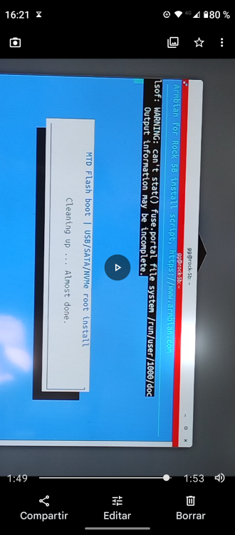

  4. Hello. I have a question regarding the following. I have uboot installed on spi from the legacy image from this thread. Before installing it, delete spi, then boot from sdcard with the legacy image, and run armbian-config.Then try to boot from sd card with ubuntu at the same time having armbian nvme disk in the slot. The problem is that it boots from nvme instead of the sd card. And I would like to be able to boot from sd even though I have nvme in the slot. What am I doing wrong?
  5. burn image to sd and boot from sd; run armbian-config; copy image to nvme and burn spi; reboot without sd. All this is done from armbian -config
