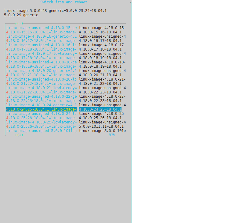

Barakav Posted September 24, 2019 Author Posted September 24, 2019 Thanks for your help! but I downloaded the tool and it seems that the 4.19 source version is still not available, I attached a pic of the versions screen from armbian-config. Is this the screen for choosing the right kernel version to download ? I haven't found any 4.19 version in there. to.bmp
Igor Posted September 24, 2019 Posted September 24, 2019 1 hour ago, Barakav said: but I downloaded the tool and it seems that the 4.19 source version is still not available You downloaded the tool to your desktop PC? No no. That will not work. Use tool on the hardware directly: armbian-config -> software
