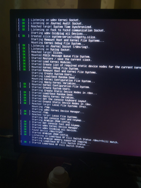

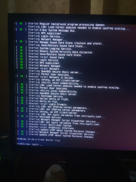

Joel Gómez Posted May 21 Posted May 21 Hi everyone, I have a ZQ01-v1.51 board (a clone of the MXQ Pro 5G—way to go, China!) with an RK3228A chip and Kingston eMCP memory. I’ve tried the Armbian and Educabox images, as well as LibreELEC 10, 11, and 12, and they all have a common issue: the system boots up to the login screen. The screenshots I’m sharing now are from Armbian 23.08.0 Edge 6.5.5 Minimal. The problem is that at a certain point during the boot process, the screen starts flickering, and then when I finally reach the login screen, the image lasts a few seconds before the screen goes black. However, the screen doesn’t turn off—there’s simply no image, the red LED stays lit, and nothing else happens. I don't have an SD card, so I'm using Lubuntu and Rkdeveloptool for flashing. 0 Quote

Vinicius Guastala Posted May 28 Posted May 28 On 5/21/2026 at 10:28 AM, Joel Gómez said: Hi everyone, I have a ZQ01-v1.51 board (a clone of the MXQ Pro 5G—way to go, China!) with an RK3228A chip and Kingston eMCP memory. I’ve tried the Armbian and Educabox images, as well as LibreELEC 10, 11, and 12, and they all have a common issue: the system boots up to the login screen. The screenshots I’m sharing now are from Armbian 23.08.0 Edge 6.5.5 Minimal. The problem is that at a certain point during the boot process, the screen starts flickering, and then when I finally reach the login screen, the image lasts a few seconds before the screen goes black. However, the screen doesn’t turn off—there’s simply no image, the red LED stays lit, and nothing else happens. I don't have an SD card, so I'm using Lubuntu and Rkdeveloptool for flashing. Hello Joel, This seems to be one an known incompatibility with the main Trust OS. There is a experimental image built with an alternative opensource trust OS that might fix this, and it can be downloaded here. Do a test and let us know. PS: Recently OS OP-Tee has been updated to the multitool, and ideally you should test it using a SD Card. BTW: Your screenshot links did not work. BTW2: When the screen goes off can you still connect trough SSH? 0 Quote
