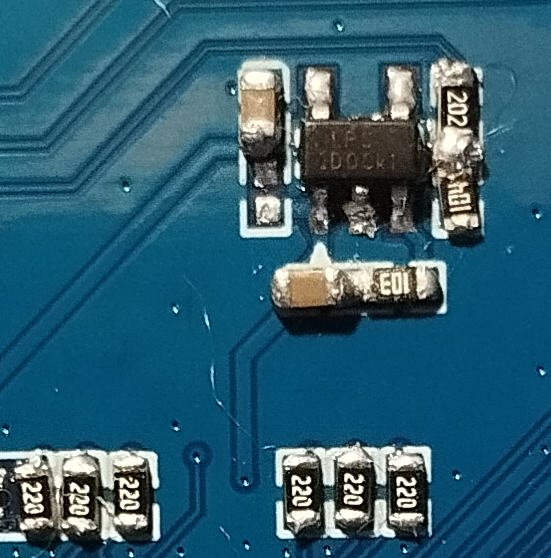

Today my box arrived and I took some photos of it. I'm currently checking the testpoints since I couldn't dump the firmware, but I'll update this comment once I succeed. I'll post a bootlog once available.
Be careful not to damage the WiFi antenna when opening the box.
EDIT 1: Added 3 bootlogs, because I couldn't capture everything at once with Putty.
boot2.txt boot3.txt boot1.txt
Edited by cmuki

Below are actually the testpoints that I used to get the bootlog. Be advised that they are too narrow for a conventional jumper cable, that's why I had to hold them down while booting. I also used one of the screwholes as a GND.
Here's the dump with rkdeveloptool - https://mega.nz/folder/GAo2DToY#b2LLSVPliw2iH6-fvDCcqw
I used the pinenote-backup for automation since I didn't want to do it manually - https://github.com/talpadk/pinenote-backup and it seems it's successful. Can I also create an image from the dump?
Let me know if I did something incorrectly and have to redo it again.
EDIT: Ran rkdeveloptool rl 0 244285440 dump_h96max9.img, added it to the MEGA folder. The device is in Loader mode; also usb 3.0 needs to be used to connect the device to the computer.
Edited by cmuki
