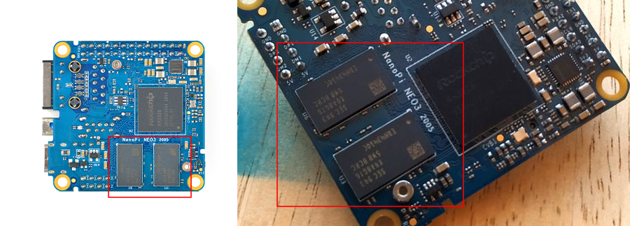

RockChipper Posted February 24, 2025 Posted February 24, 2025 (edited) Nanopi Neo 3 is typically offered in 1GB or 2GB DDR4 RAM versions, but the RK3328 datasheet says the RK3328 can support up to 4GB If I were to source 2x 2GB of the supported types could I resolder to increase RAM? Official product page : https://www.friendlyelec.com/index.php?route=product/product&product_id=279 Quote CPUModel: Rockchip RK3328 Number of Cores: Quad-Core Cortex-A53 64-bit MemoryRAM: 1GB/2GB 32-bit DDR4 RK3328 Datasheet : https://rockchip.fr/RK3328 datasheet V1.2.pdf Quote Dynamic Memory Interface (DDR3/DDR3L/LPDDR3/DDR4) Compatible with JEDEC standards Compatible with DDR3-1866 / DDR3L-1866 / LPDDR3 / DDR4 Support 32-bit data width, 2 ranks (chip selects), max 4GB addressing space perrank; total addressing space is 4GB(max) Neo3 Schematic : https://wiki.friendlyelec.com/wiki/images/a/ae/NanoPi-NEO3-2005-Schematic.pdf could anybody identify the chipname of the 2GB DDR 4 ram on the board? Edited February 25, 2025 by RockChipper 0 Quote
