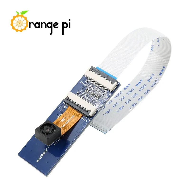

i would like to make videos with a orange pi as basis and would like to start with this camera:
HTB1hqDbLpXXXXXbXpXXq6xXFXXXr.jpg?size=9
which came with my pi. thought it would run out of the box...but it doesnt :(

its been some time and i would happily use any other camera attachable to the csi port...could somebody suggest one that works?

Try this:
Edit: if you can't make it from source, download 5.20 image and check script.bin if twi2 is disabled so the camera module can detect the sensor. There is a thread about this.

youre right, 5.20 works
i can take pictures and make movies, although the movies do not seem to get 30fps.....more like 20 or the camera cant handle recording a hand winking in front of it in kinds of speed...the movements are blurry
What player / program are you using?
Make sure to use a player which uses vdpau for encoding.
(For instance mplayer, but I am not sure if vdpau works with mainline kernel, I only tested an csi cam on legacy)
