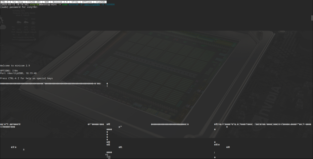

@fabiobassa and @jock, thanks for your quick responses! You are true heroes for this community. The suggested experimental image have not worked for me unfortunately. Same behavior, no Video and no Leds. However, a little progress on the UART search... Connecting my RX adapter pin to the SD Card 4th pin gave me the biggest console output so far, even though its just garbage, I see it as a little progress... Please see the attachment. Also, I think I was able to identify that the Samsung chip is a 1gb/8GB one from the "rkdeveloptool rfi" command... see it below with some more output from the rkdeveloptooll... [2025-05-12 18:49:03] viny182@desktop-mint ~> sudo rkdeveloptool list DevNo=1 Vid=0x2207,Pid=0x320b,LocationID=302 Loader [2025-05-12 18:49:17] viny182@desktop-mint ~> sudo rkdeveloptool list-partitions Not found any partition table! [2025-05-12 18:49:46] viny182@desktop-mint ~ [1]> sudo rkdeveloptool test-device Test Device OK. [2025-05-12 18:49:58] viny182@desktop-mint ~> sudo rkdeveloptool rfi Flash Info: Manufacturer: SAMSUNG, value=00 Flash Size: 7456 MB Flash Size: 15269888 Sectors Block Size: 512 KB Page Size: 2 KB ECC Bits: 0 Access Time: 40 Flash CS: Flash<0> [2025-05-12 18:50:19] viny182@desktop-mint ~> sudo rkdeveloptool read-flash-id Flash ID: 45 4D 4D 43 20 [2025-05-12 18:50:26] viny182@desktop-mint ~> sudo rkdeveloptool read-chip-info Chip Info: 41 32 32 33 0 0 0 0 0 0 0 0 0 0 0 0 [2025-05-12 18:50:41] viny182@desktop-mint ~> sudo rkdeveloptool read-capability Reading capabilities failed -

@Vinicius Guastala I agree with @fabiobassa, thanks for the very detailed post of your board and broad description of the behaviour. I would suggest you to erase the internal flash and try to boot from sdcard with this armbian image. It is an "experimental" image with opensource Trust OS; many recent boards are having issues with proprietary trust os, possibly yours has similar issues, so you could give a shot to this. By the way, the serial log output would be indeed very handy if you have the chance to find the serial port. Beware also that armbian (and multitool) use 115200bps baud rate for the serial, while proprietary software uses 1.5Mbps baud rate!

@Vinicius Guastala first of all thank you for so much detailled infos and your efforts to find any relevant pin on your board. Yes china manufacturers are well known to use the first avaible chip they have unused on desk so I am not at all surprised to have this frankstein model of a 322x Unfortunately I don't own such board, so really at the moment I have few clues to point you on the right direction. Mine are generic considerations: 1) no separate chips apart from cpu, just one big big chip = ECMP usually 8 giga rom, 1 giga ram ( good for you if it is 16/2 but i doubt) 2) to me looks more interesting the FGHI part for uart, REMEMBER that uart speed is 1500000 ( yes!!!!! one million 500000) but follow the tracks for any missing resistor/missing short that stop the uart signal from CPU to pads 3) if you have a radio-aficionado or a tv technician that owns an oscilloscope finding the uart pads will be easier Sorry if I am not any further useful for your case, cannot buy every single new board that comes out on market, but if for you is important feel free to send me one sample for study and development EDIT : I just remebered that if you are lucky because not all boards have enabled. you'll find a uart on the sd card reader, starting from most right pins and counting 4 . Let me be more clear : two small and two big, from right....on the 4 you will have a uart at 1.500.000 Of course if you put the sd in you will lose this signal, but at least confirm you have any readable character on that pin )

Did you also start screen or minicom on the SBC ? For example: screen /dev/ttyS0 115200 And on PC: screen /dev/ttyUSB0 115200 Make sure you use the same speed on both sides.
