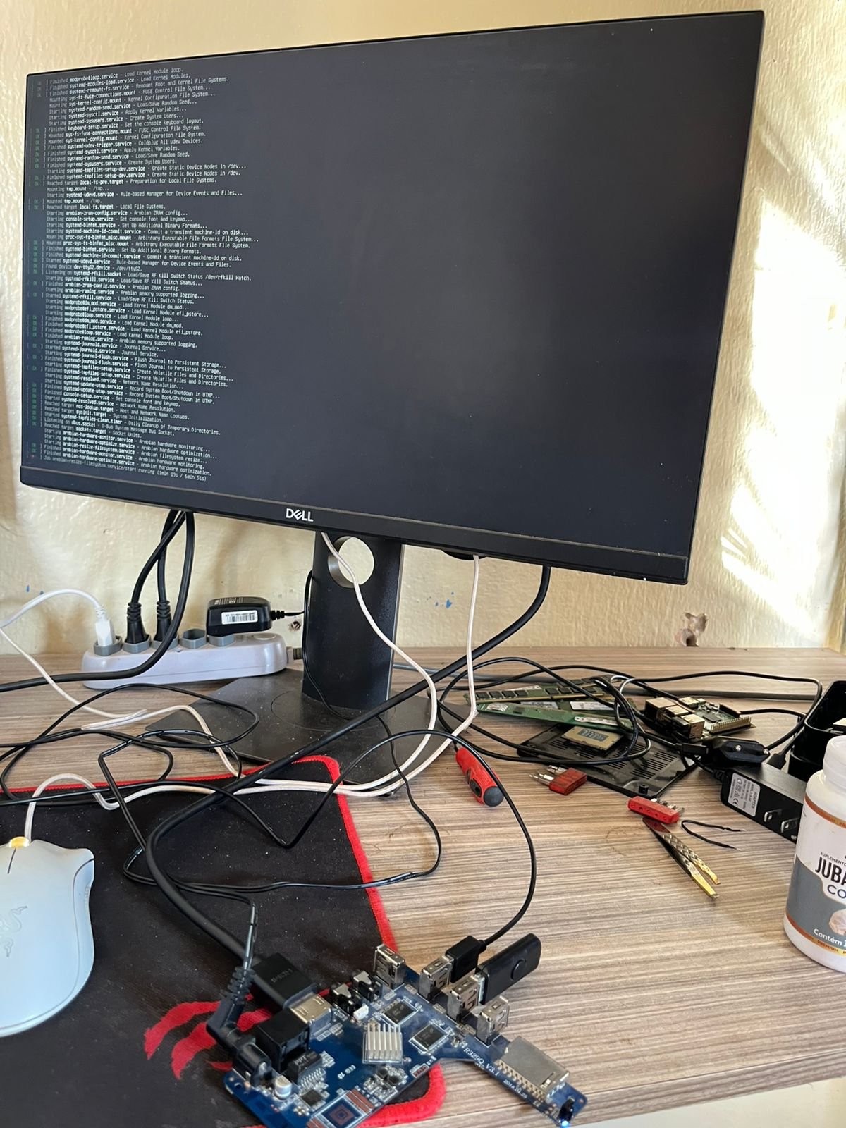

By some miracle of faith, yesterday at the last second before I gave up, I simply put Armbian_24.2.5_Rk322x-box_bookworm_current_6.6.22_minimal.img directly onto the SD card, and incredibly it loaded and I can use everything smoothly on the RK3229 (R329Q_V3.1), including running it on 5.0ghz Wi-Fi... but now the question is, can I put it on the NAND card? If it's not worth it, I'm thinking of leaving it on my SD card, then I'll buy other SD cards for my Raspberry Pi 1 b+ and another TV box I have (I haven't seen the card yet). I'm building a minilab. actually minilab(not working again) A computer with an AMD A4-4000 + 8GB RAM with Proxmox. A Raspy with Dietipi, Pihole, and Adguard. A TVBox-1 for observability (Grafana stack). A TVBox-2 to act as a redundancy node for TVBox-1 and a test server. Speaking directly, I took the image and ran the commands I saw on some postmarketos forums about recording directly via rkdev: rkdeveloptool wl 0x0 rockchip-rk322x-exemple.img

@Virgilio Junior R329Q_V3.1 are known board to be a little "difficult" to manage, but they work and work very well because are ddr3 up to 660 mhz ram speed The big problem is that they are mostly NAND thus support is limited to legacy old images with kernel 4.4.194 and NAND support any newer kernel simply will not boot because of NO NAND DRIVERS I said MOSTLY because lately have shown on the market borads 329 with ecmp and i don't know if yours is this with ecmp would you explain in a more detailled way what you did, please ?
