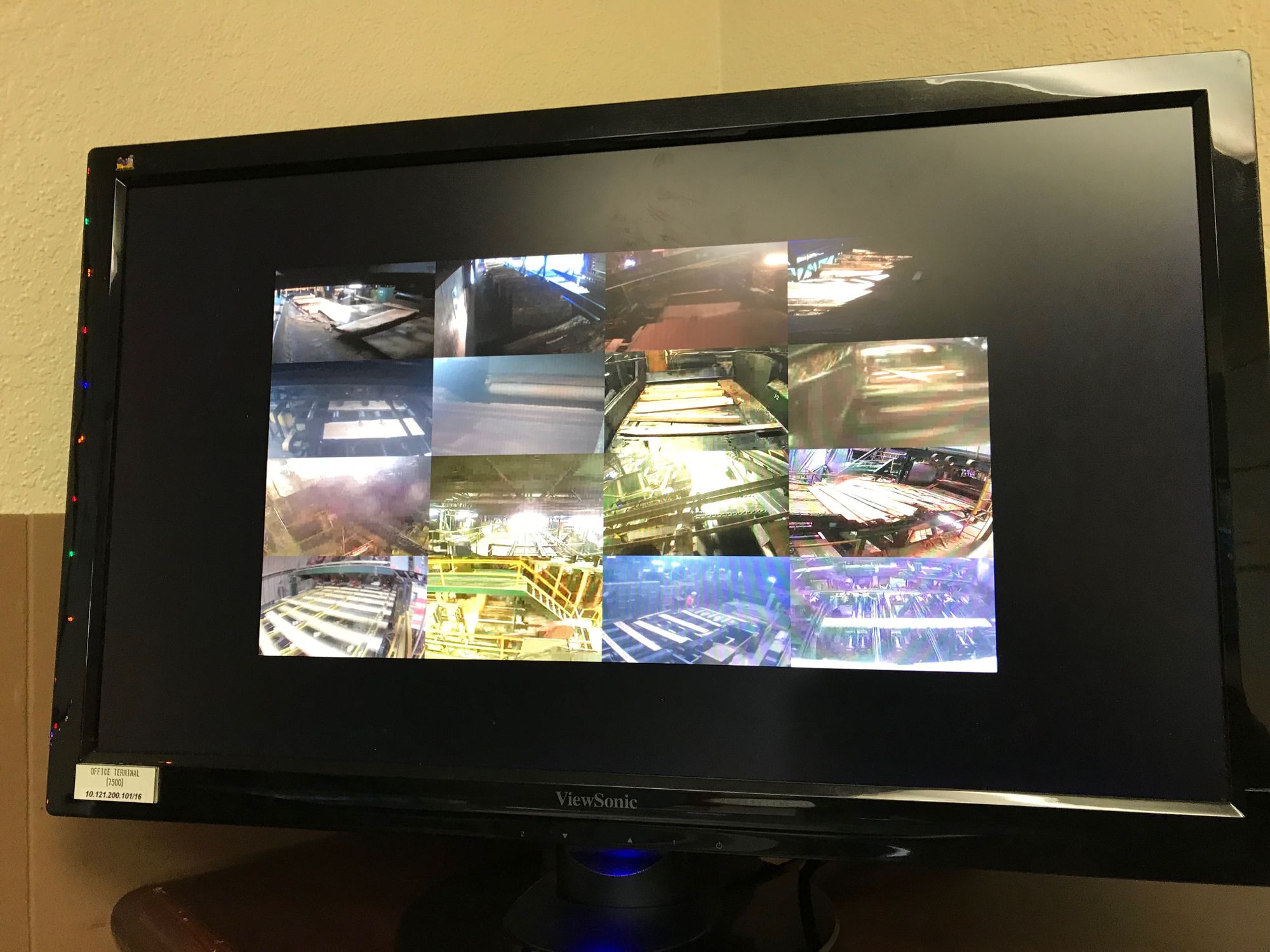

dorin Posted October 30, 2021 Posted October 30, 2021 On 5/29/2020 at 5:57 PM, jock said: mpv: mpv does not require any particular treatment. Can be used directly from X11 in fullscreen mode or from a virtual terminal without X11. Install it if it is not already installed via usual apt command line. Run it with these switches to enable full video acceleration: mpv --hwdec=rkmpp -vo=gpu --gpu-api=opengl --gpu-context=drm --opengl-es=yes <video_file> Thanks, I tried this and it works. Now I am trying to play a couple of video streams simultaneously and display them in a grid. This is possible to achieve with omxplayer (https://github.com/popcornmix/omxplayer) but omxplayer works exclusively on raspberry pi GPU. But I cannot find how to do this with mpv, I had a look on the mpv documentation and the window geometry flags are ignored in gpu mode, and gpu rendering flags are a bit esoteric for me: https://mpv.io/manual/master/#gpu-renderer-options It's actually possible to start multiple mpv processes but since the window is always fullscreen, the image flickers between the sources. Any idea? 0 Quote
jock Posted October 30, 2021 Author Posted October 30, 2021 1 hour ago, dorin said: Thanks, I tried this and it works. Now I am trying to play a couple of video streams simultaneously and display them in a grid. This is possible to achieve with omxplayer (https://github.com/popcornmix/omxplayer) but omxplayer works exclusively on raspberry pi GPU. But I cannot find how to do this with mpv, I had a look on the mpv documentation and the window geometry flags are ignored in gpu mode, and gpu rendering flags are a bit esoteric for me: https://mpv.io/manual/master/#gpu-renderer-options It's actually possible to start multiple mpv processes but since the window is always fullscreen, the image flickers between the sources. Any idea? Uhm, never actually tried to play two videos together on any rockchip box; I don't know the capabilities of rkmpp and what are the available switches and options to handle such situation. With mainline kernel it could be more viable, because it uses drmprime which is the standard and tidy way to render an hardware decoded stream, and uses the regular DRM capabilities. You should be able to get hardware video decoding on mainline kernel with instruction and mpv compiled available in this github post: https://github.com/armbian/build/pull/3152#issuecomment-922757262 The interesting arguments of mpv for you are --drm-draw-plane and --drm-drmprime-video-plane (see documentation here). The former allows you to select which is the plane mpv should use to render the GUI (seek bar, elapsed time, title, volume indications, info, etc...), the latter is the plane used to render the video. A plane is a hardware resource: the SoC provides one, two or more planes. The SoC, also, composes the planes in hardware to render the final output. As an example, when you run X server, the desktop is displayed on primary plane (which is rendered first, so it appears "below"), and videos are displayed on overlay plane (which is rendered next, so it appears "above"). rk322x unfortunately has just three hardware planes: two of them are full-featured planes, the remaining is for hardware cursor. The plane for hardware cursor is always rendered as last plane and is very limited (up to 128x128 pixels). About the two full-featured planes, one is allocated by the kernel as primary, and the other as overlay. Now, what you can try to do is run mpv rendering the first video on primary plane and the second video on the overlay plane. You should find a way to disable the GUI though, because otherwise one mpv instance will get control of both planes, leaving no available planes for the other. Another task is to find a way to tell mpv it has to resize the plane to wanted dimensions: since primary plane is below and overlay is above, if you run both videos fullscreen, the video allocated to primary plane will never be visible because it is always below. Other rockchip SoC are more capable in this sense: rk3328 has three full-featured planes. Bigger SoCs (like rk3288 or rk3399) have even more. Raspberry Pis are peculiar from this point of view. They have an hardware compositor which is capable of handling an arbitrary number of planes. You can create and destroy hardware planes at runtime and even change the z-order of them. The hardware compositor will render all of them until it is hardware limits are reached; after then, the HDMI output will start flickering and the monitor loses synchronization. Usually with raspberry Pi (even the oldest Pi1) you can at least run with two full-hd hardware planes without having issues. Good luck and keep us informed with the progress 0 Quote
dorin Posted October 30, 2021 Posted October 30, 2021 Hmm but it sounds like the rockchip cannot provide a sustainable solution this way. Even if I got a source playing and sized correctly in each plane, I would have a hard limit of 2-3 streams. My goal is to monitor cctv cameras, like the rpi can play 16 streams quite easily (example), which I guess it's possible due to the arbitrary number of hw planes you mentioned. 0 Quote
jock Posted October 30, 2021 Author Posted October 30, 2021 1 hour ago, dorin said: Hmm but it sounds like the rockchip cannot provide a sustainable solution this way. Even if I got a source playing and sized correctly in each plane, I would have a hard limit of 2-3 streams. My goal is to monitor cctv cameras, like the rpi can play 16 streams quite easily (example), which I guess it's possible due to the arbitrary number of hw planes you mentioned. i think you have to find a different solution than connecting hardware video decode to hardware plane directly for such use case. Ideally it should be possible to do hardware decode into a buffer that is then available for OpenGL to blit wherever you wish on your plane, I guess that drmprime is all about this, but you need to ask people with more knowledge than me. Maybe mpv forums can help you and mpv as is does not suit your task. Such job would involve GPU and you should be capable of getting it to work on rk322x too. How well in terms of FPS rk322x would perform is something that has to be discovered later. 16 hardware planes are probably too much for any SBC and, for your particular use case, are not needed. 0 Quote
dorin Posted October 30, 2021 Posted October 30, 2021 (edited) 4 hours ago, jock said: i think you have to find a different solution than connecting hardware video decode to hardware plane directly for such use case. Ideally it should be possible to do hardware decode into a buffer that is then available for OpenGL to blit wherever you wish on your plane, I guess that drmprime is all about this, but you need to ask people with more knowledge than me. Maybe mpv forums can help you and mpv as is does not suit your task. Such job would involve GPU and you should be capable of getting it to work on rk322x too. How well in terms of FPS rk322x would perform is something that has to be discovered later. 16 hardware planes are probably too much for any SBC and, for your particular use case, are not needed. I was able to get a 2x2 grid working in hw accelerated ffmpeg this way: glrun ffmpeg \ -i $CH1 -i $CH2 -i $CH3 -i $CH4 \ -filter_complex \ "[0:v][1:v]hstack=inputs=2[top]; \ [2:v][3:v]hstack=inputs=2[bottom]; \ [top][bottom]vstack=inputs=2[v]" \ -map "[v]" -f matroska - \ | glrun ffplay - (CH1-4 are the video source URI's) While it's faster than non-accelerated ffmpeg (invoked without glrun), it's still way too slow compared to mpv player. To put it into perspective, based on some rought monitoring with htop: ffplay -i $CH1: uses about 340% of CPU (almost maxes out the capacity) glrun ffplay -i $CH1: uses about 140% of CPU mpv $CH1 uses about 300% of CPU mpv --hwdec=rkmpp -vo=gpu --gpu-api=opengl --gpu-context=drm --opengl-es=yes $CH1: uses only about 15% of CPU So obviously mpv has the potential to be much faster than ffmpeg, therefore I tried: # WARNING: this doesn't work mpv --hwdec=rkmpp -vo=gpu --gpu-api=opengl --gpu-context=drm --opengl-es=yes \ $CH1 --external-file=$CH2 --external-file=$CH3 --external-file=$CH4 \ --lavfi-complex='[vid1] [vid2] hstack [t1] ; [vid3] [vid4] hstack [t2] ; [t1] [t2] vstack [vo]' But this doesn't work because the ffmpeg filter used under the hood apparently cannot be accelerated: [ffmpeg] Impossible to convert between the formats supported by the filter 'mpv_src_vid1' and the filter 'auto_scaler_0' [lavfi] failed to configure the filter graph Again, running mpv without hw accel but with --lavfi-complex works, and works slightly faster than ffmpeg but still not satisfactory. I'll have a look on the mpv forums. Edited October 30, 2021 by dorin 0 Quote
