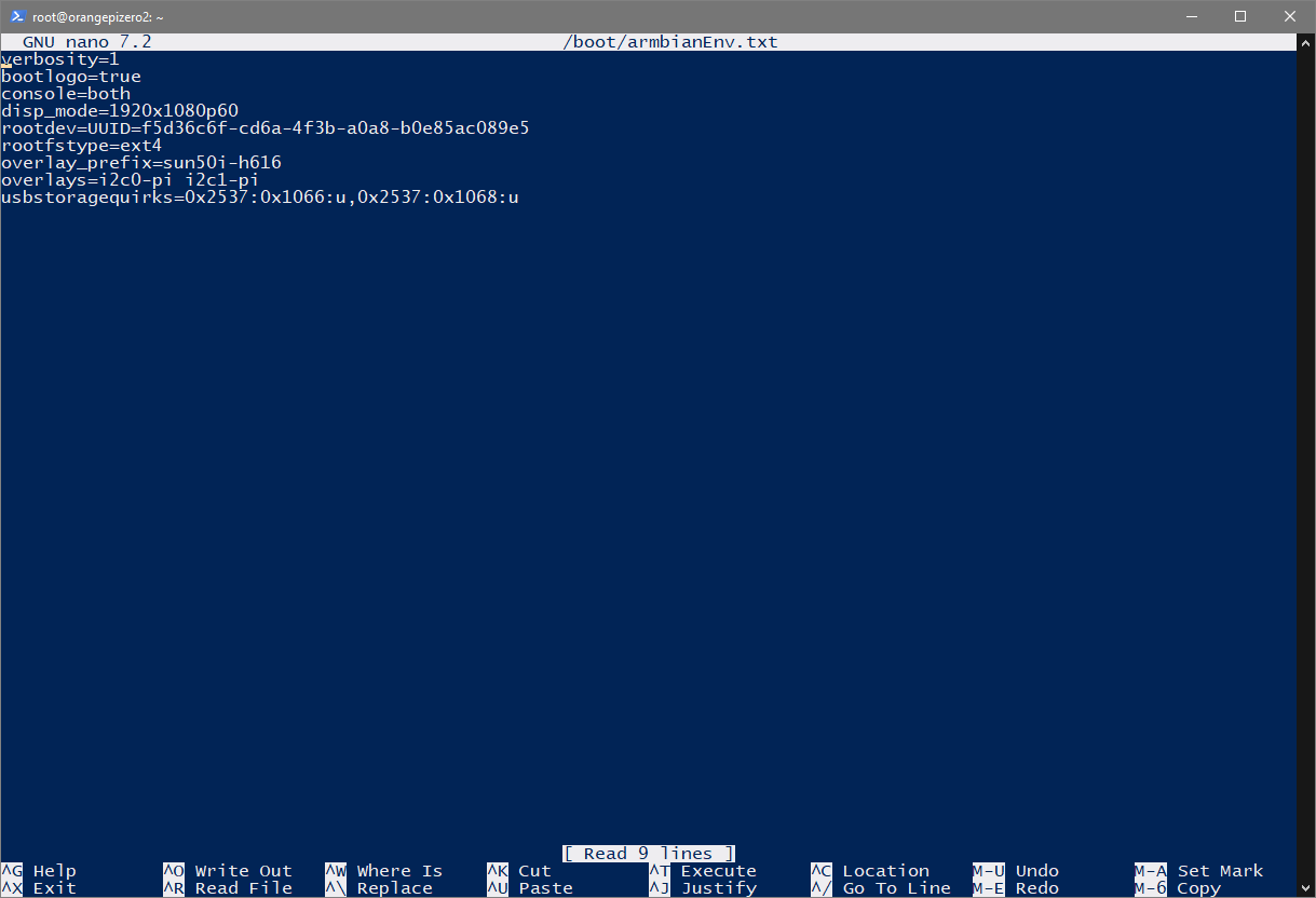

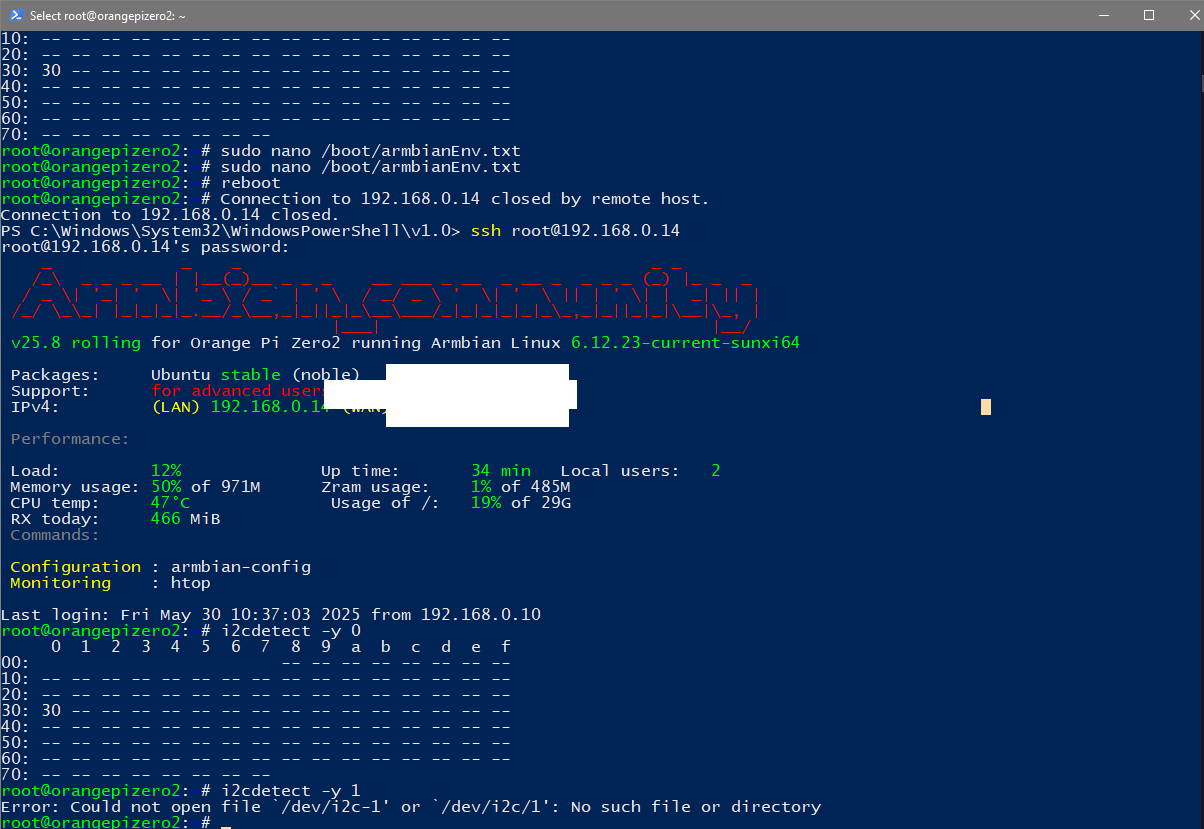

I2C not working on Orange Pi Zero2
Yordan Yanakiev replied to Yordan Yanakiev's topic in Allwinner sunxi
I've added trough the armbian-config the current, but no joy. Tried a few from ChatGPT - no joy as well. I am not into this, since it's my first ( so far only ESP32 ), and honestly I had no idea that this requires this much stuff just to run a basic feature😐 Any help is greatly accepted. This is the /boot/armbianEnv.txt : verbosity=1 bootlogo=true console=both disp_mode=1920x1080p60 rootdev=UUID=f5d36c6f-cd6a-4f3b-a0a8-b0e85ac089e5 rootfstype=ext4 overlay_prefix=sun50i-h616 overlays=sun50i-h616-i2c0-pi sun50i-h616-i2c1-pi usbstoragequirks=0x2537:0x1066:u,0x2537:0x1068:u -

Hi Yordan, Are you sure you have correctly enabled the i2c overlay on your board? what is the output of cat /boot/armbianEnv.txt? If something is showing up even with nothing apparently connected they your are likely targeting a different bus. It is possible what you are seeing is the address of the internal pmic although this normal shows up as UU. Best of luck Ryzer

Hello. I'm trying to communicate with i2c ( i've connected ADS1115 on it if this maters ), but even without anything connected on it - it shows 0x30 on it, and I am not sure how to make it works. Please help ! 😐
