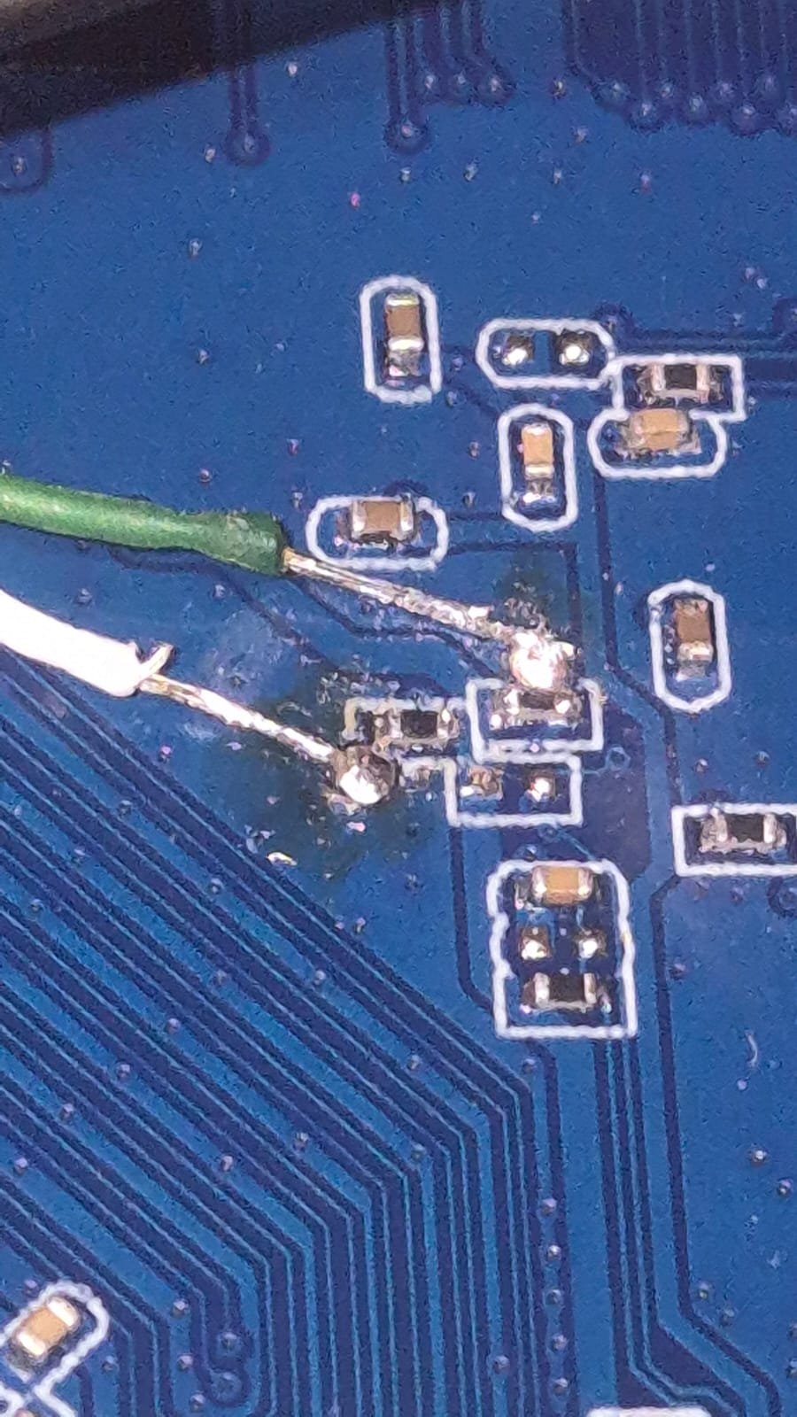

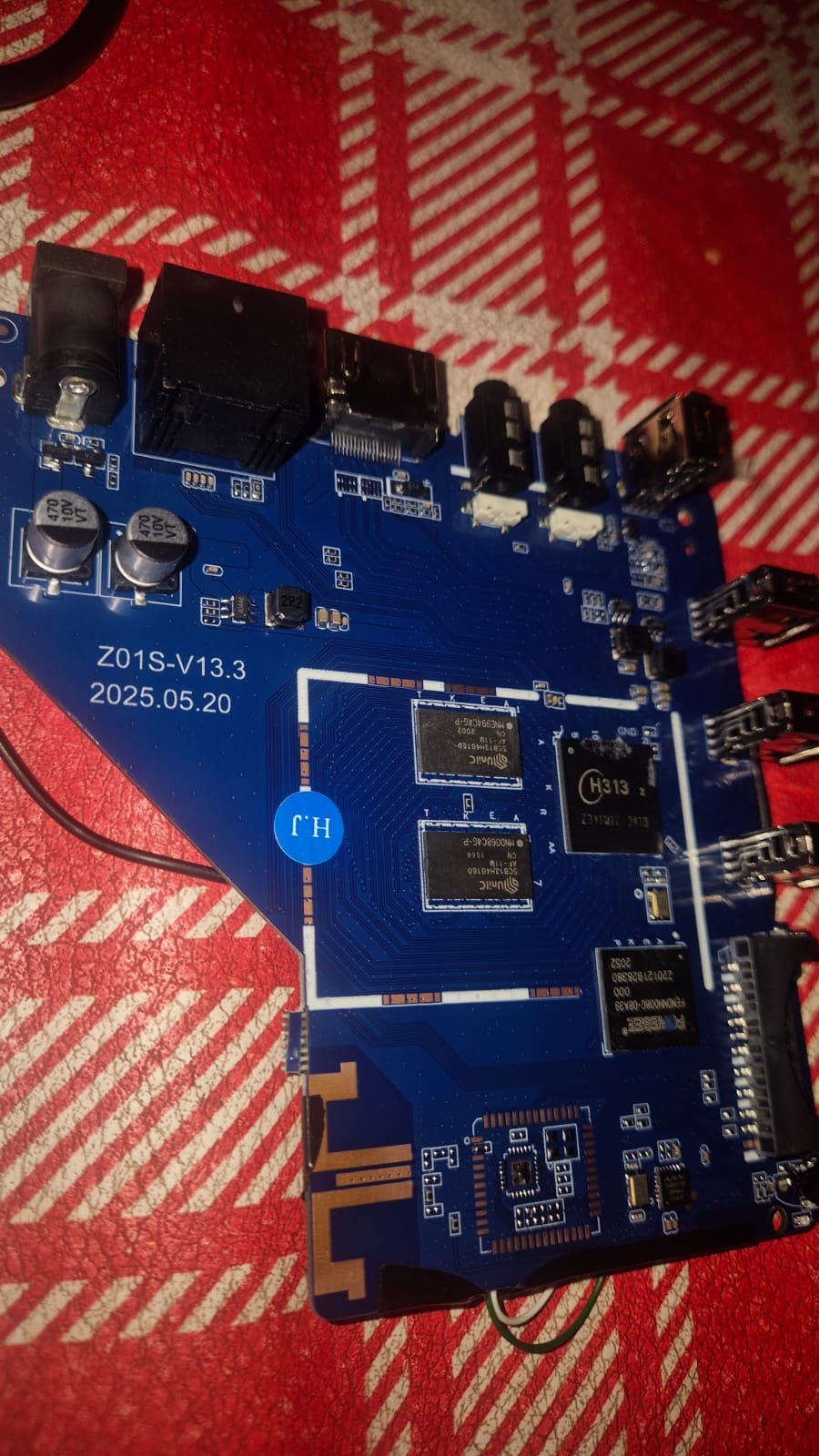

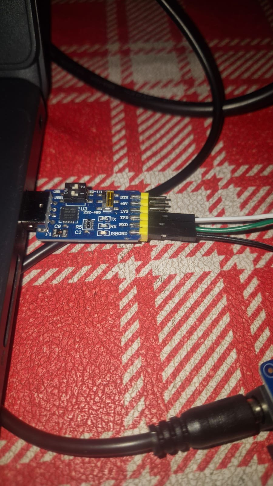

Octavio Cuatrochio replied to Ducdanh Nguyen's topic in Allwinner CPU Boxes
Well, this version of the PCB seems the most locked up of all. I tried ADB with all USBs, no dice, no root, i soldered the wires to the UART test pins (See image below) but with my setup (also see image below) i could not get any logs via TIO in Linux. Also, the toothpick method does not shows a menu, but goes straight to updating, so ALSO there is locked up, so i cannot go to recovery. Any ideas? i'm pretty out of ideas at this point. Are the wires badly soldered? both shows 3.3V, so i suppose not. Is my USB-To-TTL badly configured? Btw, my PCB is Z01S-v13.3, 2025.05.20. Any help is appreciated. -
