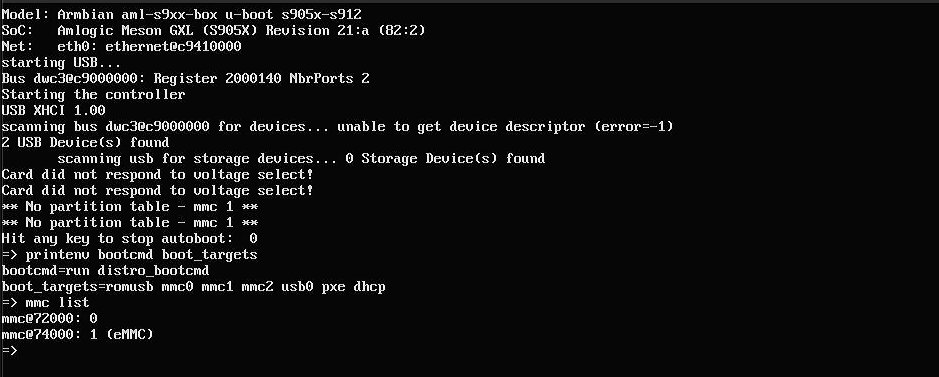

From the boot log, the uboot can't recognize the internal emmc. It appears that the u-boot you are using is one based on u-boot 20-07. I would recommend rebuilding the u-boot-s905x-s912 based on a more current u-boot source. The instructions for doing this are in the readme.txt file in build-u-boot folder. If this helps, then report back here and I can look at including a newer build in the distribution going forward.

Hi folks, Very new to this community, very new to flashing Android boxes.. But I wanted to give this a shot and make use of an old TX5 Pro that I had in a drawer. Pleased to say, boots from the SD card fine, managed to get logged in and set up... all is working, WiFi, Bluetooth etc... However, I am just not able to get this to boot from the eMMC. I got to the point where I bricked it and had to re-flash Android onto it.. just to find myself in the same loop. I'll provide as much info as I can here, but let me know if you need something more specific. I'm no expert here, so here goes. Booting from the SD starts like this: When booted, all is working totally fine. However, removing the SD results in the following, where it will stay for eternity util rebooting and inserting SD: ChatGPT led me to screw this up entirely, despite getting this far based on it's instructions, so I'm turning to you for help. I really need to have this booting from the internal storage and not from an SD card. Here's the copy attempt: root@aml-s9xx-box:~# ./install-aml.sh Start script create MBR and filesystem /dev/mmcblk1 Start backup u-boot default 4+0 records in 4+0 records out 4194304 bytes (4.2 MB, 4.0 MiB) copied, 0.149809 s, 28.0 MB/s Start create MBR and partittion Start restore u-boot 442+0 records in 442+0 records out 442 bytes copied, 0.0044687 s, 98.9 kB/s 8191+0 records in 8191+0 records out 4193792 bytes (4.2 MB, 4.0 MiB) copied, 0.524224 s, 8.0 MB/s Done Start copy system for eMMC. Formatting BOOT partition...mkfs.fat 4.2 (2021-01-31) done. mount: (hint) your fstab has been modified, but systemd still uses the old version; use 'systemctl daemon-reload' to reload. Copying BOOT...done. Edit init config...done. sed: can't read /ddbr/install/boot.ini: No such file or directory done. Formatting ROOT partition... /dev/mmcblk1p2 contains a ext4 file system labelled 'ROOT_EMMC' last mounted on /ddbr/install on Fri May 23 19:51:02 2025 e2fsck 1.47.0 (5-Feb-2023) ROOT_EMMC: clean, 11/855120 files, 80315/3419392 blocks done. Copying ROOTFS. mount: (hint) your fstab has been modified, but systemd still uses the old version; use 'systemctl daemon-reload' to reload. Copy BIN Create DEV Copy ETC Copy HOME Copy LIB Copy LIB64 tar: lib64: Cannot stat: No such file or directory tar: Exiting with failure status due to previous errors Create MEDIA Create MNT Copy OPT Create PROC Copy ROOT Create RUN Copy SBIN Copy SELINUX Copy SRV Create SYS Create TMP Copy USR Copy VAR Copy fstab rm: cannot remove '/ddbr/install/usr/bin/ddbr': No such file or directory ******************************************* Complete copy OS to eMMC ******************************************* Here's some info about the setup, again, let me know if you need something extra: _ _ _ _ _ /_\ _ _ _ __ | |__(_)__ _ _ _ __ ___ _ __ _ __ _ _ _ _ (_) |_ _ _ / _ \| '_| ' \| '_ \ / _` | ' \ / _/ _ \ ' \| ' \ || | ' \| | _| || | /_/ \_\_| |_|_|_|_.__/_\__,_|_||_|_\__\___/_|_|_|_|_|_\_,_|_||_|_|\__|\_, | |___| |__/ v25.5 rolling for aml-s9xx-box running Armbian Linux 6.12.28-current-meson64 Packages: Debian stable (bookworm) Updates: Kernel upgrade enabled and 76 packages available for upgrade Support: for advanced users (rolling release) IPv4: (LAN) 10.0.1.102 (WAN) X.XXX.XXX.XXX Performance: Load: 32% Up time: 1 min Memory usage: 21% of 1.87G CPU temp: 54°C Usage of /: 20% of 29G RX today: 64 MiB Commands: Configuration : armbian-config Upgrade : armbian-upgrade Monitoring : htop System and Boot Logs: https://paste.armbian.com/fiqikiliju PRETTY_NAME="Armbian_community 25.5.0-trunk.538 bookworm" NAME="Debian GNU/Linux" VERSION_ID="12" VERSION="12 (bookworm)" VERSION_CODENAME=bookworm ID=debian HOME_URL="https://www.armbian.com" SUPPORT_URL="https://forum.armbian.com" BUG_REPORT_URL="https://www.armbian.com/bugs" ARMBIAN_PRETTY_NAME="Armbian_community 25.5.0-trunk.538 bookworm" root=UUID=e969167d-e6a9-4203-896f-ced402105523 rootflags=data=writeback console=ttyAML0,115200n8 console=tty0 rw no_console_suspend consoleblank=0 fsck.fix=yes fsck.repair=yes net.ifnames=0 splash plymouth.ignore-serial-consoles NAME FSTYPE FSVER LABEL UUID FSAVAIL FSUSE% MOUNTPOINTS mmcblk0 ├─mmcblk0p1 vfat FAT32 armbi_boot 479F-151E 414M 19% /boot └─mmcblk0p2 ext4 1.0 armbi_root e969167d-e6a9-4203-896f-ced402105523 22.5G 19% /var/log.hdd / mmcblk1 ├─mmcblk1p1 vfat FAT16 BOOT_EMMC 75EA-4970 └─mmcblk1p2 ext4 1.0 ROOT_EMMC d0456959-1f46-4aad-b7f0-d784208d67a8 mmcblk1boot0 mmcblk1boot1 zram0 [SWAP] zram1 40.2M 7% /var/log zram2 label Armbian_community kernel /Image initrd /uInitrd fdt /dtb/amlogic/meson-gxl-s905x-p212.dtb append root=UUID=e969167d-e6a9-4203-896f-ced402105523 rootflags=data=writeback console=ttyAML0,115200n8 console=tty0 rw no_console_suspend consoleblank=0 fsck.fix=yes fsck.repair=yes net.ifnames=0 splash plymouth.ignore-serial-consoles Any assistance would be greatly appreciate.
