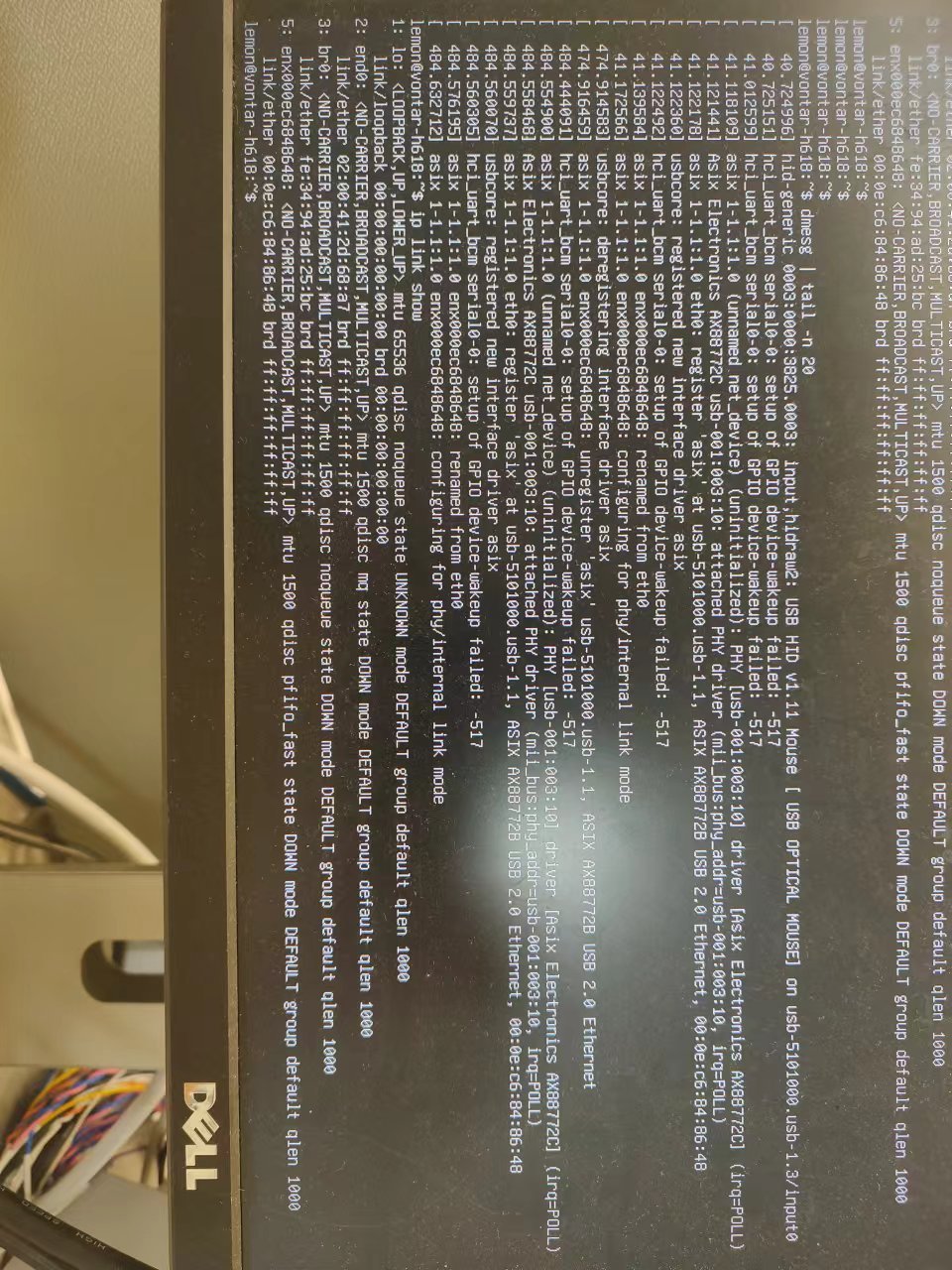

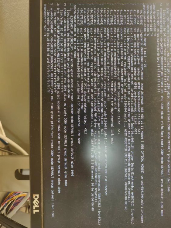

I tried to build image for my vontar h618 box (PCB FX-H618-D4-V10, 4GB Samsung memory, 32GB eMMC). I've compiled it with KERNEL_BTF=no because I have limited RAM in Linux VM - 4+GB wasn't enough for BTF building. Board starts, LAN works OK, but WIFI wasn't present in device list.
then I tried to update system - update is fetched but it seems like .dts is replaced, and HDMI and LAN didn't work at all. /proc/device-tree/name is empty.
I tried to add "fdtfile=sun50i-h618-transpeed-8k618-t.dtb" in /boot/armbianEnv.txt - after reboot all remains same.
how to specify right device tree at boot?
UPD:
I've changed line to "fdtfile=allwinner/sun50i-h618-transpeed-8k618-t.dtb", dtb file seems to be loaded, but nothing happened:

UPD2:
devicetree seems to be loaded, strange that it isn't work:
# cat /proc/device-tree/model
Transpeed 8K618-T
it seems like it's kernel-related thing?
Here's full dmesg:
