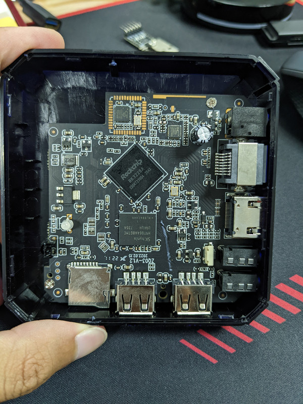

I'm having a weird board.
Chip label is RK3228A, with 8GB eMMC from SKhynix. Multitool doesn't booting up.
In maskrom mode, chip shows as RK3128 and flash 4gb from samsung.
Bus 003 Device 052: ID 2207:310c Fuzhou Rockchip Electronics Company RK3126/RK3128 in Mask ROM mode
Looking at the USB vendor and device IDs, your chip is not a rk3228a but an rk3128.
You may say "But the chip is labelled rk3228a!": there have been past evidences that labels on the chip have been manipulated; I remember a case of a user were the chip was an rk3228a but the label was "Amlogic S905W".
rk3128 in different unsupported chip.

Hello people! Reporting me here. Yesterday i succesfully boots legacy version of @jock images. He told me try to boot current versions from the mainline.
Tried...
rk322x-box jammy current cli 286.66 Mb kernel 5.15.63
rk322x-box jammy current xfce 723.94 Mb kernel 5.15.63
rk322x-box sid current cli 341.22 Mb kernel 5.15.63
rk322x-box sid current xfce 627.60 Mb kernel 5.15.63
Also tried Armbian_22.05.0-trunk_Rk322x-box_bullseye_current_5.15.25_minimal.img made by @jock
One by one burned into the emmc. Starts booting like for 5 seconds then reboots. Last i can read is "tty2" then reboots again, endlesly
Anyone know what could be happening? What can i do?
Im with rk3229 1gb ram, 8 gb samsung emmc model KMVUS000LA B304. Wifi chip model: SV6051P
thanks again
Posted (edited)
@fukowaka I tried these images: Photo
But none does not crash. Even the multitool, I couldn't do a backup because it would take more than 30~60 seconds to do that. Any image I try, none works for more than a minute.
I'm Brazilian and I followed this video tutorial, I even tried to compile an image, but so far nothing.
I'm booting from the SD card, because the way things are, it wouldn't be possible to install on NAND through the multitool.
There doesn't seem to be any hints in these debug lines.
Spoiler

I'm having some issues with my Rockchip 3229 TV box. It has 3GB of DDR3 ram, 4GB of NAND memory.
This makes me think you have some fake specs: rk322x cannot address more than 2GB of RAM and 4GB NANDs are pretty uncommon - never seen any rk322x with that amount of flash memory.
Looking at the log dump I see 1Gb of RAM for your board.
Anyway I don't understand why you are such an old image from 2020...
@jock In fact I tested it on over 15 images.  I started from the current ones, going to the older ones.  This was just one of the boot logs I took.  I'll try to see if it really has 3 gb of ram, at least on Android it said that.  But I confirmed that the datasheet would only go up to 2gb.
