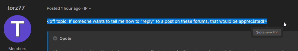

torz77 Posted September 25 Author Posted September 25 <off topic: If someone wants to tell me how to "reply" to a post on these forums, that would be appreciated!> Quote Did you try doing this with a device tree overlay file instead of editing the device tree? That way on kernel upgrades you shouldn't need to redo the device tree edits each time. Sadly, Meson64 does not have DTB Overlays enabled. That would, of course, be my preference. I have, however, updated my instructions to create an overlay and apply it directly to the DTB (rather than manually editing the DTB) and pointed users in the direction of postint.d if they wish to automate this (out of scope to provide specific instructions here). It should now be easier to create an overlay rather than directly apply to DTB if the user's box supports this. Quote Also, did you experiment with this alternative to openvfd? Unfortunately, I did not see this until I was well underway getting OpenVFD working. The box is now in production, so it is not straightforward taking it out and experimenting with it. However, having more than one way to achieve an end goal is no bad thing imho. 0 Quote
Werner Posted September 25 Posted September 25 2 hours ago, torz77 said: <off topic: If someone wants to tell me how to "reply" to a post on these forums, that would be appreciated!> Simply mark whatever you want to quote and a box will appear to click: 1 Quote
