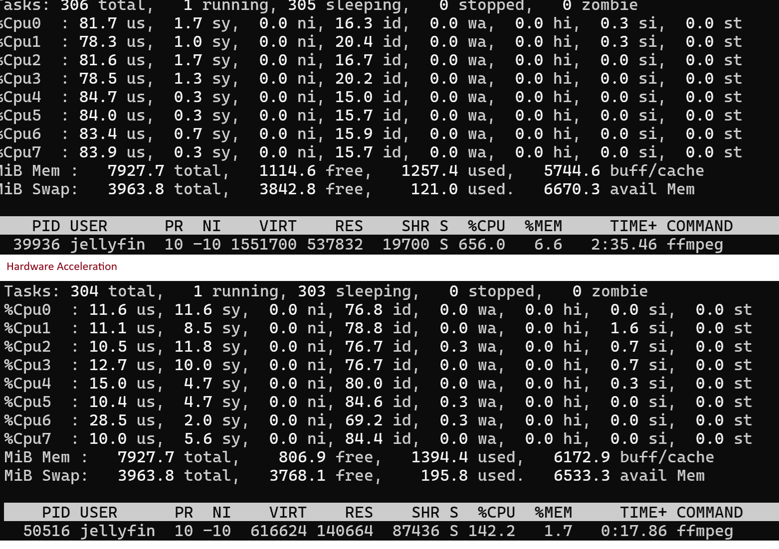

And some Jellyfin CPU vs Hardware accelerated transcoding usage:
