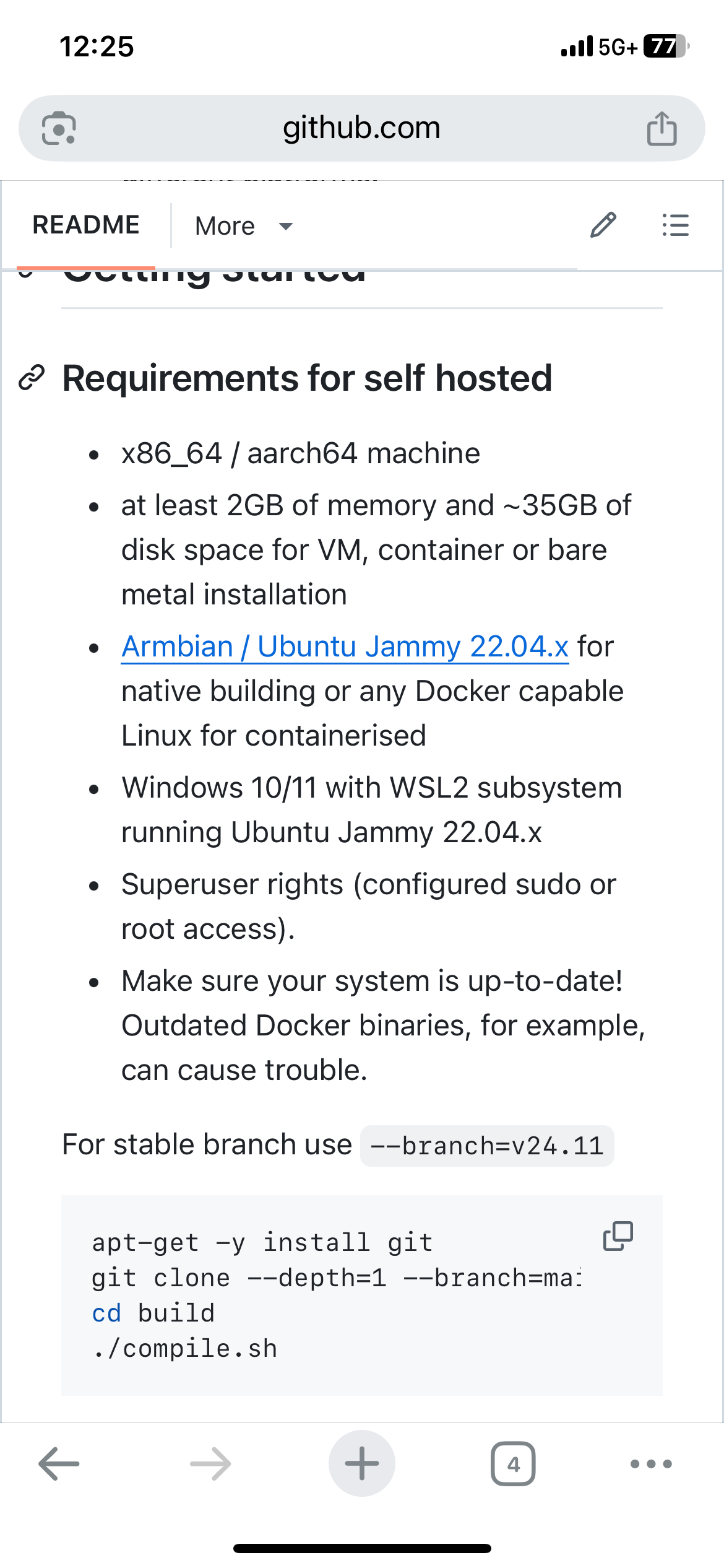

  2. You need jammy installed
  3. windows10 virtuization system. ubuntu 24.04.2lts codname: nobe
  4. @svyatoslav are you using Ubuntu jammy? https://releases.ubuntu.com/jammy/
  5. Viken
    Viken
  6. I have a laptop with virtual Ubuntu. Who can help? I can connect via anydesk to help with the build.
