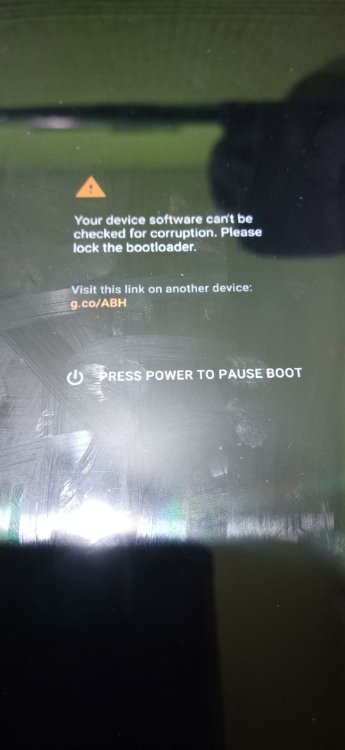

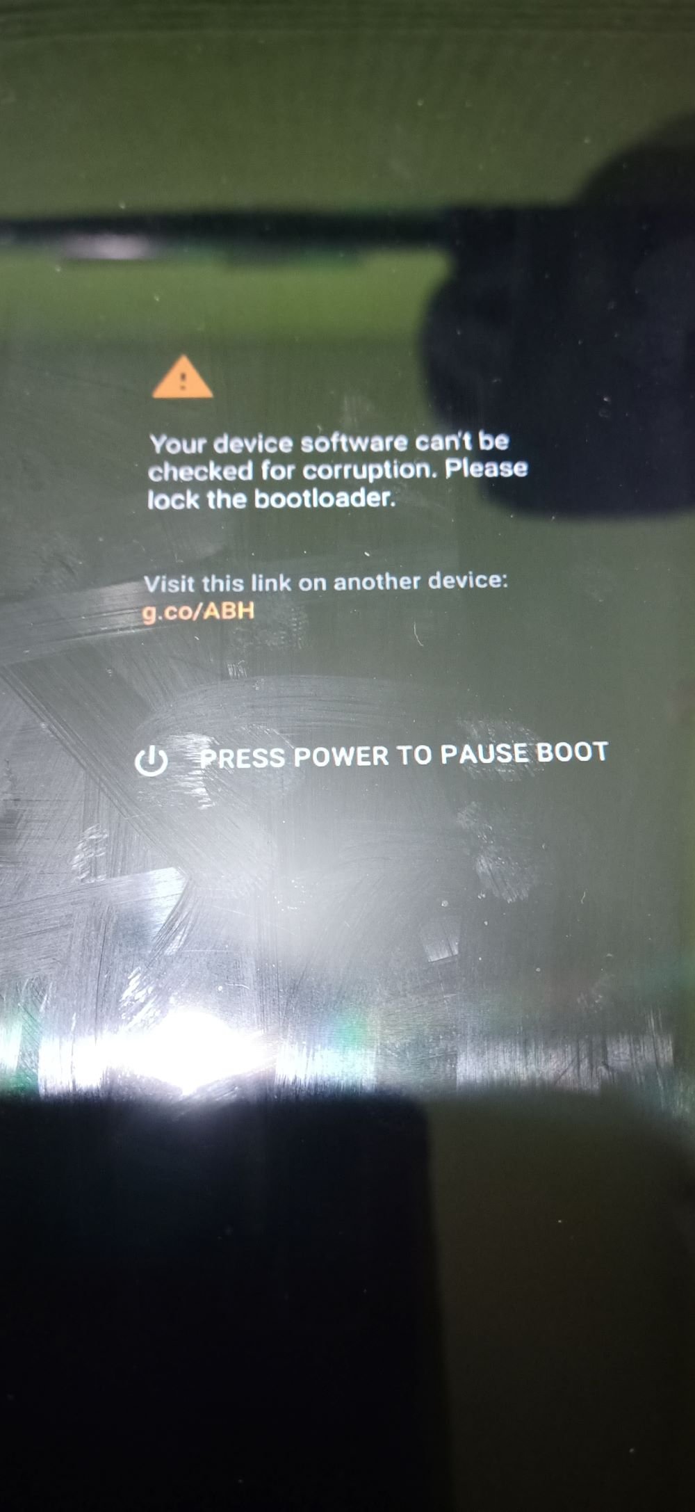

  9. Hi guys 1: First, I'm happy to register on your forum. 2: I needed to root my TECLAST T60 IA tablet to test it with some software, and I found this post on your forum. 3: My problem is: #: I followed the rooting steps up to step 5. #: Thinking it was better to install the new firmware first and then proceed with rooting. #: My big mistake was starting the firmware update with PhoenixSuit and the bootloader unlocked. After a while, I got a firmware error, and after restarting, I got this message. 4: I tried to enter fastboot mode by pressing the power button, volume down button, and volume up button, but I can't get into fastboot mode. I hope you can help me figure out how to enter fastboot mode, install the firmware, and then try to root the device.
