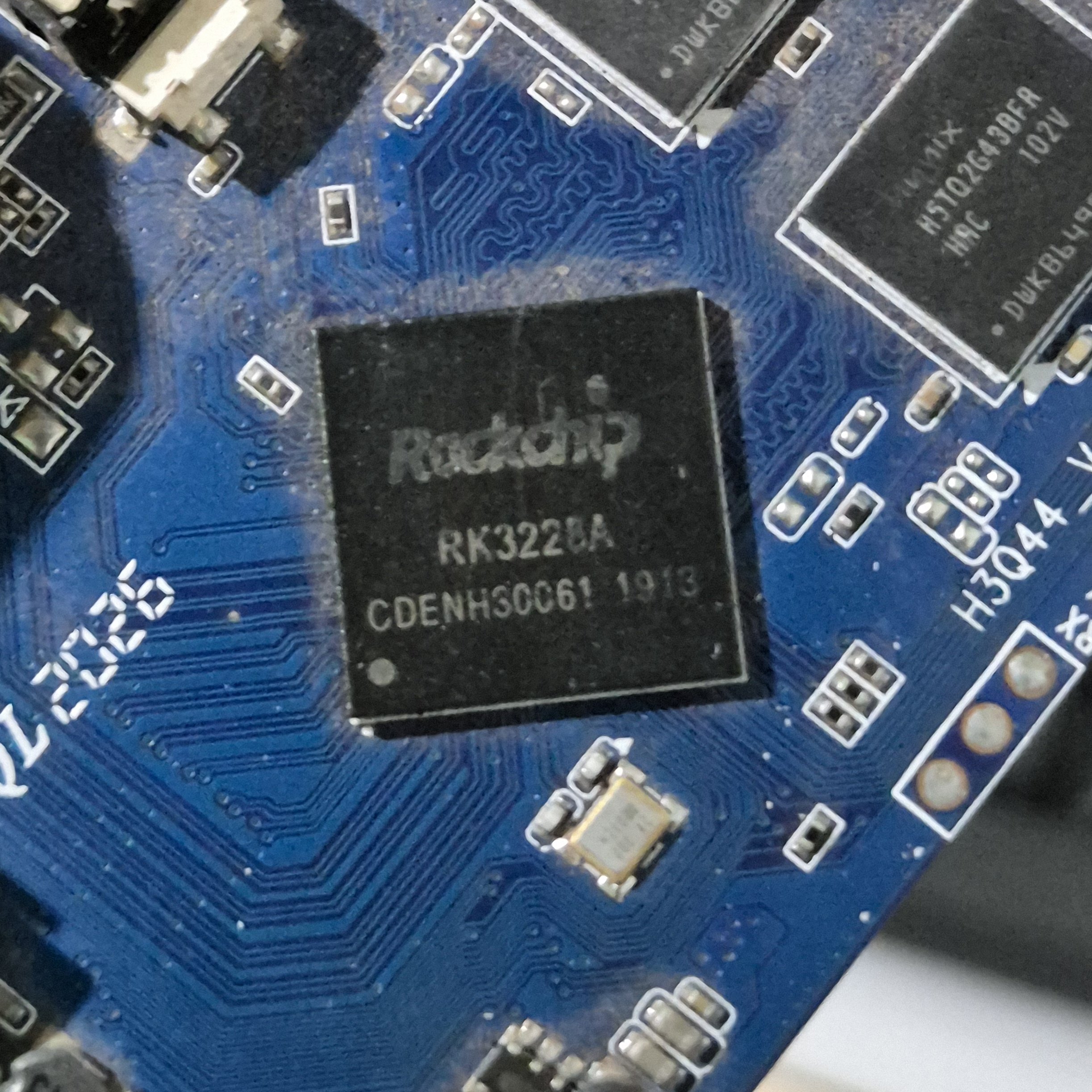

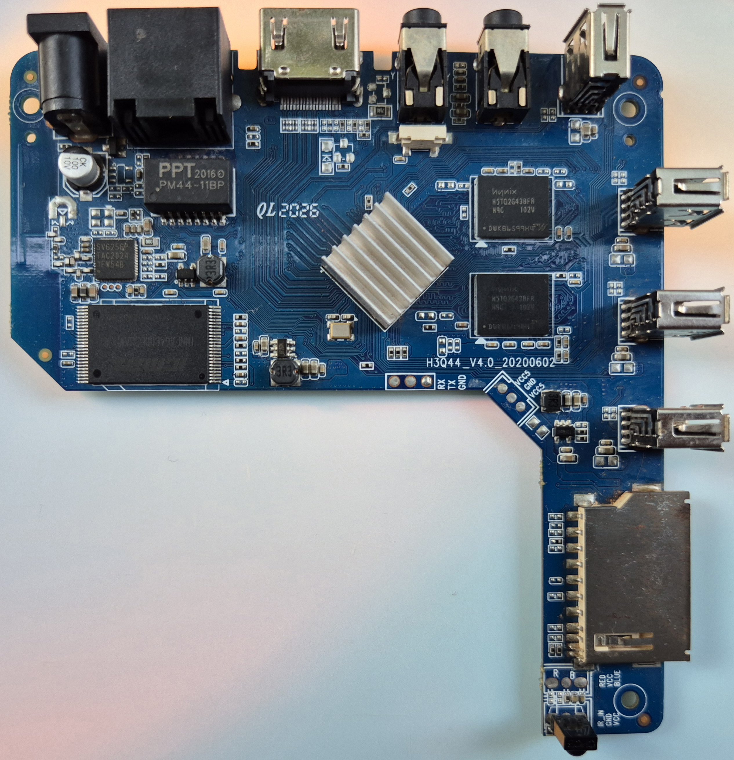

Well, it seems that I have a very strange device, as I can boot armbian for devices using Allwinner H3, even tho the SoC shows It self as a RK322BA. I don't know what's happening with my device, and unfortunately, there's no much information about it, just some users trying random armbian builds from devices with the same soc, which works, but features like wi-fi doesn't, probably something that can be fixed making a dtb for this device, which I don't know how to unfortunately.
@Mateus Lima I am not very sure this Is a rockchip board.. i see h3q ...may be an allwinner h3 ?????? Can you check removing the heatsink ? Or check with USB ttl adapter ?
What is this method about? Hold the button while it is booting with the sdcard inserted? I also tried to boot using a usb drive flashed with multitool flashed, but it still boots into android. As for the bootloader, I'm booting it into bootloader mode, and it gets recognised, but "fastboot oem unlock" just prints three dots "..." and doesn't do nothing. In the guide there's a bootloader file I think, but it's not available anymore.

Do you try also toothpick (there is a recovery button behind headphone port) methode and SD-Card ? or USB boot , there are some box with lock bootloader
I'm trying to boot multitool, but my device is booting directly into android. I've flashed my sdcard using dd and balena, both works fine apparently, the box recognizes the sdcard (it shows on android file manager), but every time I reboot it, it only boots android... Does anyone have any clue of what should I do?
