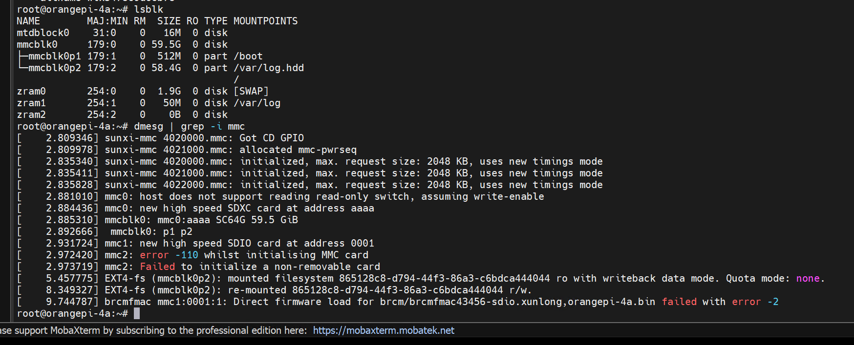

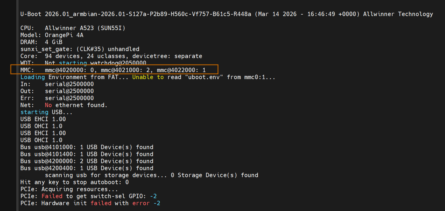

  2. I am having issues with eMMC detection… The kernel does not detect the eMMC, but apparently U-Boot does. Attached are images.
