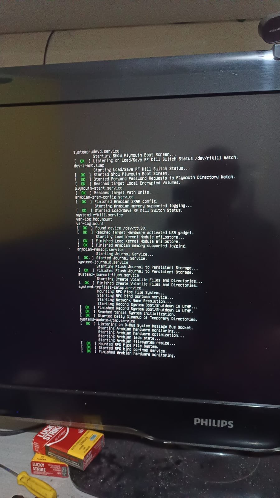

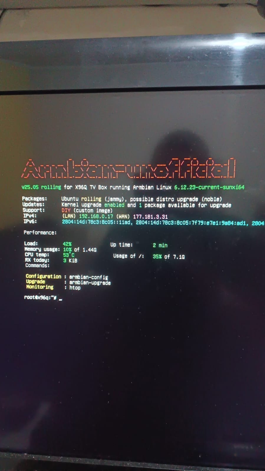

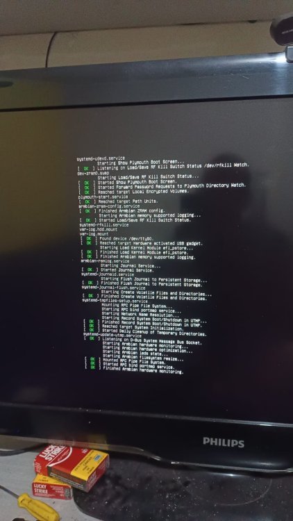

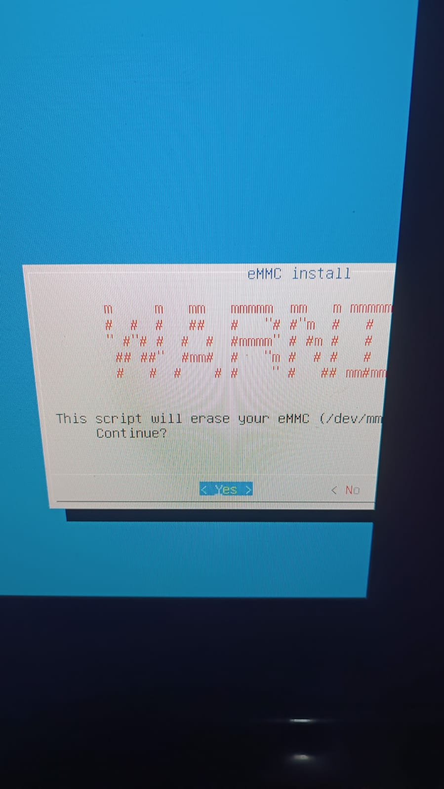

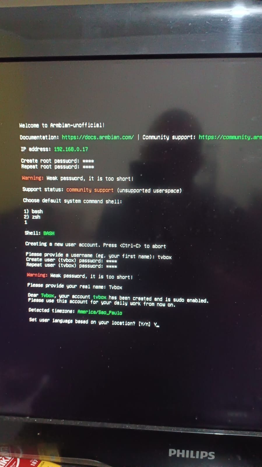

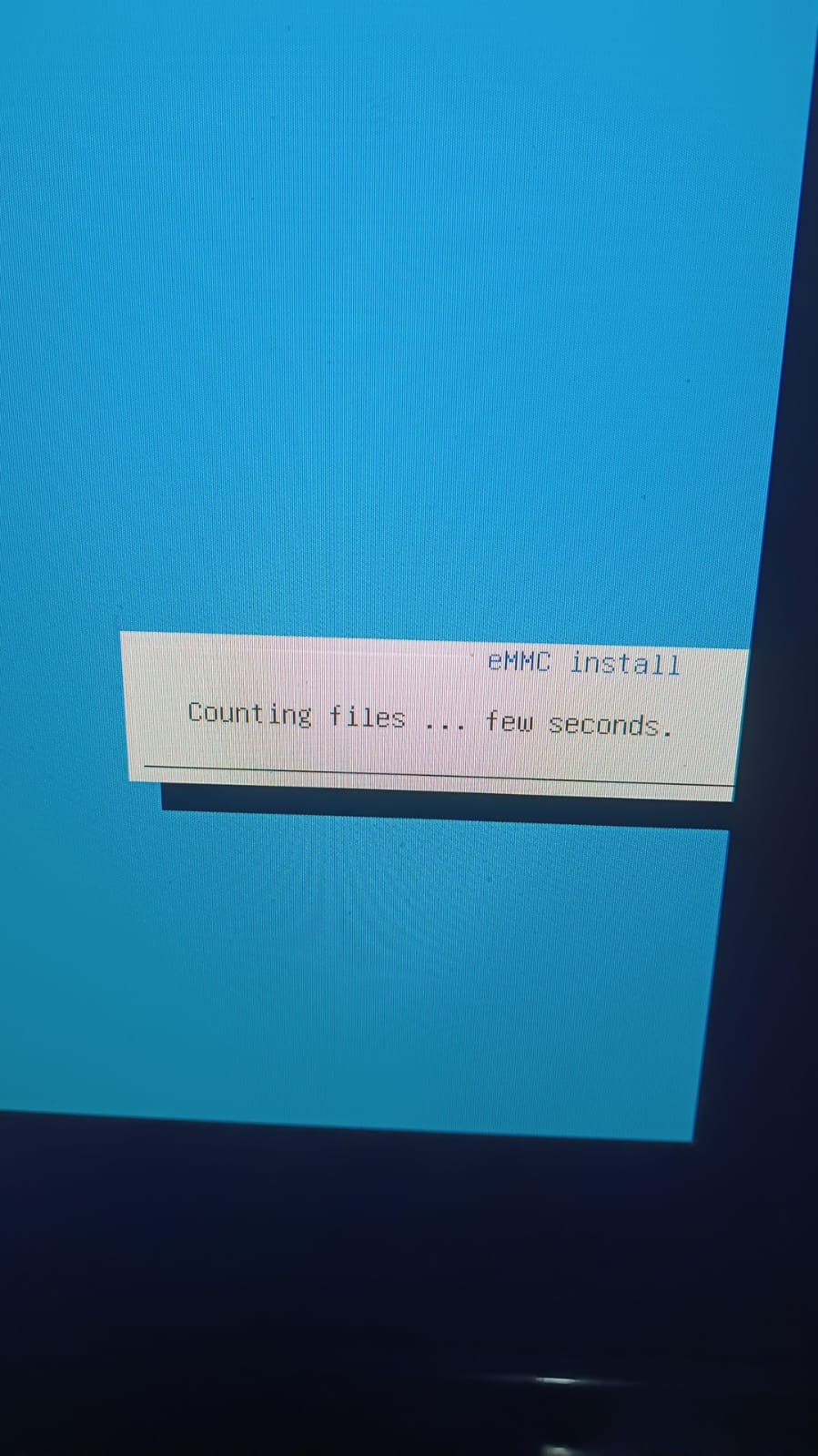

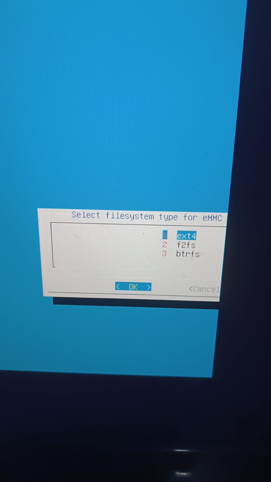

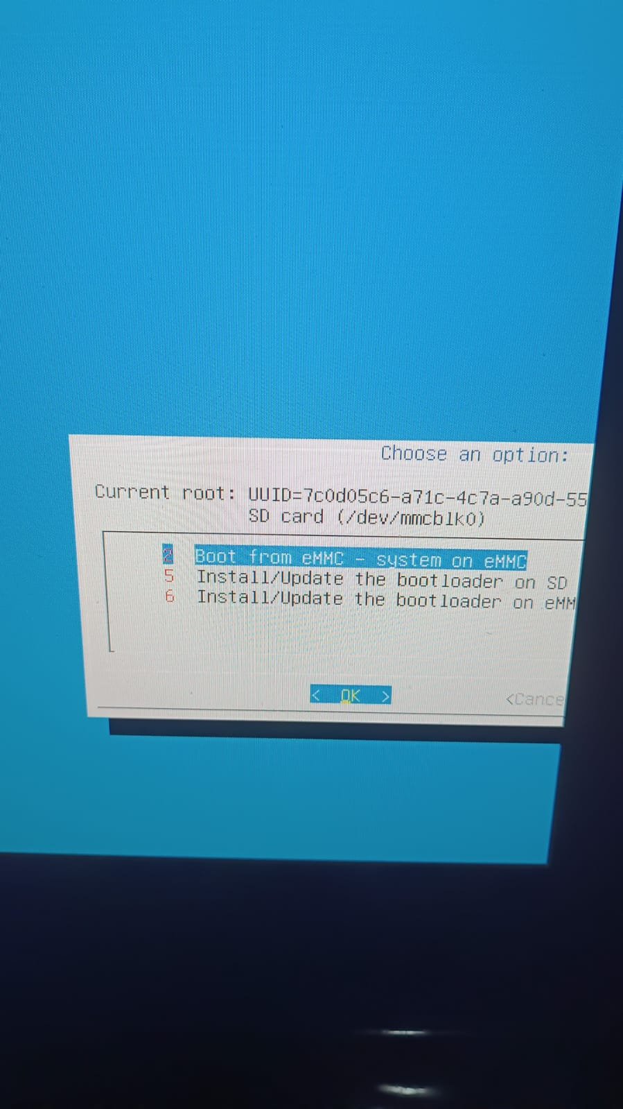

  4. I tried generating some builds, the only one that works (initially) is Armbian-unofficial_25.05.0-trunk_X96q_jammy_current_6.12.23 (versions with or without desktop). I don't understand much, but I believe that the emmc memory is detected. When I start it, it boots, asks the initial questions (root password, create my user, region settings, etc.). After that, I use the armbian-install command and enter the installer, select to install, ask me to confirm (data will be deleted), ask how I want to format the partition and then get stuck. PS: To mount the image I used this command: ./compile.sh build BOARD=x96q BRANCH=current BUILD_DESKTOP=no BUILD_MINIMAL=no EXPERT=yes KERNEL_CONFIGURE=no RELEASE=jammy (I tried to use the version BOARD=x96q-mate, but don't work! As you can see in the video, the image shakes for a while, then stops. I think that's when the device freezes. VID-20250509-WA0007.mp4
