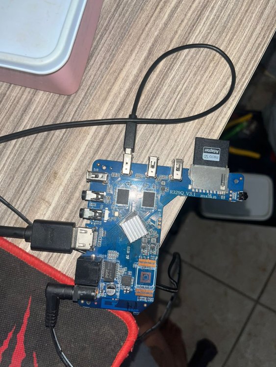

This is from Hardkernel, I don't have an Amlogic SBC, but I once saw petitboot is sort of boot-selection and/or OS installer (menu driven) thing. Same as for Rockchips where old RK35xx mostly 2017.09 based U-Boot does not work with newer mainline based kernel, you can expect the same here. So wherever that U-Boot is stored (SPI-flash, eMMC), you need to make sure it is not used, so wipe it or bypass it or overwrite it with the U-Boot binary that comes with the Armbian image you try to boot. In your currently running system, so with old kernel but new userspace, you should be able to use armban-config to flash the current and kernel 6.18 matching U-Boot to the specific storage where petitboot is now stored. But means overwriting, I would first save it, done that for some other ARM boards (also smartphones) at least as you never know if you might need the exact old/vendor firmware/bootloader for fixing some problem many years from now. So make sure you know the right sector numbers for that Amlogic SoC where it look for bootloader at power on. Can be found in docs (Hardkernel) or see /usr/lib/u-boot/platform_install.sh

Finally got an UART device for logs U-Boot 2015.01 (Sep 01 2020 - 18:41:51) DRAM: 3.5 GiB Relocation Offset is: d6eeb000 spi_post_bind(spifc): req_seq = 0 register usb cfg[0][1] = 00000000d7f83da8 MMC: aml_priv->desc_buf = 0x00000000d3edb7c0 aml_priv->desc_buf = 0x00000000d3eddb00 SDIO Port C: 0, SDIO Port B: 1 co-phase 0x3, tx-dly 0, clock 400000 co-phase 0x3, tx-dly 0, clock 400000 co-phase 0x3, tx-dly 0, clock 400000 emmc/sd response timeout, cmd8, status=0x1ff2800 emmc/sd response timeout, cmd55, status=0x1ff2800 co-phase 0x3, tx-dly 0, clock 400000 co-phase 0x1, tx-dly 0, clock 40000000 aml_sd_retry_refix[983]:delay = 0x0,gadjust =0x12000 [mmc_startup] mmc refix success [mmc_init] mmc init success In: serial Out: serial Err: serial vpu: error: vpu: check dts: FDT_ERR_BADMAGIC, load default parameters vpu: driver version: v20190313 vpu: detect chip type: 9 vpu: clk_level default: 7(666667000Hz), max: 7(666667000Hz) vpu: clk_level = 7 vpu: vpu_power_on vpu: set_vpu_clk vpu: set clk: 666667000Hz, readback: 666666667Hz(0x100) vpu: set_vpu_clk finish vpu: vpu_module_init_config vpp: vpp_init vpp: g12a/b osd1 matrix rgb2yuv .............. vpp: g12a/b osd2 matrix rgb2yuv.............. vpp: g12a/b osd3 matrix rgb2yuv.............. cvbs: cpuid:0x29 cvbs_config_hdmipll_g12a cvbs_set_vid2_clk ** File not found boot-logo.bmp.gz ** ** File not found boot-logo.bmp ** movi: not registered partition name, logo movi - Read/write command from/to SD/MMC for ODROID board Usage: movi <read|write> <partition|sector> <offset> <address> [<length>] - <read|write> the command to access the storage - <offset> the offset from the start of given partiton in lba - <address> the memory address to load/store from/to the storage device - [<length>] the size of the block to read/write in bytes - all parameters must be hexa-decimal only [OSD]check dts: FDT_ERR_BADMAGIC, load default fb_addr parameters [OSD]set initrd_high: 0x3d800000 [OSD]fb_addr for logo: 0x3d800000 [OSD]check dts: FDT_ERR_BADMAGIC, load default fb_addr parameters [OSD]fb_addr for logo: 0x3d800000 [OSD]VPP_OFIFO_SIZE:0xfff01fff [CANVAS]canvas init [CANVAS]addr=0x3d800000 width=5760, height=2160 cvbs: outputmode[1080p60hz] is invalid vpp: vpp_matrix_update: 2 set hdmitx VIC = 16 config HPLL = 5940000 frac_rate = 1 HPLL: 0x3b3a04f7 HPLL: 0x1b3a04f7 HPLLv1: 0xdb3a04f7 config HPLL done j = 6 vid_clk_div = 1 hdmitx phy setting done hdmitx: set enc for VIC: 16 enc_vpu_bridge_reset[1319] rx version is 1.4 or below div=10 Net: dwmac.ff3f0000 Hit Enter or space or Ctrl+C key to stop autoboot -- : 0 ## Attempting fetch boot.ini in mmc:0... ** File not found boot.ini ** ## Executing script at 04000000 Wrong image format for "source" command ## Attempting fetch boot.scr in mmc:0... ** File not found boot.scr ** ## Executing script at 04000000 Wrong image format for "source" command ## Attempting fetch /boot/boot.ini in mmc:0... 5578 bytes read in 5 ms (1.1 MiB/s) ## Executing script at 04000000 0 bytes read in 3 ms (0 Bytes/s) Found mainline kernel configuration HDMI cable is NOT connected 178 bytes read in 5 ms (34.2 KiB/s) ** File not found uImage ** 42404352 bytes read in 1187 ms (34.1 MiB/s) ** File not found dtb/amlogic/meson-g12b-odroid-n2-plus.dtb ** 83033 bytes read in 29 ms (2.7 MiB/s) ** File not found uInitrd ** 22881405 bytes read in 642 ms (34 MiB/s) ee_gate_off ... Wrong Image Format for bootm command ERROR: can't get kernel image! [rsvmem] get fdtaddr NULL! rsvmem - reserve memory Usage: rsvmem check - check reserved memory rsvmem dump - dump reserved memory rsvmem check failed ee_gate_on ... ## Attempting fetch /boot/boot.scr in mmc:0... 8133 bytes read in 3 ms (2.6 MiB/s) ## Executing script at 04000000 U-boot default fdtfile: meson-g12b-odroid-n2-plus.dtb Current variant: n2_plus For variant n2_plus, set default fdtfile: amlogic/meson-g12b-odroid-n2-plus.dtb Unknown command 'part' - try 'help' Current fdtfile after armbianEnv: amlogic/meson-g12b-odroid-n2-plus.dtb Mainline bootargs: root=/dev/mmcblk1p1 rootwait rootfstype=ext4 splash=verbose console=ttyAML0,115200 console=tty1 consoleblank=0 coherent_pool=2M loglevel=1 ubootpart= libata.force=noncq usb-storage.quirks=0x2537:0x1066:u,0x2537:0x1068:u cgroup_enable=memory ** File not found uInitrd ** ** File not found Image ** ** File not found dtb/amlogic/meson-g12b-odroid-n2-plus.dtb ** libfdt fdt_check_header(): FDT_ERR_BADMAGIC No FDT memory address configured. Please configure the FDT address via "fdt addr <address>" command. Aborting! ** File not found dtb/amlogic/overlay/-.dtbo ** ** File not found dtb/amlogic/overlay/-fixup.scr ** [rsvmem] get fdtaddr NULL! rsvmem - reserve memory Usage: rsvmem check - check reserved memory rsvmem dump - dump reserved memory rsvmem check failed Bad Linux ARM64 Image magic! ## Attempting fetch boot.ini in mmc:1... card out ** Bad device mmc 1 ** ## Executing script at 04000000 U-boot default fdtfile: amlogic/meson-g12b-odroid-n2-plus.dtb Current variant: n2_plus For variant n2_plus, set default fdtfile: amlogic/meson-g12b-odroid-n2-plus.dtb card out ** Bad device mmc 1 ** Unknown command 'part' - try 'help' Current fdtfile after armbianEnv: amlogic/meson-g12b-odroid-n2-plus.dtb card out ** Bad device mmc 1 ** Mainline bootargs: root=/dev/mmcblk1p1 rootwait rootfstype=ext4 splash=verbose console=ttyAML0,115200 console=tty1 consoleblank=0 coherent_pool=2M loglevel=1 ubootpart= libata.force=noncq usb-storage.quirks=0x2537:0x1066:u,0x2537:0x1068:u cgroup_enable=memory card out ** Bad device mmc 1 ** card out ** Bad device mmc 1 ** card out ** Bad device mmc 1 ** libfdt fdt_check_header(): FDT_ERR_BADMAGIC No FDT memory address configured. Please configure the FDT address via "fdt addr <address>" command. Aborting! card out ** Bad device mmc 1 ** card out ** Bad device mmc 1 ** card out ** Bad device mmc 1 ** [rsvmem] get fdtaddr NULL! rsvmem - reserve memory Usage: rsvmem check - check reserved memory rsvmem dump - dump reserved memory rsvmem check failed Bad Linux ARM64 Image magic! After this it loops it for all mmc/usb devices and breaks. I need to manually copy old kernel files to /boot to get it to work again (through petitboot) Anything after 6.12.58 seems to break for me. Thoughts?
