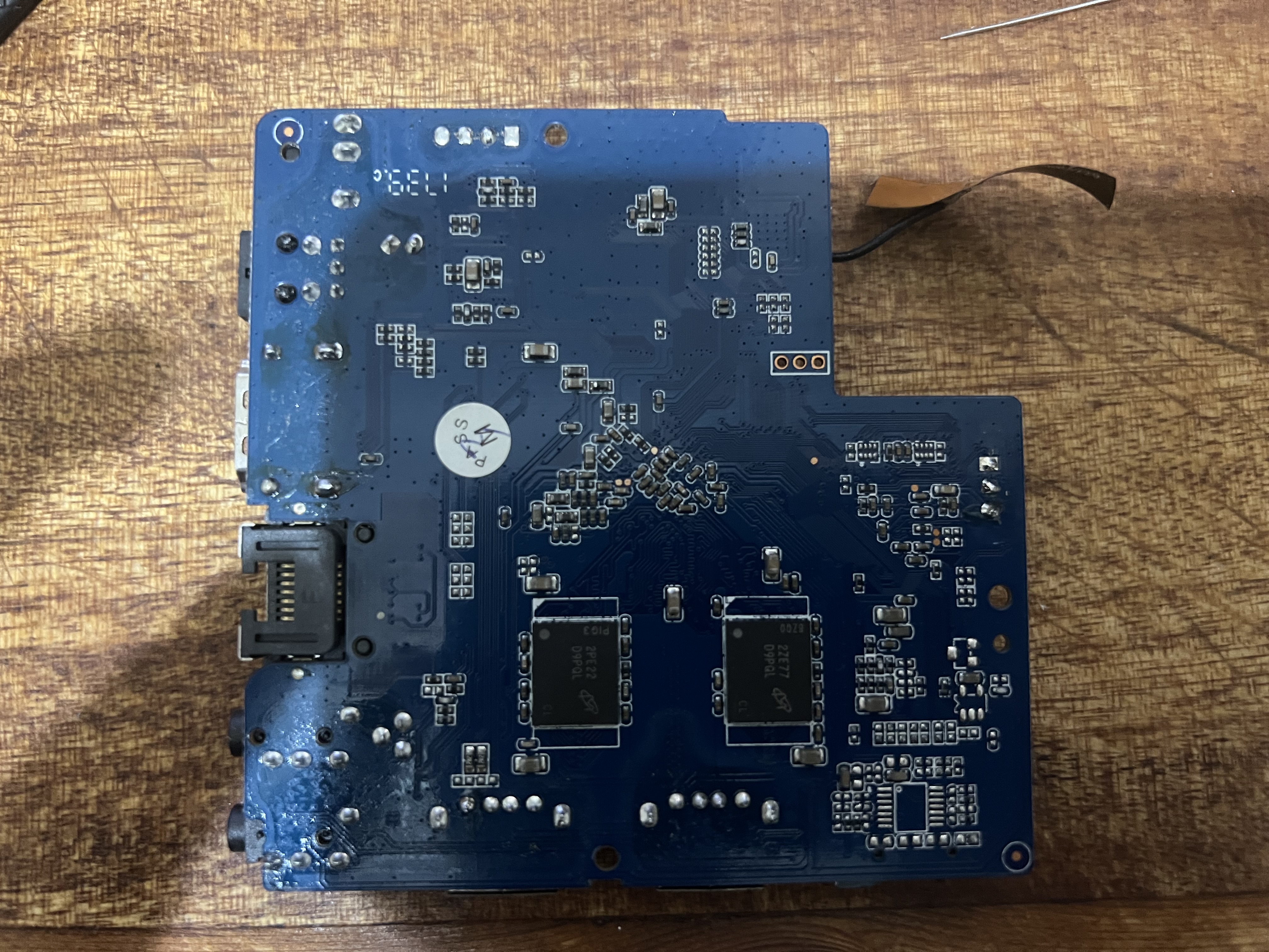

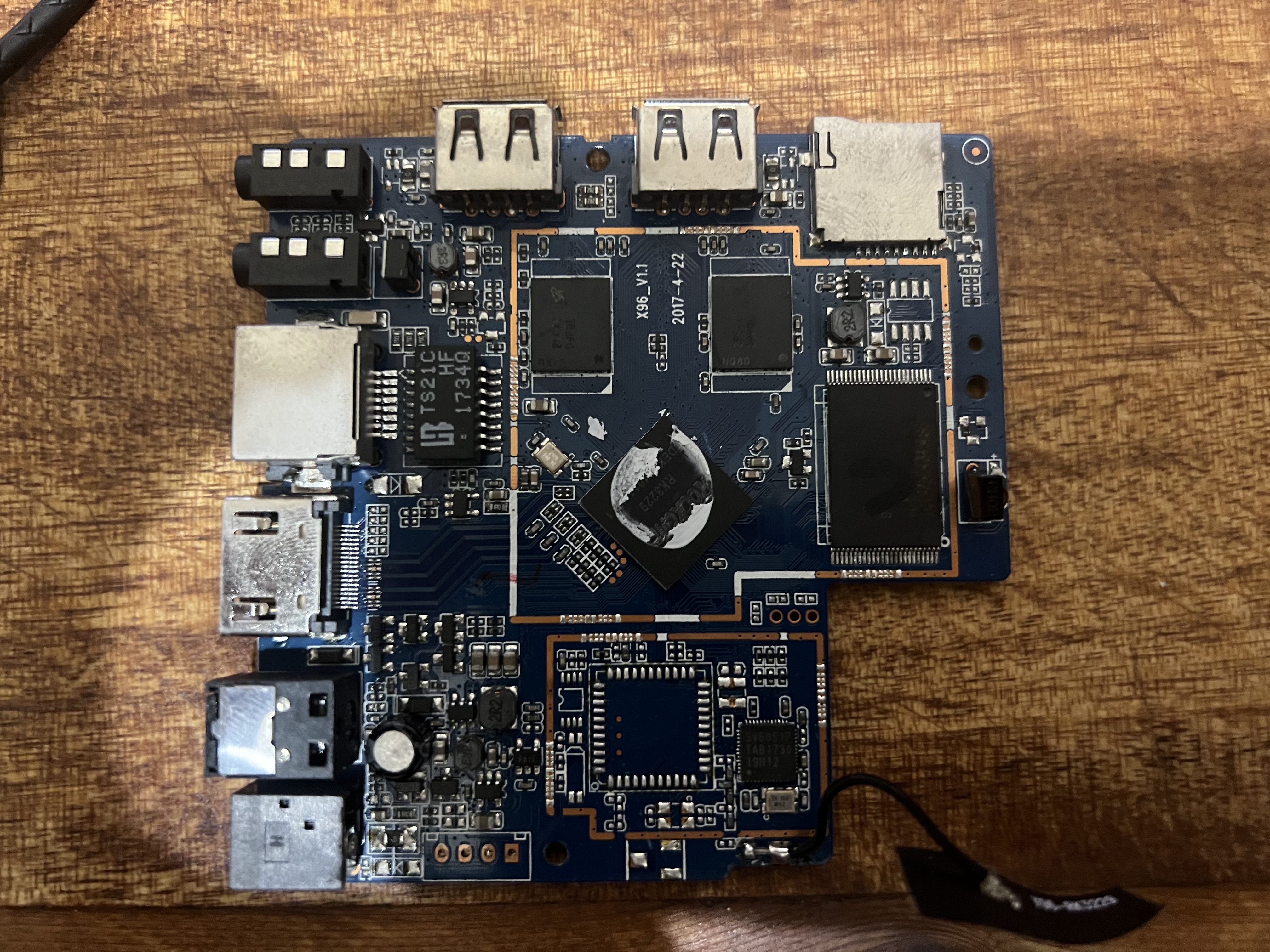

LoSpo Posted November 2 Posted November 2 (edited) I found a TX box X96 Mini with rk3228 chip and I try to boot with multitool but it is stuck with a red ligh. I try multitool and multitool2, with no success, can someone tell me what I am doing wrong ? Thank you The multitool i used are from here i used balena etcher to burn the image I also try to short pins on eMMc (around 45 times...) but nothing works from me. Now i order a male-male cable on amazon. edit: added front/left photos Edited November 2 by Francesco Spossati attach board photo/added details 0 Quote

LoSpo Posted November 6 Posted November 6 I think i find where all my trouble start. i can doownload to the box the rk322x_loader_v1.10.238_256.bin but i can't switch to the emmc. Does anyone have ideas of what to do? 0 Quote
