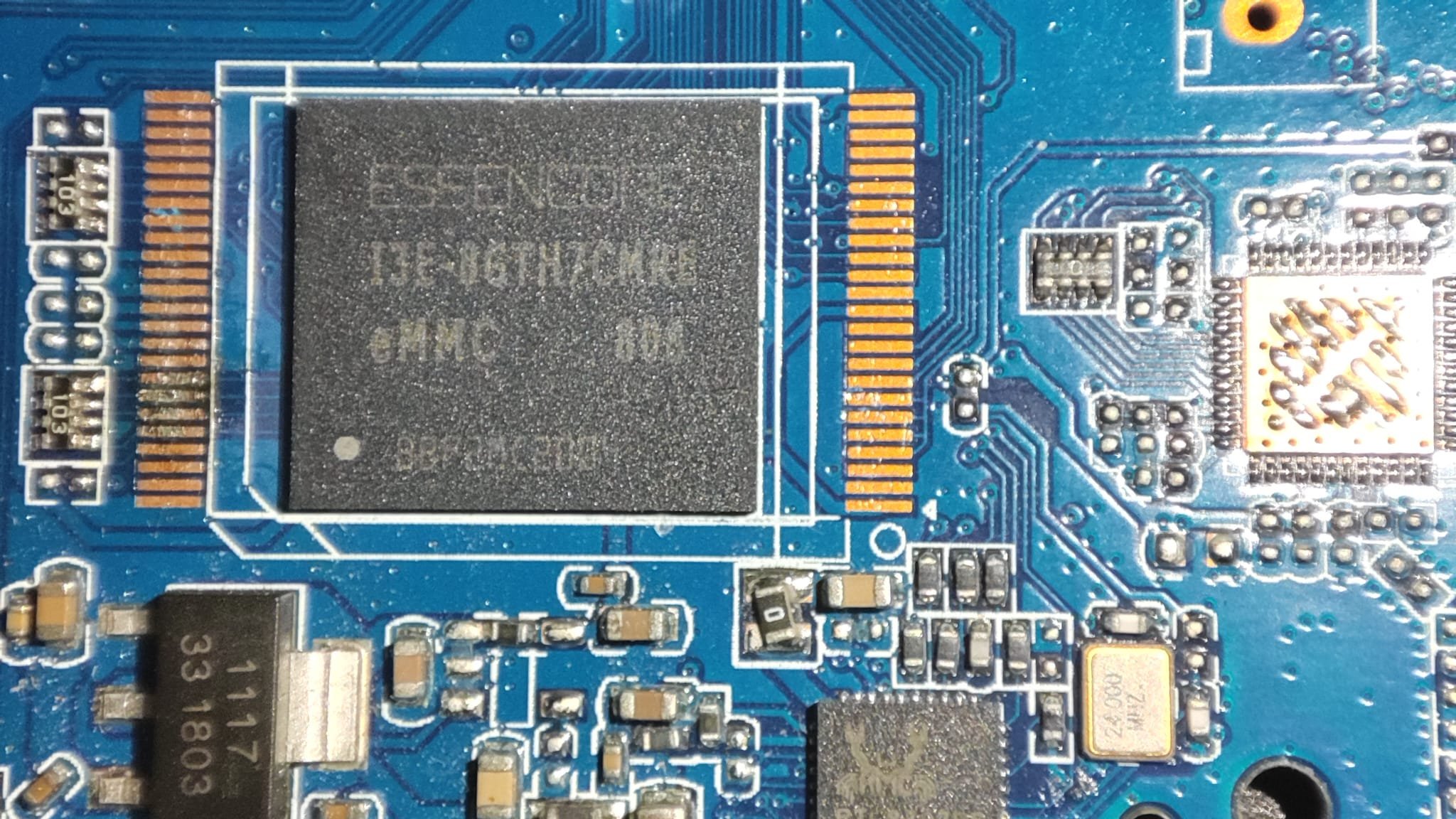

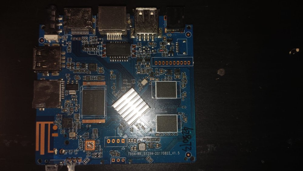

Kiranmoy Saha Posted September 22 Posted September 22 Hi @jock, Thanks a lot for your work on these RK322x boards. I have an MXQ Pro (RK3229, 2GB RAM / 16GB eMMC). I was able to boot Multitool from SD and successfully create a backup of the eMMC. However, when I burn an Armbian image to flash, the box doesn’t boot—LED blinks, but nothing shows up on HDMI. I’ve tried a few different images with the same result. Could you please guide me on how to debug this? 0 Quote
jock Posted September 22 Author Posted September 22 7 hours ago, Kiranmoy Saha said: Could you please guide me on how to debug this? Open the box, read the silkscreen on the board, run rk322x-config and configure according to silkscreen name. Probably you have a r29/h20 board 0 Quote
Kiranmoy Saha Posted September 23 Posted September 23 19 hours ago, jock said: run rk322x-config and configure according to silkscreen name Hi @jock, Thanks for the quick response. I’ve opened the box and attached the board images. On the back it says R29-MXQ-V2.1-221#. Sorry if I’m missing something—I’m a beginner. I thought rk322x-config runs only after Armbian boots. In my case, after flashing the image to eMMC and removing the SD, the box just blinks LED with no HDMI output. Only Multitool runs fine from SD. How can I run rk322x-config in this situation? Thanks again. 0 Quote
fabiobassa Posted September 23 Posted September 23 @Kiranmoy Saha I guess you have a box with NAND , not emmc You must use an old image that supports nand , typiclly kernel 4.4.xxx and follow 1st post jump start on nand Any newer kernel doesn't have nand support 0 Quote
Kiranmoy Saha Posted September 23 Posted September 23 (edited) 44 minutes ago, fabiobassa said: I guess you have a box with NAND , not emmc Hi @fabiobassa Thanks for your input. I believe this board has eMMC only—the storage chip is KLMAG1JENB-B041 (image attached, RAM visible too). Multitool also confirms eMMC when attempting to burn an image. Interestingly, CPU-Z shows Rockchip 3066 logo, while ADB reports RK3229. I trusted the ADB output more, and seeing Multitool running, I believe it’s an RK3229 only. I haven’t removed the heatsink yet to verify physically. I am attaching hardware report that i could extract using adb. Any idea why Multitool runs fine but no Armbian image boots? I’ve tried 2024 Ubuntu/Debian builds and a latest self-compiled Armbian image using Armbian Build, tried both flashing to eMMC and run from SD, including using the hidden button, nothing works—LED blinks, but no HDMI output. I really want to run linux on this Again thanks for all your contribution in the thread. Edit1- Attaching Multitool Dmesg too, if it helps. rk3229_hardware_profile.txt dmesg.multitool.log Edited September 23 by Kiranmoy Saha Attached Multitool dmesg 0 Quote
jock Posted September 23 Author Posted September 23 4 hours ago, Kiranmoy Saha said: How can I run rk322x-config in this situation? login via ssh 1 Quote
Kiranmoy Saha Posted September 23 Posted September 23 3 hours ago, jock said: login via ssh Hi @jock, Thanks for suggestion, led me to dig down and found your update on R29 GPIO. Since multitool hdmi was working, I used it's bash to mount emmc and add overlays=led-config7 to armbianEnv.txt. It worked!!!! Thanks a lot for all your contribution! 1 Quote
