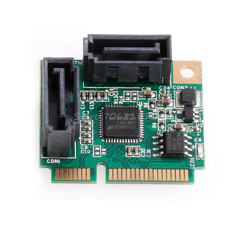

Actually what I ordered has only 2 SATA ports
Obviously based on ASM1061/ASM1062. If it looks exactly like the one I bought -- see picture below -- then due to placement of the SATA connectors you won't be able to use it on EspressoBin.
On a related note: I'm going to throw my ASM1062 into the bin soon since both SATA ports are unreliable (contact problems after maybe 10 matings each) and I get always tons of errors as soon as I attach disks there and run something demanding. That's something we should always keep in mind. We're talking about internal SATA connectors here, those are rated for 50 matings max and the cheap crap we buy on Aliexpress and eBay can't withstand even this and might fail way earlier.

Thanks @tkaiser
yeah, It's a ASM061. I don't expect much from it. My main disk already attached to the on board SATA port. Other disks which I'm going to use for backup purposes will be attached to this.
Mini-PCIe-PCI-Express-to-2-Ports-SATA-3-

On 12/20/2017 at 2:59 PM, arm-push said:
It's a ASM061.
I had this adapter working for almost half a year, now it stops the whole board from working (suppose a power issue), makes a thin hissing noise. I wouldn't recommend it, even if it cost me less than 5€... It might work longer if operated with a heat sink though.
