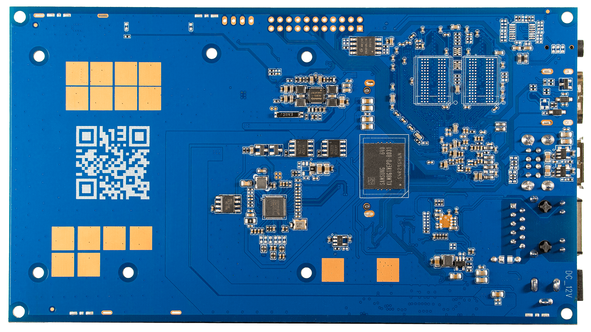

So RK805 PMIC like Rock64 and IIRC Renegade
Looks like a SPI flash (25lq128), U-boot SPL might actually live there.
Asmedia ASM1351 sata bridge
Room for more RAMS

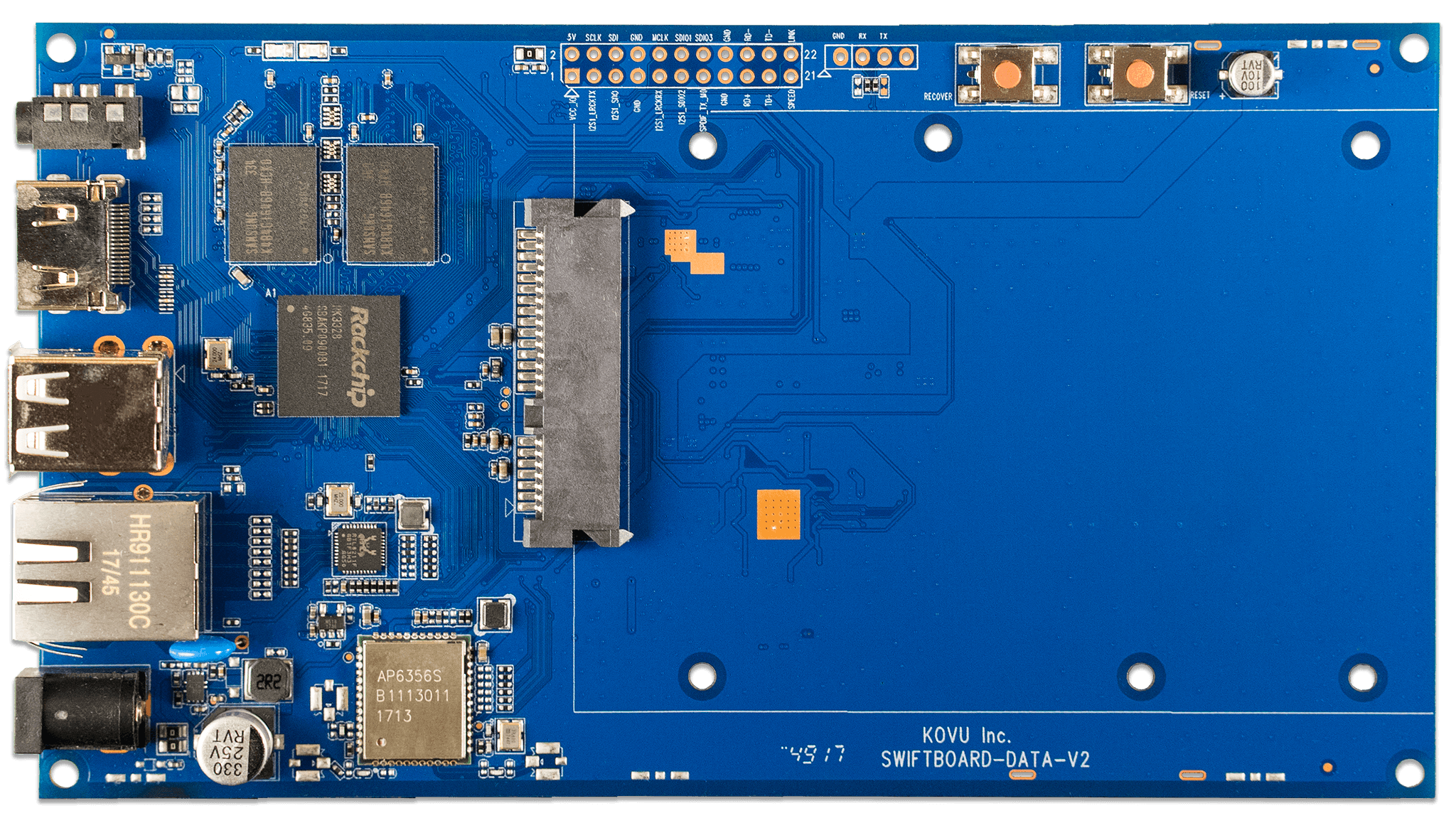

I see a button labeled "Recover" on the picture in the first post, so it is possible that this button can be used to boot into the maskrom (aka "load stuff from USB") mode.
There's a UART on one side (if all connectors look to you, it's the left). An UART-USB dongle will probably give you some information what happens during boot (and maybe you can interrupt the bootprocess) to deal with u-boot commands etc.
