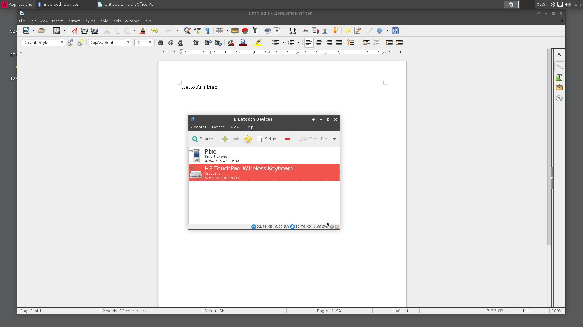

TonyMac32 Posted February 23, 2018 Posted February 23, 2018 Hello Bluetooth. Thanks @Igor for the services help, loading on boot no problem. Played some music through the board from my phone over Bluetooth, nice and smooth. 1
bedalus Posted February 23, 2018 Posted February 23, 2018 On 2/23/2018 at 3:58 AM, TonyMac32 said: Hello Bluetooth. Thanks @Igor for the services help, loading on boot no problem. Played some music through the board from my phone over Bluetooth, nice and smooth. Expand Does this improve the chances of my wireless keyboard working? It's not bluetooth exactly, it's got it's own proprietary dongle. It works on the mainline kernel, but not 4.4, even though the keyboard is ancient. I wonder if there are some kernel config options that are needed to support USB interfaces that are enabled in the mainline, but not in 4.4? I'm really looking forward to the new image, even if I have to bring my keyboard home from work to test!
TonyMac32 Posted February 23, 2018 Posted February 23, 2018 On 2/23/2018 at 7:59 PM, bedalus said: Does this improve the chances of my wireless keyboard working? It's not bluetooth exactly, it's got it's own proprietary dongle. It works on the mainline kernel, but not 4.4, even though the keyboard is ancient. I wonder if there are some kernel config options that are needed to support USB interfaces that are enabled in the mainline, but not in 4.4? I'm really looking forward to the new image, even if I have to bring my keyboard home from work to test!Are there Linux drivers for that keyboard? I feel like we talked about that before, do you have the lsusb output while it's plugged in?Sent from my Pixel using Tapatalk
