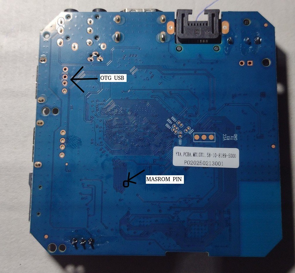

  2. Hi friends, I have good news, I found the Maskrom pin and managed to solve the problem with my MX10 box! By grounding the pin at boot time, it was able to boot from the sdcard and I used Multitools to burn a minimal Armbian image, after that it worked! My modified system, that uses the legacy kernel, only works the boot from sdcard, I tested it by burning the image and using the armbian-install command and it doesn't work! Even in maskrom mode the rkdeveloptool commands didn't work! These emcp memories are complicated, and this is 1.5Gb RAM and 8Gb of storage!
