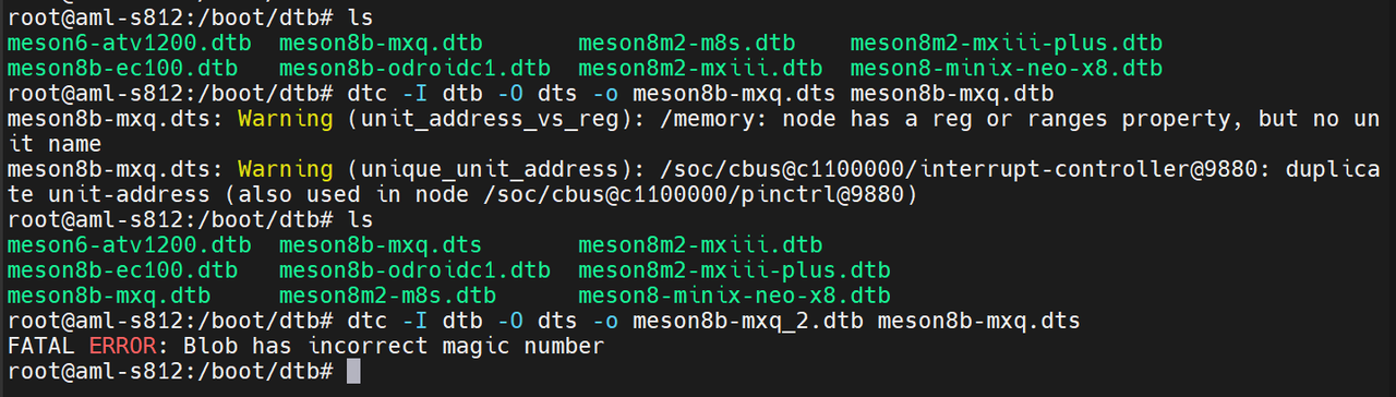

On 5/14/2022 at 12:48 AM, RaptorSDS said:
How about other dtb files from armbian 21.02.0 any other with display , its more easy to look at dtb files from same Kernel.
dtb files from 3.10.0 to 5.10 are more difference -->that why there are not compatible .
Thank you for your interest!
As you said, I tried other DTB files.
meson8b-odroidc1.dtb   The display is finally ON! But the network is dead.
meson8b-mxq.dtb   The display output is still dead. But the network works, so I can access SSH.
So I changed DTB to DTS and tried to fix it. But there's an error message like the picture below.
Can you give me some advice?
There is an error even if I don't fix the file and just do a two-way conversion.
DTB -> DTS -> DTB
Link to post
Share on other sites
vor 8 Stunden schrieb ArtSHIM:
your secound dtc string is wrong from dts to dtb
-I = input type you have dtb should  dts
-O = output type you have dts should dtb
-o = output file = ok
also odroid use realtek LAN but many HDMI CRC and HDMI i2c
ODROID C1 source file
mxq use internal(amlogic) LAN and standart HDMI output
MXQ source file
i thing your box need also the HDMI Communication CRC and i2c pins to work
Link to post
