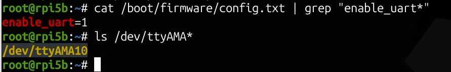

  3. Yes, I kind of reached the same conclusion, unfortunately. BTW, does it have any mode, where it would do a dry run, and tell you what it would modify? As for ttyAMA0, I don't seem to have it, even though have the UART enabled in config.txt: The priority increase seems to work, in the sense that serial now likely has the upper hand, but the system is not booting, so something is likely not working. I will try reverting the console priority.
  5. Without it being enabled in the config.txt file `ttyAMA0` isn't visible under /dev, last I checked. pibox: ~ $ cat /boot/firmware/config.txt | grep "enable_uart*" enable_uart=1 pibox: ~ $ ls /dev/ttyAMA* /dev/ttyAMA0 /dev/ttyAMA10 I wouldn't use `raspi-config` on an img that isn't RASPIOS. I feel that is bound to produce failure.
  6. Give serial priority console=tty1 console=serial0,115200
  7. Furthermore, I found the following: I used the noble xfce image from 2025-08-08 The serial console (login console, not boot console!) worked initially After the install, I did an apt-upgrade, and also used raspi-config to enable the serial console After that, the systemd console service seems to have moved from ttyAMA0 to ttyAMA10, and I am gettin no output in minicom So I have mixed feelings.

  13. Okay, I tested, but it works kind of weird: they work in tandem, but the boot messages were only output to the video console, not on the serial one. Once after the initial automatic login, the output started to go to both consoles, but the initial and systemd boot messages were only output to the video console, which would have made sharing the details of the initial problem difficult.
  14. @c0rnelius Thanks for stepping in to help. I've added enable_uart=1 to config.txt In cmdline.txt, I currently have: console=serial0,115200 console=tty1 ... Do the two settings work in tandem, or do they override each other?
