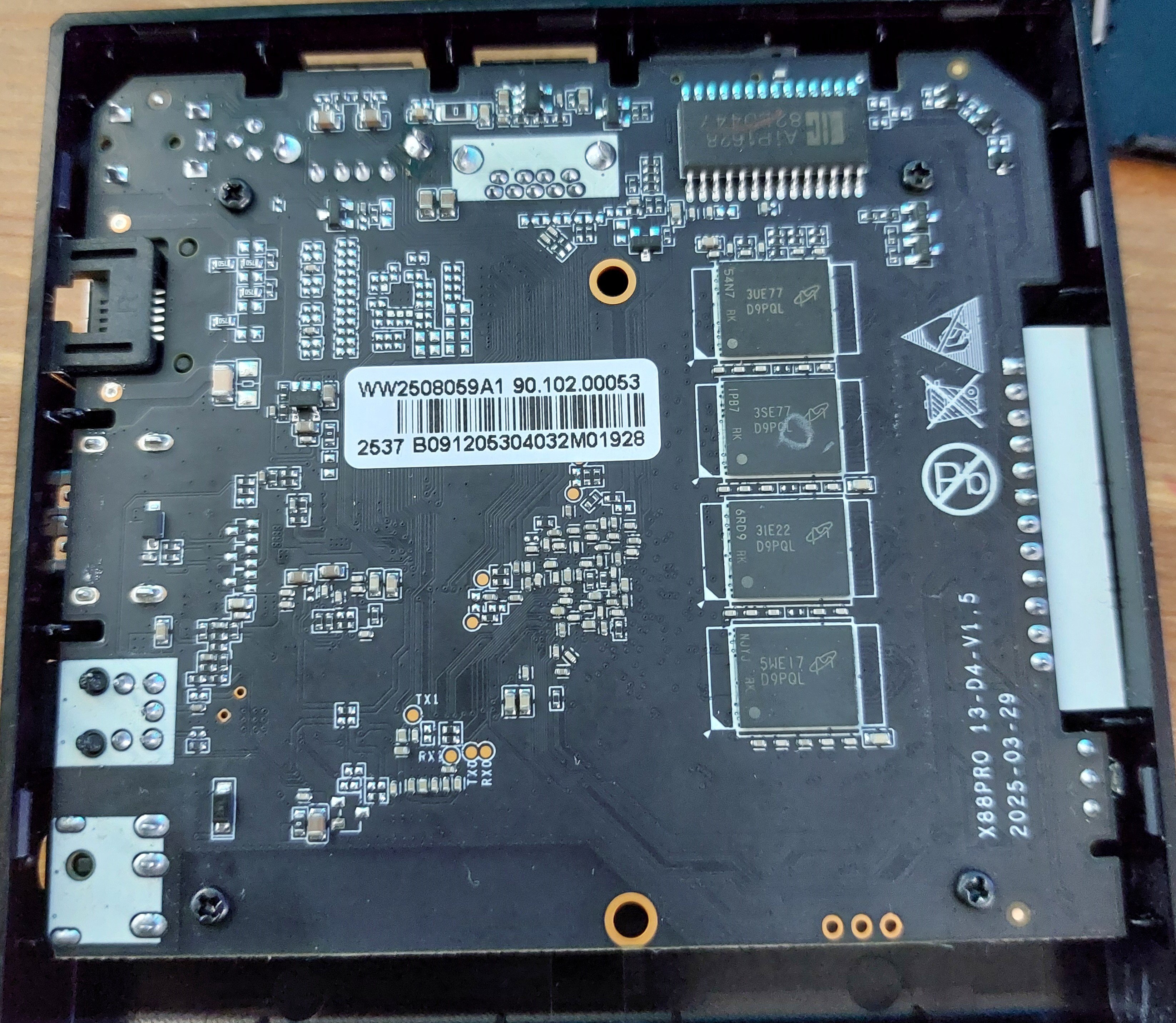

Rupa X88 Pro 13 - RK3528 board with images
Joao Cordeiro replied to fedes_gl's topic in Rockchip CPU Boxes
I see now. Mine does not have those: I suspect those are some extra functionality that the chip marked as AIP16R (on the top) has but was not implemented. The OP's board maker tought it would be nice to make them into pins in the board at the very least, while my board maker simply left them unconnected. I was not able to find the specs for that AIP16R chip. - Today
