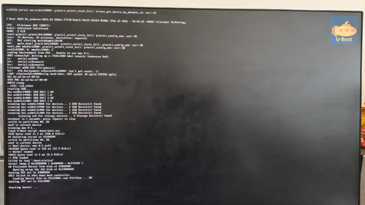

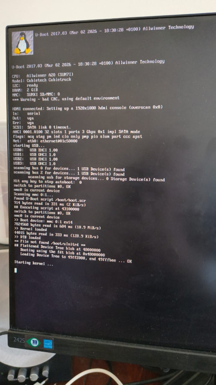

  2. Hi! Have some problem with Cubietrack Sometime boot some time not Kernel setenv fdtfile sun7i-a20-cubietruck.dtb # safe low addresses setenv kernel_addr_r 0x42000000 setenv fdt_addr_r 0x43000000 setenv ramdisk_addr_r 0x44000000 # limit relocations setenv fdt_high 0x47f00000 setenv initrd_high 0x47f00000 mmc dev 0 mmc rescan setenv bootargs "console=ttyS0,115200 console=tty0 ignore_loglevel loglevel=8 \ root=/dev/mmcblk0p1 rootwait rootfstype=ext4 rw \ panic=10 consoleblank=0 net.ifnames=0 biosdevname=0 enforcing=0 \ nosmp mem=1024M clk_ignore_unused" echo ">> Boot device: mmc 0:1 ext4" if ext4load mmc 0:1 ${kernel_addr_r} /boot/zImage; then echo ">> Kernel loaded" else echo "### ERROR: /boot/zImage not found" reset fi if ext4load mmc 0:1 ${fdt_addr_r} /boot/dtb/${fdtfile}; then echo ">> DTB loaded" else echo "### ERROR: dtb not found" reset fi setenv initrd_arg "-" if ext4load mmc 0:1 ${ramdisk_addr_r} /boot/uInitrd; then setenv initrd_arg ${ramdisk_addr_r} fi bootz ${kernel_addr_r} ${initrd_arg} ${fdt_addr_r} root@volumio:~# cd /boot root@volumio:/boot# ls -all total 35200 drwxr-xr-x 7 root root 4096 Mar 4 11:44 . drwxr-xr-x 23 root root 4096 Mar 4 09:17 .. drwxr-xr-x 2 root root 4096 Feb 28 2016 bin -rw-r--r-- 1 root root 966 Mar 4 12:04 boot.cmd -rw-r--r-- 1 root root 1038 Mar 4 12:04 boot.scr -rw-r--r-- 1 root root 101188 Jan 22 2017 config-4.4.44 -rw-r--r-- 1 root root 101262 Apr 24 2016 config-4.4.8 -rw-r--r-- 1 root root 133815 Mar 21 2019 config-5.0.2-sunxi -rw-r--r-- 1 root root 159559 Mar 1 17:03 config-6.6.75-legacy-sunxi drwxr-xr-x 2 root root 4096 Mar 4 09:16 dtb drwxr-xr-x 3 root root 12288 Sep 12 2019 dtb-5.0.2-sunxi drwxr-xr-x 3 root root 12288 Feb 7 18:41 dtb-6.6.75-legacy-sunxi drwxr-xr-x 2 root root 4096 Feb 28 2016 dtb.old -rw-r--r-- 1 root root 0 Mar 3 17:32 .next lrwxrwxrwx 1 root root 24 Mar 3 16:54 script.bin -> /boot/bin/cubietruck.bin -rw------- 1 root root 1464739 Jan 22 2017 System.map-4.4.44 -rw------- 1 root root 1460350 Apr 24 2016 System.map-4.4.8 -rw-r--r-- 1 root root 2376380 Mar 21 2019 System.map-5.0.2-sunxi -rw-r--r-- 1 root root 2957247 Mar 1 17:03 System.map-6.6.75-legacy-sunxi -rw------- 1 root root 3384008 Jan 22 2017 vmlinuz-4.4.44 -rw------- 1 root root 3367664 Apr 24 2016 vmlinuz-4.4.8 -rwxr-xr-x 1 root root 4810496 Mar 21 2019 vmlinuz-5.0.2-sunxi -rw-r--r-- 1 root root 7824568 Mar 1 17:03 vmlinuz-6.6.75-legacy-sunxi -rw-r--r-- 1 root root 7824568 Mar 4 09:16 zImage root@volumio:/boot# uname -a Linux volumio 6.6.75-legacy-sunxi #3 SMP PREEMPT Sat Feb 1 17:37:57 UTC 2025 armv7l GNU/Linux root@volumio:/boot#
