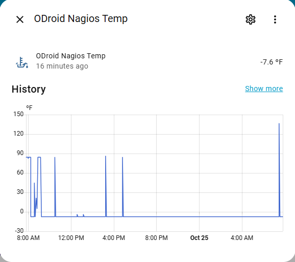

I recently noticed my ODroid XU4 was reporting weird temperature readings: cat /sys/class/thermal/thermal_zone0/temp -22000 Is this a software issue or maybe hardware failing? Also, I would like to upgrade, is there another board I could just transfer my EMMC to and be up and running? Thanks
