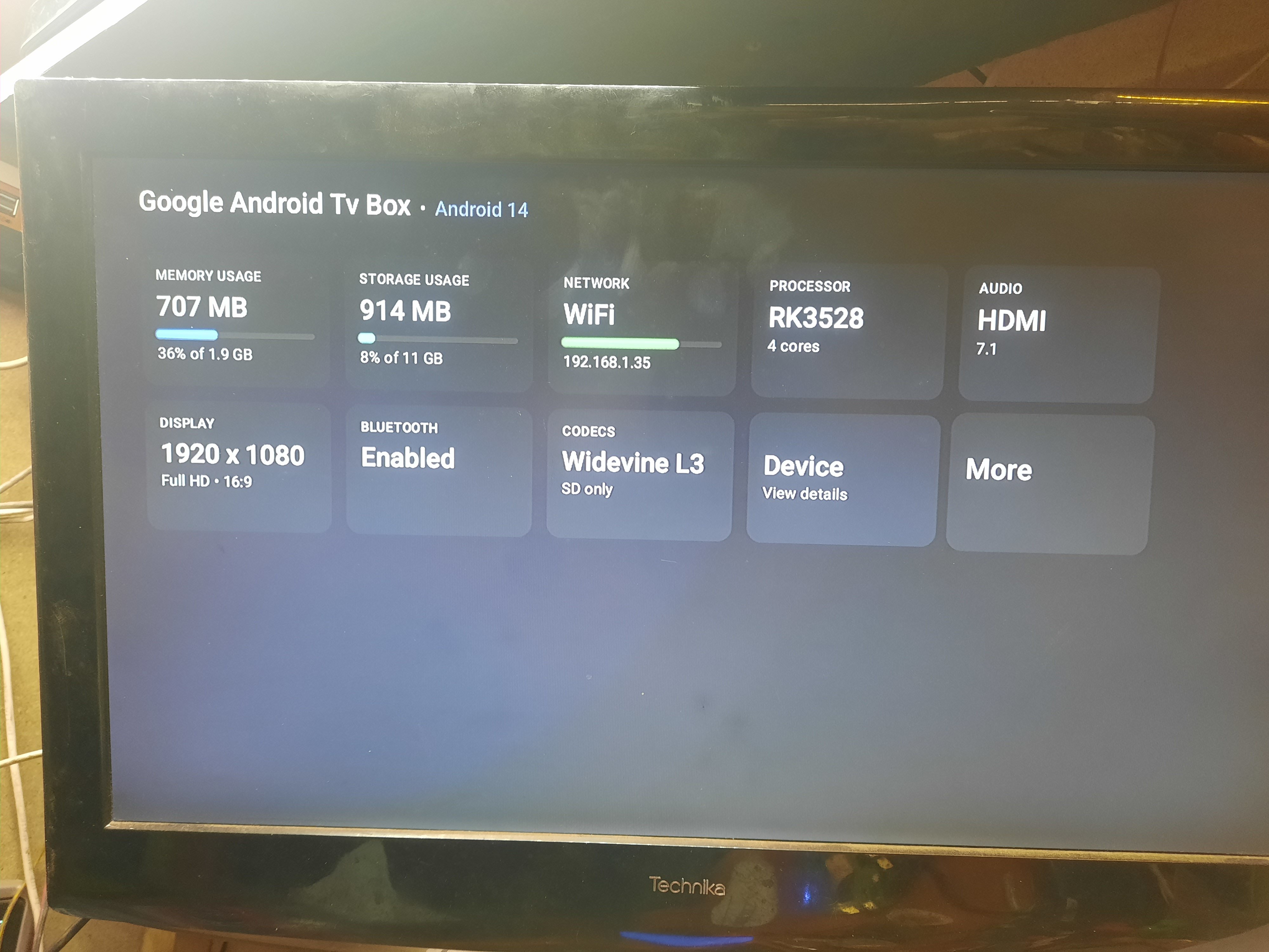

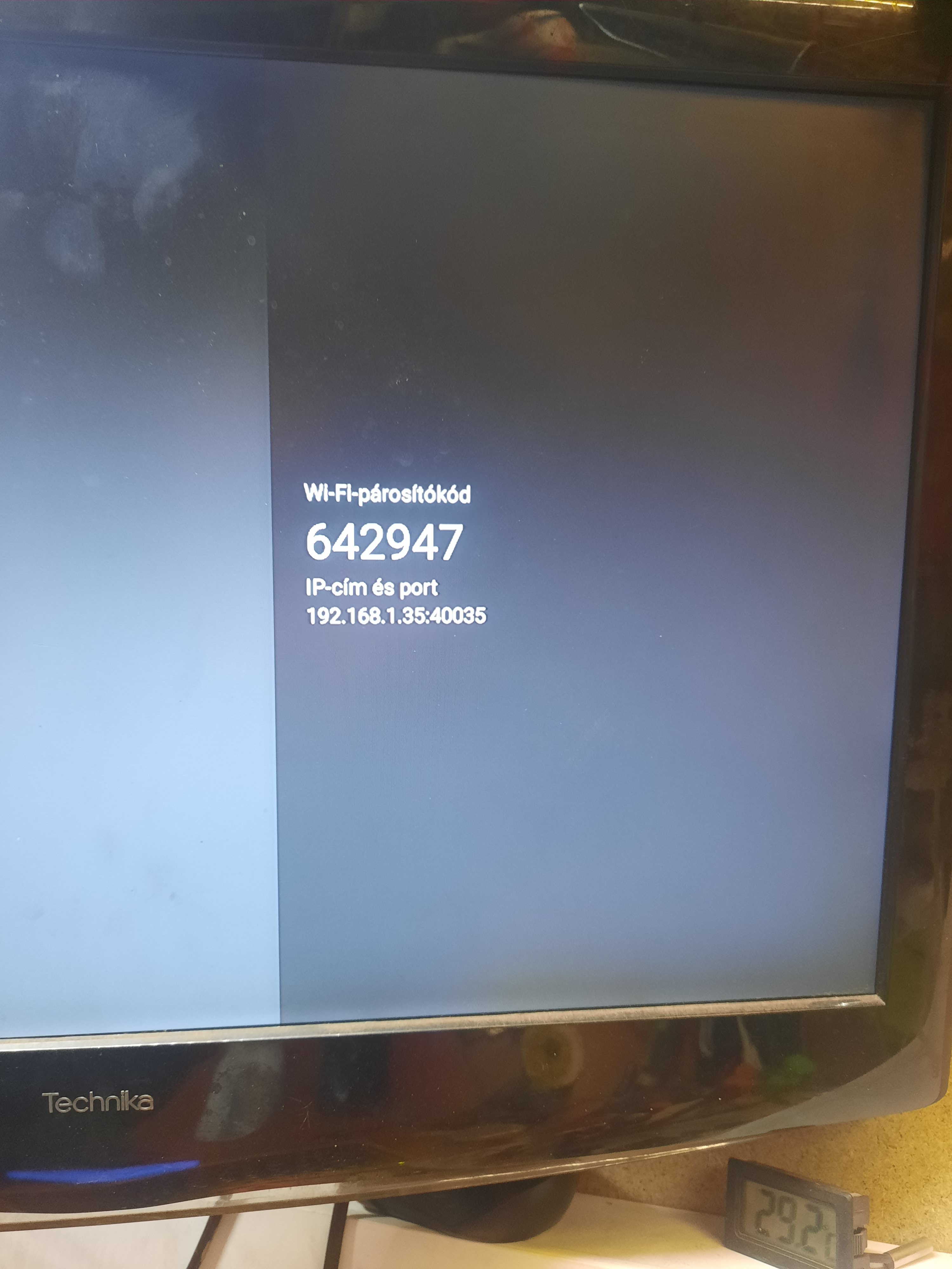

Hi, I need help with flashing my tv box or installing it on linux. I would also be happy if you could run an armbian or similar minimal system. I would like to run a website on it at home. I already did it for an old venz v10 for a friend and installed armbian on it and he really liked it, but my couldn't install it with a memory card, the on new box 1. System Information Google Android Tv Box - Android 14 Android Version: 14 (Upside Down Cake) API Level: 34 Android Security Patch Level: 2025-01-01 Rooted Device: No Android ID: 5c4aa62950194797 Build ID: rk3528_box_32-userdebug 14 UTT2.241219.001 eng.hxws.20260124.163421 release-keys Codename: REL Fingerprint: google/blueline/blueline:14/UTT2.241219.001/eng.hxws.20260124.163421:userdebug/release-keys ID: UTT2.241219.001 Incremental: eng.hxws.20260124.163421 Java Runtime Version: Android Runtime 0.9 Java Virtual Machine Version: ART 2.1.0 Java Virtual Machine Heap Size: 128 MB Kernel Architecture: armv7l Kernel Version: 6.1.118 (hxws@PowerEdge-R720-8) (Android 10087095, +pgo, +bolt, +lto, -mlgo, based on clang 17.0.2 of r487747c (https://android.googlesource.com/toolchain/llvm-project d9f89f4d16663d5012e5c09495f3b30ece3d2362), LLD 17.0.2) #124 SMP PREEMPT Wed Jan 21 10:25:12 CST 2026 Tags: release-keys Type: userdebug Google Play Services Version: < None > Huawei Mobile Services Version: OpenSSL 1.1.1 (compatible; BoringSSL) OpenSSL Version: 1.2.13 ZLib Version: 1.2.13 2. Hardware and Processor (CPU/Device) Device Type: TV Manufacturer: Google Model: android_tv_box Brand: google Motherboard: RK3528 Device: blueline Hardware: rk30board Platform: rk3528 Product: blueline Processor: RK3528, 4 cores SoC Model: RockChip RK3528 Core Architecture: 4x ARM Cortex-A53 @ 2016 MHz Instruction Set: 64-bit ARMv8-A (32-bit mode) CPU Version: r0p4 CPU Cores: 4 CPU Clock Range: 408 - 2016 MHz CPU Utilization: 5% Scaler Controller: Interactive Supported ABIs: armeabi-v7a, armeabi Supported 32-bit ABIs: armeabi-v7a, armeabi AES/ASIMD/NEON/PMULL/SHA1/SHA2: Supported 3. Memory and Storage (RAM/Storage) Installed RAM: 2 GB Total Memory: 1920 MB Available Memory: 1221 MB Memory Used: 707 MB (36% of 1.9 GB) Total Internal Storage: 11.00 GB Free Internal storage: 10.11 GB Storage usage: 914 MB (8% of 11 GB) 4. Display and GPU (Display) Display: 1920 x 1080 (Full HD, 16:9) Screen resolution: 1920 x 1080 xdpi / ydpi: 320 / 320 dpi GPU manufacturer: ARM GPU renderer: Mali-450 MP Refresh rate: 60 Hz Default orientation: Landscape OpenGL ES version: 2.0 GPU version: OpenGL ES 2.0 OpenGL ES extensions: (List: GL_EXT_debug_marker, GL_OES_texture_npot, GL_OES_vertex_array_object, GL_OES_compressed_ETC1_RGB8_texture, GL_EXT_compressed_ETC1_RGB8_sub_texture, GL_OES_standard_derivatives, GL_OES_EGL_image, GL_OES_depth24, GL_ARM_rgba8, GL_ARM_mali_shader_binary, GL_OES_depth_texture, GL_OES_packed_depth_stencil, GL_EXT_texture_format_BGRA8888, GL_OES_vertex_half_float, GL_EXT_blend_minmax, GL_OES_EGL_image_external, GL_OES_EGL_sync, GL_OES_rgb8_rgba8, GL_EXT_discards_framebuffer, GL_OES_get_program_binary, GL_ARM_mali_program_binary, GL_EXT_shader_texture_lod) 5. Network and Connections (Network/Bluetooth/USB) Network: WiFi Telephony: None Wi-Fi Status: Enabled SSID: BSSID: 02:00:00:00:00:00 Hidden SSID: No IPv4 Address: 192.168.1.35 IPv6 Address: fe80::5ef3:83b1:27d0:574a Signal Strength: -46 dBm (Excellent) Link Speed: 54 Mbps Frequency: 2427 MHz Gateway: 192.168.1.254 Netmask: 255.255.255.0 DNS1: 192.168.1.254 DHCP Lease Time: 24 hours 5 GHz Band: Supported Wi-Fi Aware: Not Supported Wi-Fi Direct: Supported Bluetooth: Enabled Bluetooth Version: 4+ USB Device - Linux 6.1.118 ehci_hcd EHCI Host Controller: (Serial Number: ff100000.usb, ID: 1D6B-0002, Class: 09/00, Speed: 480 Mbps) USB Device - Linux 6.1.118 xhci_hcd xHCI Host Controller: (Serial Number: xhci-hcd.4.auto, ID: 1D6B-0002, Class: 09/00, Speed: 480 Mbps) USB Device - YICHIP Wireless Device 6. Other Data Audio: HDMI 7.1 Codecs: Widevine L3 (SD only) Wireless Debugging: Enabled IP Address and Port: 192.168.1.35:40729 Wi-Fi pairing code: 642947 IP address and port (for pairing): 192.168.1.35:40035 Device features: (List: android.hardware.audio.output, android.hardware.bluetooth, android.hardware.bluetooth_le, android.hardware.camera, android.hardware.camera.any, android.hardware.camera.external, android.hardware.camera.front, android.hardware.cetherandroid.hdware.mi android.hardware.keystore.app_attest_key, android.hardware.location, android.hardware.location.network)
