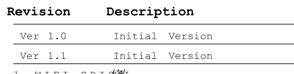

Looks like the same thing REV 1.1 uses. My guess would be the GPIO or PINCTRL may be different on the REV2. The problem is the schematic only shows 1.0 / 1.1 You could try shooting them an email in an attempt to obtain the v2 schematic? Without it, you would just be guessing. -
