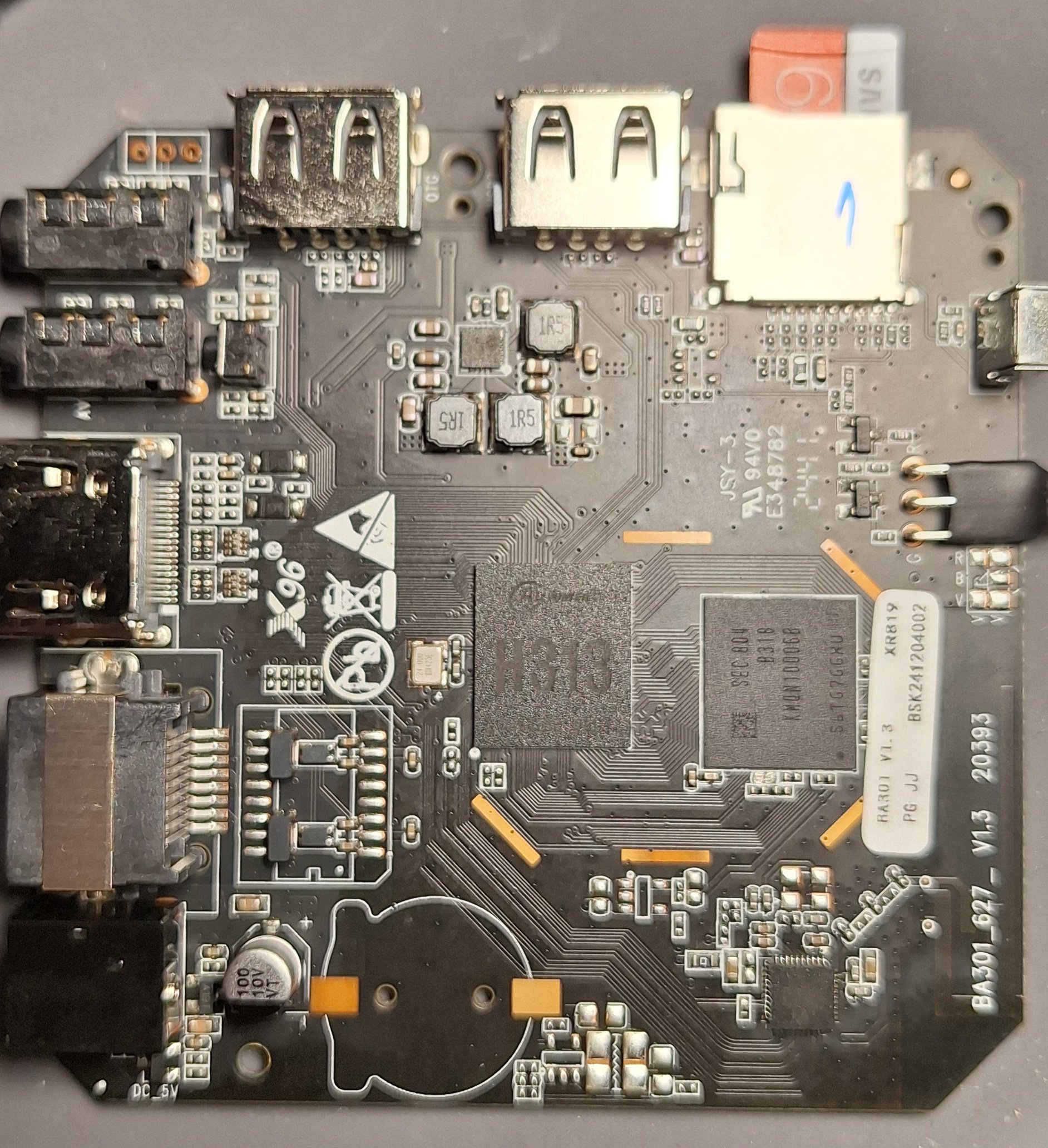

Hello I having an issue to run armbian on tv box x96q with h313 board version is 5.1. I found sicXnull guide and made img using standart ./compile.sh. Choosing minimal server, no kernel mods and x96q board. Flash it to sd via balena etcher. Plug in sd without power, holding reset for 5, 10 and 15 sec while plug in power. Nothing happening on the screen or with box itself Then after some research i found this image from same guy but its decktop ver and its worked just fine. https://github.com/sicXnull/armbian-build/releases name Armbian-unofficial_24.11.0-trunk_X96q-v5-1_bookworm_current_6.6.44_mate_desktop.img.xz I spot some differense in dtb files folder Decktop version have a sun50i-h313-x96q-ddr3-v5.1.dtb file but mine server ver dont. Can it be the issue?

Try compiling this version from https://github.com/sicXnull/armbian-build/tree/X96Q-TVBOX-LPDDR3 git clone https://github.com/sicXnull/armbian-build.git --branch=X96Q-TVBOX-LPDDR3 cd armbian-build ./compile.sh choose "Show CSC/WIP/EOS/TVB" Select "x96q-v1-3"
Try my latest images maybe they will work for you https://github.com/NickAlilovic/build/releases/tag/20250306

Just tried booting with a SD card made using instructions from page 2 of this thread. Just boots into normal Android OS Tried using a toothpick in the audio port, just get a black screen Any advice on how to get the box to boot from SD card?

Some basic information would be very helpful. What image are you using (exact file name for the image please). What install steps did you perform? Can you include a screen shot/picture of what exactly you are seeing on screen? A capture of the boot log (either via uart or pictures of what is on screen can be helpful too).
