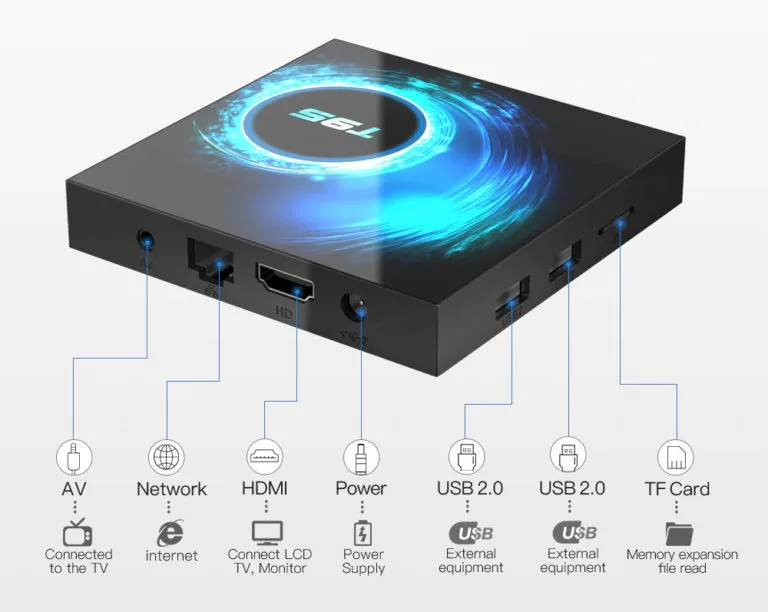

shacodelico Posted December 27, 2020 Share Posted December 27, 2020 hi balbes, does anyone know if there is armbian system for allwinner h616? this is my tv box 0 Quote Link to comment Share on other sites More sharing options...
Werner Posted December 27, 2020 Share Posted December 27, 2020 Support for the H616 SoC is to be considered experimental at most. 0 Quote Link to comment Share on other sites More sharing options...
shacodelico Posted December 28, 2020 Author Share Posted December 28, 2020 the orange pi zero 2 has almost the same hardware, should the orange pi systems work on my tv box or am I wrong? 0 Quote Link to comment Share on other sites More sharing options...
Werner Posted December 28, 2020 Share Posted December 28, 2020 Give it a try but as stated basically nothing but booting and ethernet works. not even USB can be used at this time. Dont expect any support in this case. https://www.armbian.com/orange-pi-zero-2/ 1 Quote Link to comment Share on other sites More sharing options...
jernej Posted December 29, 2020 Share Posted December 29, 2020 T95 needs different configuration of DRAM driver. Quick and dirty T95 U-Boot port with appropriate defconfig can be found here: https://github.com/jernejsk/u-boot/commits/t95 2 Quote Link to comment Share on other sites More sharing options...
