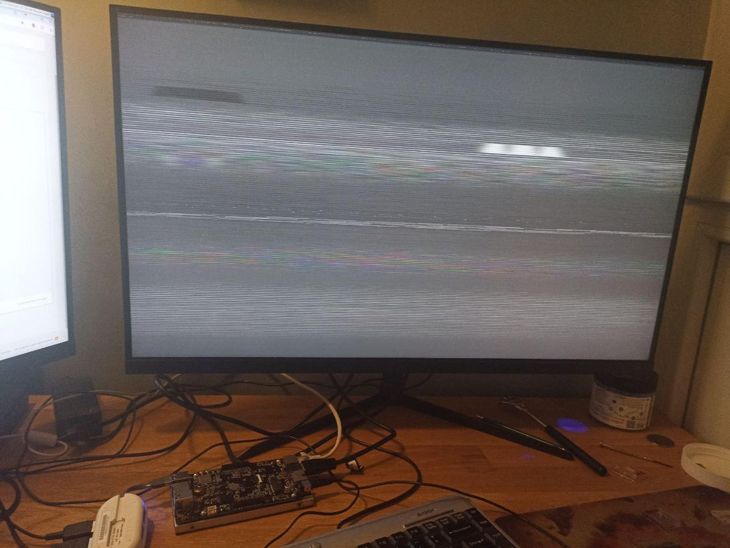

smatsak Posted January 14, 2023 Share Posted January 14, 2023 (edited) Hi FireFly station P2 on Armbian 22.11 Bullseye XFCE does not work on a 4K monitor. When turned on, ripples appear on the screen. Examples of images from links. The same problem at station M2. station m2 and station p2 do not work on a 4k monitor both Edited January 14, 2023 by smatsak typos and inaccuracies in my message 0 Quote Link to comment Share on other sites More sharing options...
Myron Posted January 14, 2023 Share Posted January 14, 2023 Provide diagnostic logs with ... armbianmonitor -u ... and post the link here. It'll may help others determine what the issue is. 0 Quote Link to comment Share on other sites More sharing options...
smatsak Posted January 14, 2023 Author Share Posted January 14, 2023 I have two monitors and both are 4K, there are no others, if I don't see what is displayed on the screen, how can I execute the command you specified? 0 Quote Link to comment Share on other sites More sharing options...

smatsak Posted January 15, 2023 Author Share Posted January 15, 2023 13 часов назад, Myron сказал: Provide diagnostic logs with ... armbianmonitor -u ... and post the link here. It'll may help others determine what the issue is. root@station-p2:~# armbianmonitor -u System diagnosis information will now be uploaded to https://paste.armbian.com/togakopafo Please post the URL in the forum where you've been asked for. https://paste.armbian.com/togakopafo is that all? 0 Quote Link to comment Share on other sites More sharing options...
smatsak Posted January 15, 2023 Author Share Posted January 15, 2023 And this is a link for a similar problem on m2 root@station-m2:~# armbianmonitor -u System diagnosis information will now be uploaded to https://paste.armbian.com/juyobokico Please post the URL in the forum where you've been asked for. 0 Quote Link to comment Share on other sites More sharing options...
