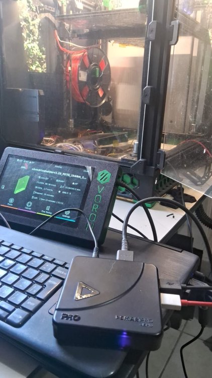

Up! I've forgot device in drawer until now, when my klipper host minipc died.. Got Klipper with CAN and Klipperscreen working great to run my Voron Trident. Awesome work guys, thanks again!
Just so I don't forget. To be able to get it working currently I have to do this. Yeah yeah, hate me all you want, I don't know this shit Your SD-card will be fried and wanna give up after this many shitty writes. I always wonder why everyone decided sd-cards were a good idea... Flash with a known good image. Example Luckfoxs own or this from platima (https://github.com/platima/SBC-Images/tree/main/Luckfox/Lyra/Lyra Zero W) verify it with sudo fdisk -l /dev/sdX and it should look like this Device Start End Sectors Size Type /dev/sdg1 8192 16383 8192 4M Linux filesystem /dev/sdg2 16384 40959 24576 12M Linux filesystem /dev/sdg3 65536 2037759 1972224 963M Linux filesystem build your own img. sudo losetup -fP --show armbian.img Open gparted and delete the sdg3 and create a new partition to like 4-6GiB so we are able to write to the partition free space before should be 12MiB Then write to the /dev/sdX3 partition (Make sure you are pointing to the right device so you don't overwrite your USB drive with all the important photos on it ) sudo dd if=/dev/loopXp1 of=/dev/sdX3 bs=4M status=progress Plug that sd-card in and hook up an serial connection and boot it and it will boot up in and you should have this in about 5 mins _ _ _ __ __ _ _ _ /_\ _ _ _ __ | |__(_)__ _ _ _ ___ _ _ _ _ ___ / _|/ _(_)__(_)__ _| | / _ \| '_| ' \| '_ \ / _` | ' \___| || | ' \/ _ \ _| _| / _| / _` | | /_/ \_\_| |_|_|_|_.__/_\__,_|_||_| \_,_|_||_\___/_| |_| |_\__|_\__,_|_| v25.11 rolling for Luckfox Lyra Zero W running Armbian Linux 6.1.99 Packages: Debian stable (bookworm), possible distro upgrade (trixie) Updates: Kernel upgrade enabled and 1 package available for upgrade Support: DIY (custom image) sed: -e expression #1, char 0: no previous regular expression Performance: Load: 49% Uptime: 2 min Memory usage: 7% of 467M CPU temp: 36°C Usage of /: 6% of 29G Commands: Configuration : armbian-config Upgrade : armbian-upgrade Monitoring : htop
