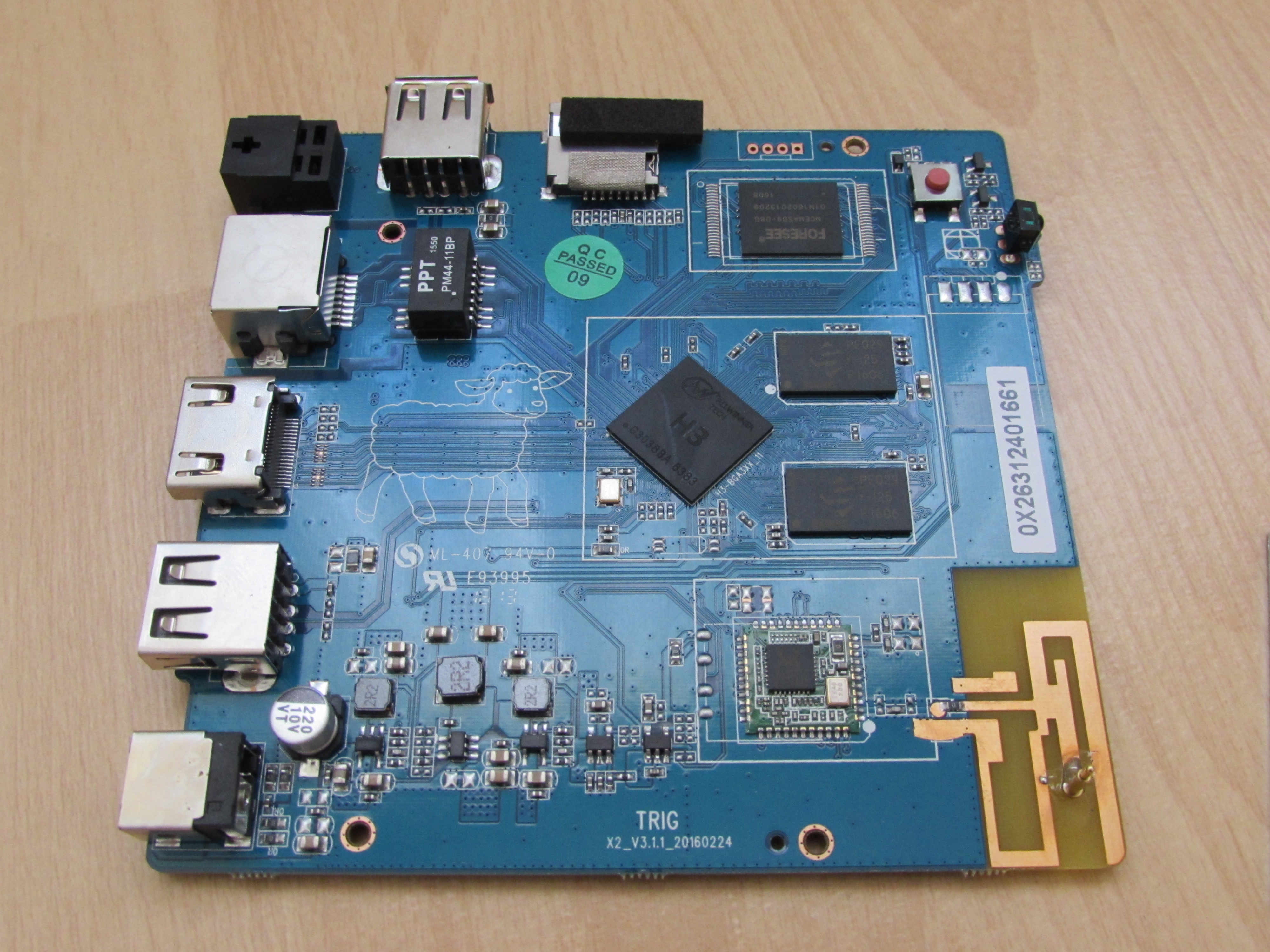

That means a new hardware revision is out since the older Beelink X2 are equipped with AP6181: http://linux-sunxi.org/images/1/19/X2_PCB_top.jpg(the device I have also has AP6181 but different DRAM modules compared to the wiki picture)
Did you check which hardware revision you have?
here you are the inside pictures of my Beelink X2
https://raspberryparatorpes.net/img_4155/
https://raspberryparatorpes.net/img_4156/
Thanks and I hope this can help.
Link to post
Share on other sites

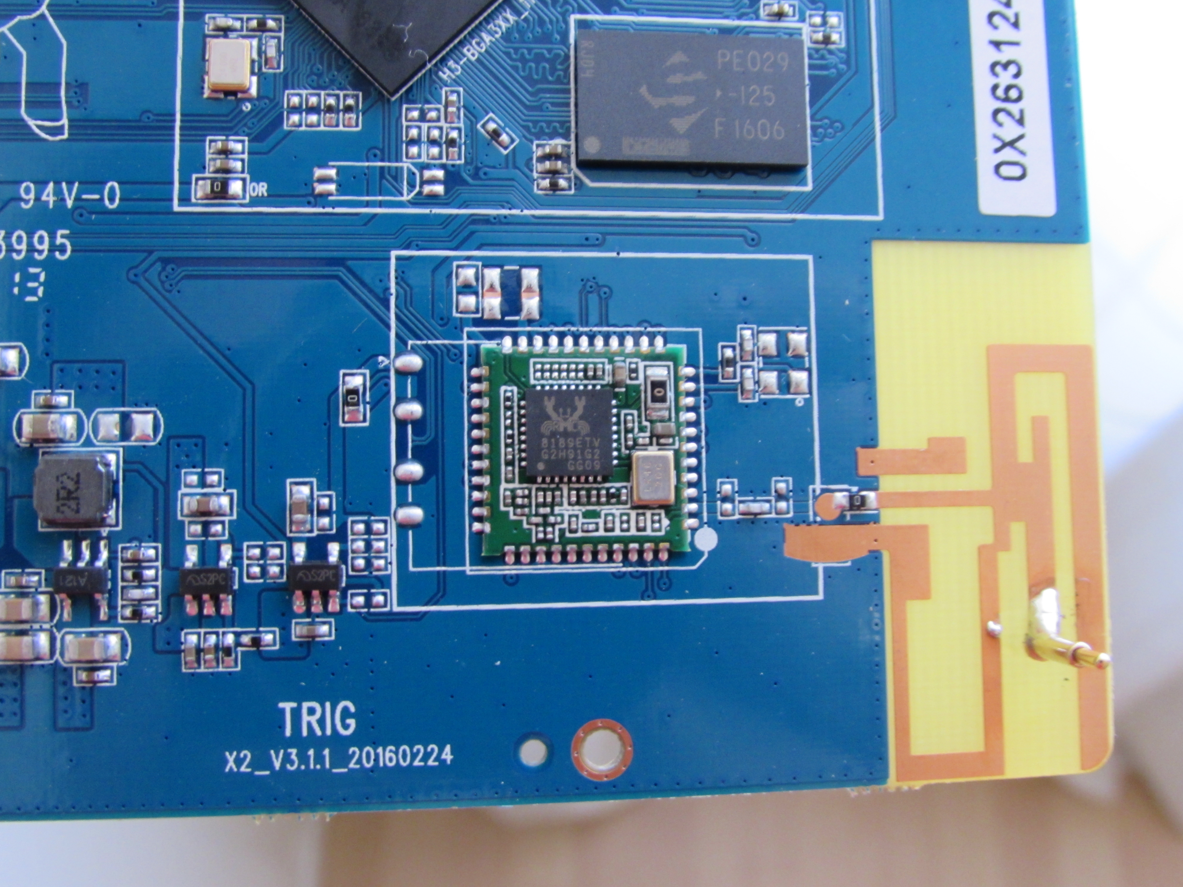

Yeah, manuti and i, have different version of box (the newer one), to be exactly: x2_v3.1.1_20160224.
I upload some photos of the box. The Wi-Fi chip is Realtek 8189ETV
https://drive.google.com/open?id=0BwvVdWyZVml1NVRLaDcxckY2NDQ

Indeed there are two different hardware versions. I have a total of three units of Beelink X2. The first two with serial numbers: X2H3CKFH1D054 and X2H3CKFH80684 have wifi chip that uses the brcmdhd driver. My newest third unit with serialnumber: A2H3CKHH71819 has wifi chip using the 8189es driver.
There is no externally visible indication of HW version other than the serial number. I have not opened my units to have a look inside.

Regarding wifi on the newer version of Beelink X2 with the Realtek 8189ETV chip I manage to get it working (including wpa2) as follows:
Upon boot the 8189es driver is loaded and can be seen with lsmod. For some reason there is no wifi interface wlan(x).
For me it is sufficient to just do:
rmmod 8189es
modprobe 8189es
Then I have the interface wlan3 and can configure it. See logfile for details:
I confirm, A2 on the beginning inform of the 8189ETV chip inside, my serial number is A2H3CKHH7xxxx and also has 8189ETV
