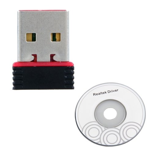

Werner Posted August 1, 2018 Author Posted August 1, 2018 Aight, finally I received the ordered MT7601U USB WiFi dongle. Unfortunately I cannot get it to work. It seems like the information about this device are wrong. [ 2648.350845] usb 3-1: USB disconnect, device number 5 [ 2652.317212] usb 3-1: new high-speed USB device number 6 using ehci-platform [ 2652.446030] usb 3-1: New USB device found, idVendor=0bda, idProduct=f179, bcdDevice= 0.00 [ 2652.446038] usb 3-1: New USB device strings: Mfr=1, Product=2, SerialNumber=3 [ 2652.446042] usb 3-1: Product: 802.11n [ 2652.446047] usb 3-1: Manufacturer: Realtek [ 2652.446052] usb 3-1: SerialNumber: 00E0242D387E Some research showed that f179 is the code for the RTL8188FTV wireless chip and when connected under MS Windows it shows up as Realtek RTL8188FTV W-LAN 802.11n USB 2.0-network card I could not find any useful information running this dongle under Linux. Anyone got an idea?
tkaiser Posted August 1, 2018 Posted August 1, 2018 7 minutes ago, Werner said: finally I received the ordered MT7601U USB WiFi dongle So you got the recommendation to buy a RealTek RTL8811AU based dongle (since supported by Armbian according to @Igor), decided to ignore this trying to buy a MT7601U thingy instead that is based on (unsupported) RTL8188FTV and are now complaining that you do not get this thing to work. Why exactly?
Werner Posted August 1, 2018 Author Posted August 1, 2018 Because it is listed as tested 3rd party hardware on this website: https://www.armbian.com/orange-pi-one-plus/ Also I placed my order right before the recommendation from @Igor showed up.
tkaiser Posted August 1, 2018 Posted August 1, 2018 Well, given you have no network right now it will be quite hard trying to compile a driver for the RTL8188. Otherwise next step would be https://docs.armbian.com/User-Guide_Advanced-Features/#how-to-build-a-wireless-driver My personal choice in such situations is an RTL8153 based GbE dongle since IMO one can make use of such a thing many times and it performs on USB3 ports not that much different compared to 'native' Gigabit Ethernet. On USB2 ports performance is still good.

Werner Posted August 7, 2018 Author Posted August 7, 2018 Alright. I tested a few drivers I found for RTL8188xxx (I could not find a driver especially for this chip) devices but none was working for the RTL8188FTV chip. I will wait until my RTL8153 Ethernet adapter arrives and will use this one. I recommend to remove the device from the list of "tested 3rd party hardware" ASAP. As stated this WiFi dongle comes with the unsupported RTL8188FTV chip and NOT as promised with the MT7601U chip. I also reported this false advertisement to Amazon as well as the seller.
tkaiser Posted August 7, 2018 Posted August 7, 2018 26 minutes ago, Werner said: As stated this WiFi dongle comes with the unsupported RTL8188FTV chip and NOT as promised with the MT7601U chip Well, the seller is somewhat honest, isn't he? That's from 'our' affiliate link: But I second that. I never understood why @Igor added affiliate links to crappy hardware on the download pages.
